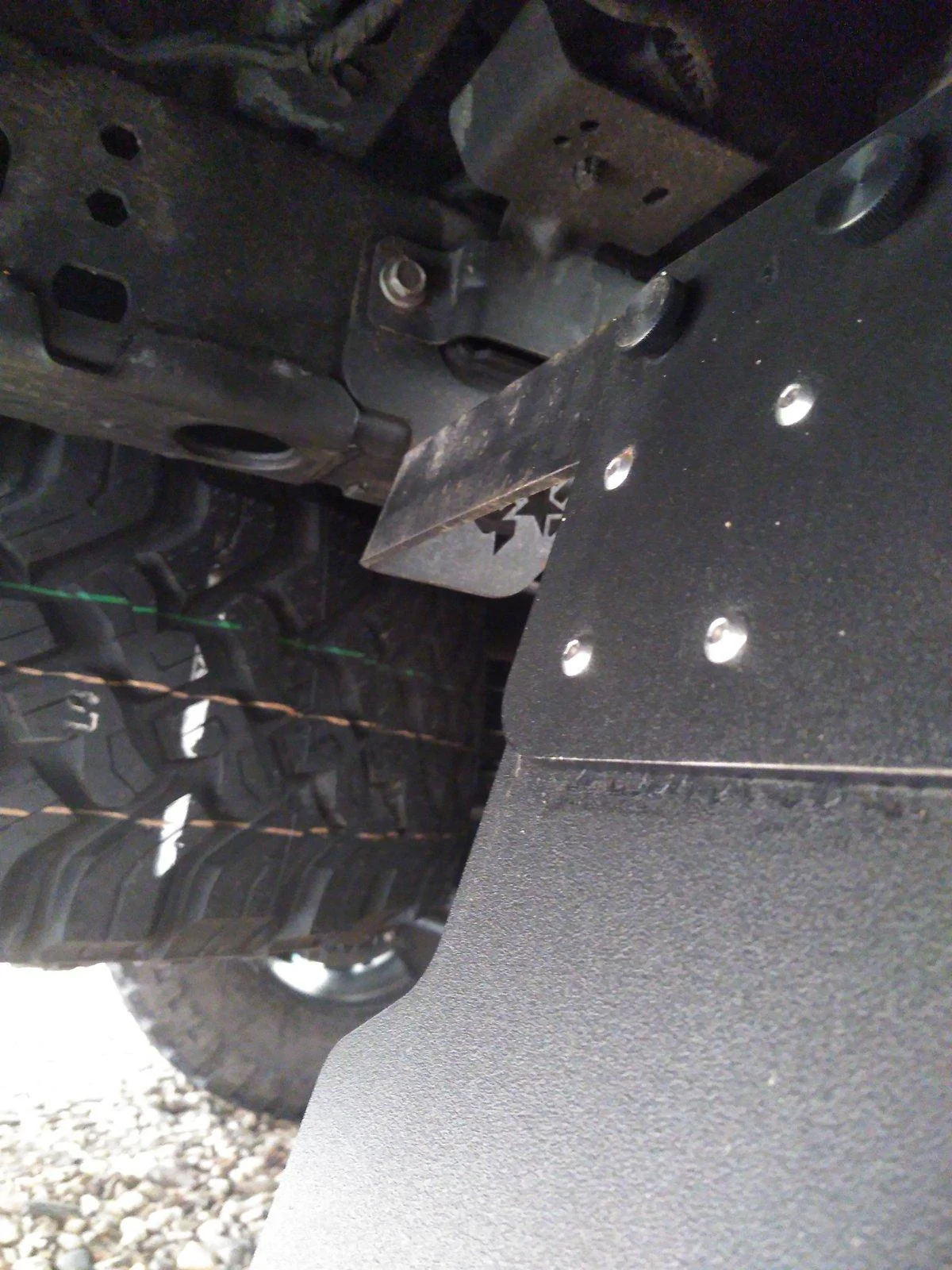

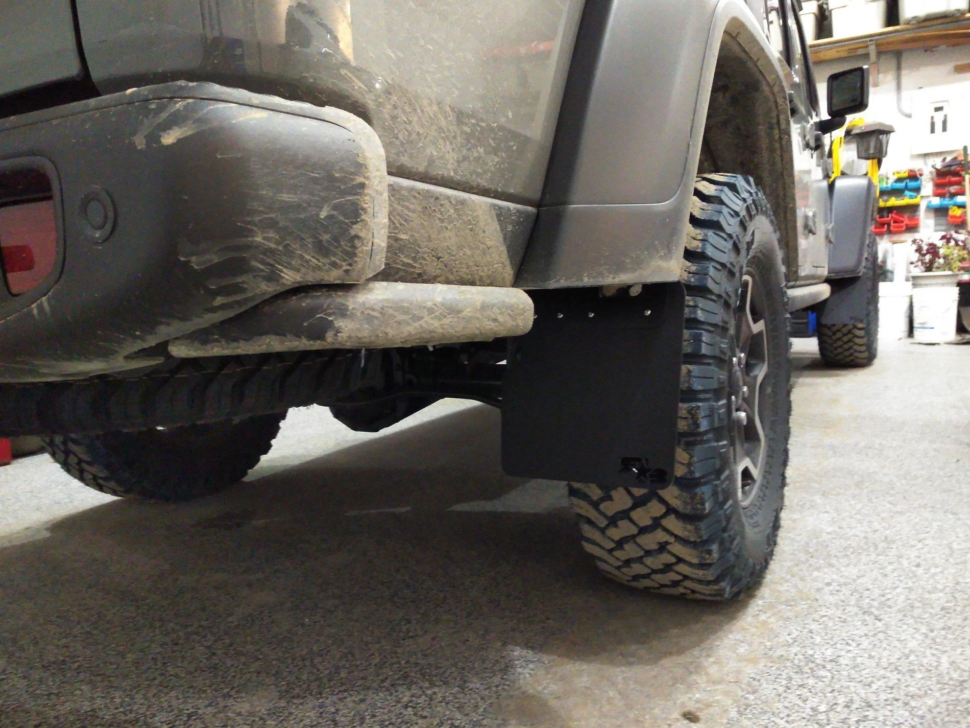

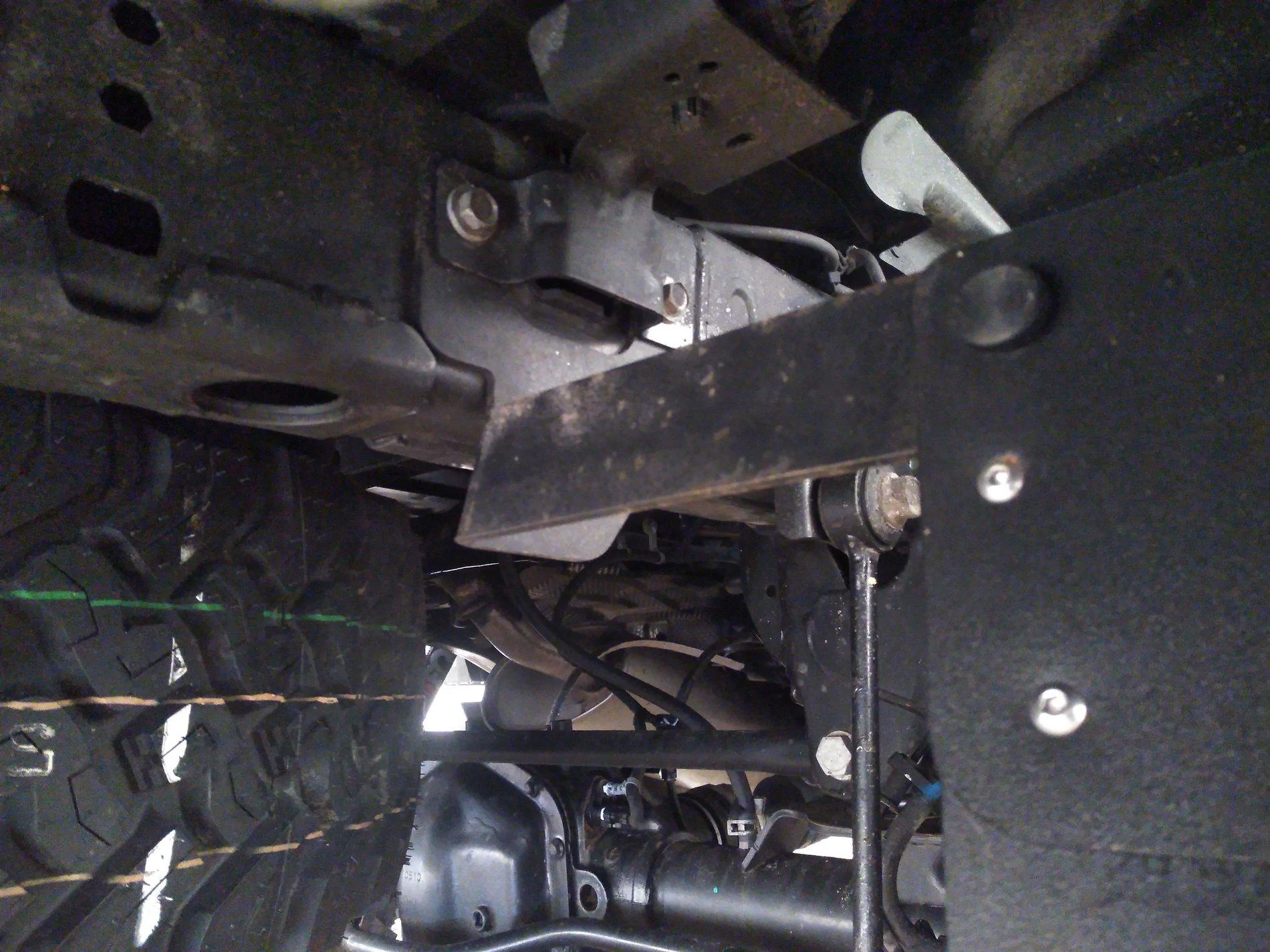

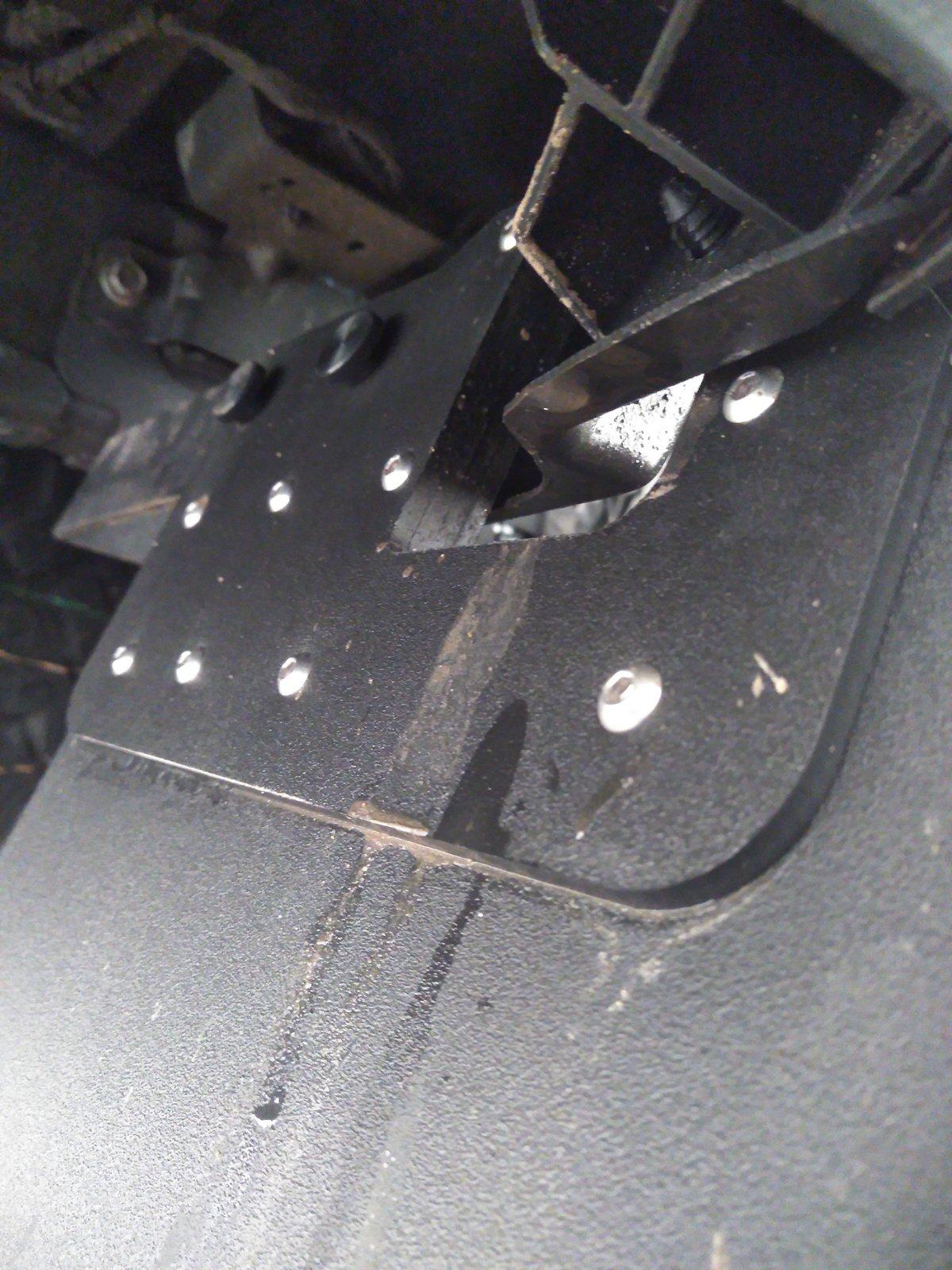

Got both sets installed tonight, was really easy and fast once I had the rear flaps assembled ready to attach to the included brackets.
Will see how they help with the road spray...have a bunch on it from before I got the mud flaps installed. I think the most road spray comes from the front but notice a fair bit on the back around the bumper.

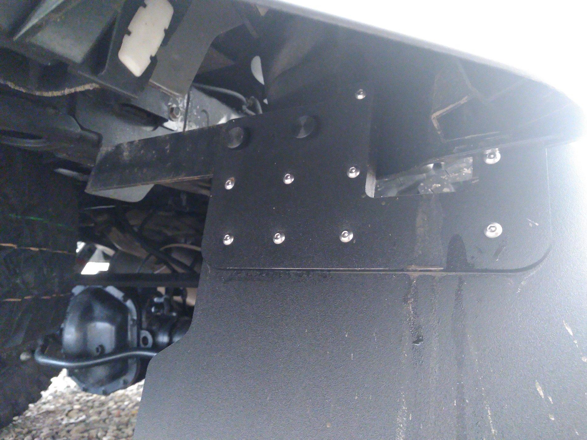

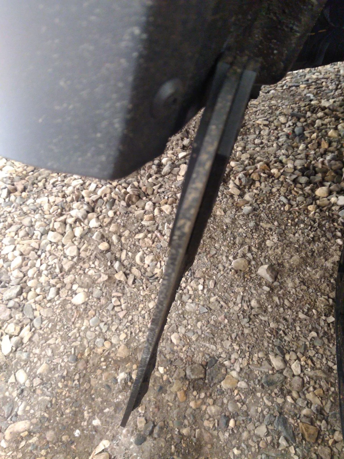

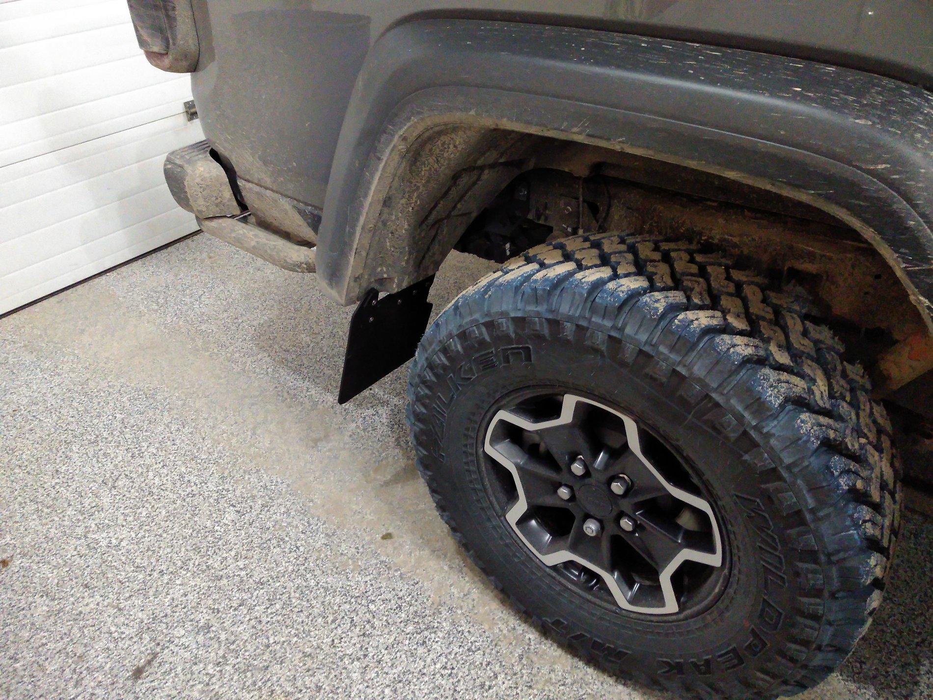

Do you have any photos you could share of how they attached to the bracket? I recently purchased the XL Originals and the backs just will not line up for me. They are about an inch off and push on the fender on mine ( sport S )
JP15
Aug 22, 2019
Canada
2015 Black JKUR, 2020 Sting Gray JT Rubicon
Do these pictures help, they are from the passenger side.

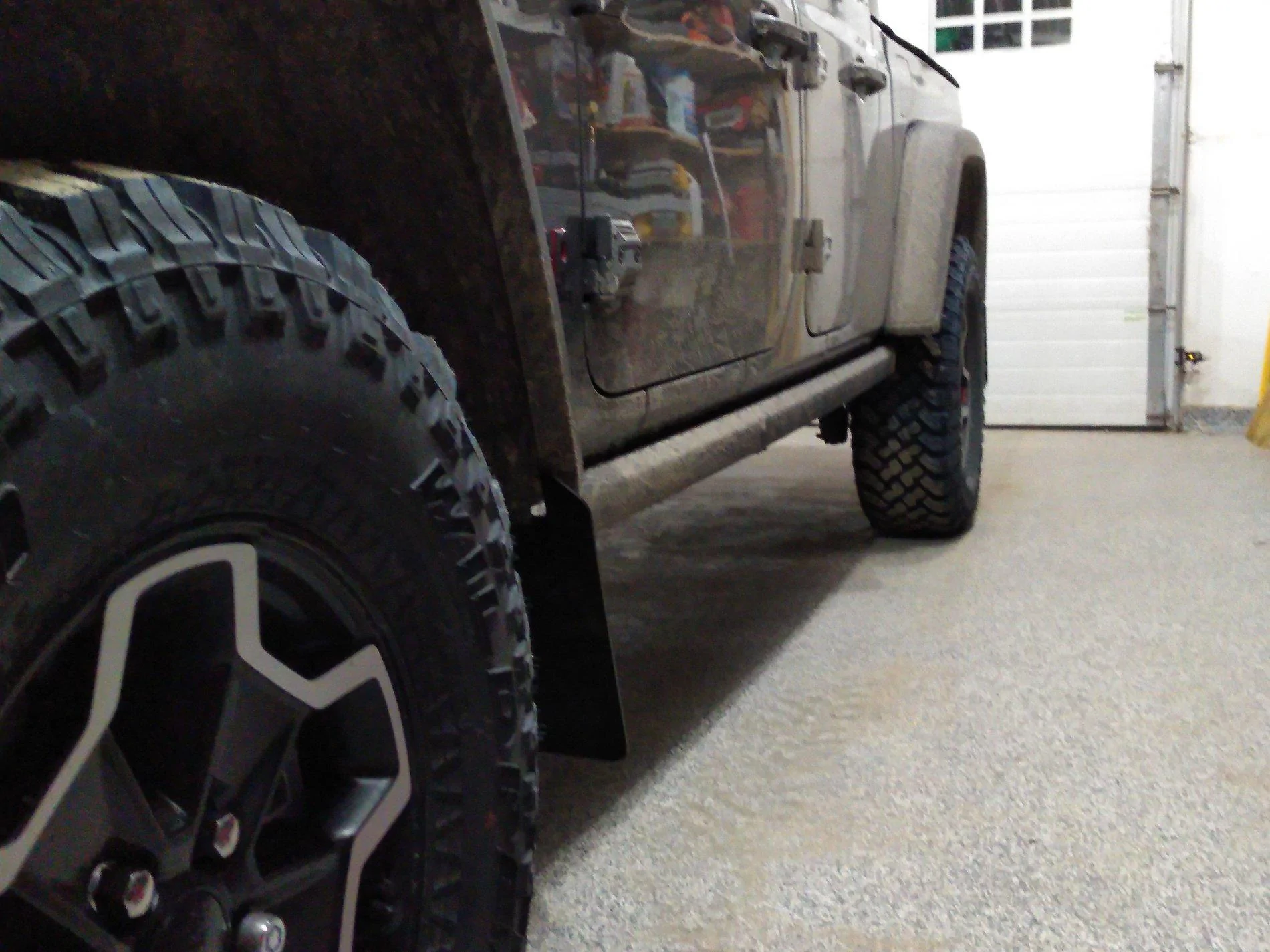

For those of you that have these and used them off-road do they really block rocks and mud from scratching the jeep? Our wrangler took a beating with 3.5” backspaced beadlocks with 37’s. Would love to put these on our gladiators but it’s a steep price.

I have the front set on and they seem to do the job . I got the XL long so they bump out to account for the tire. Depending on what fenders you have I had to correspond with Rokblokz quite a bit to get the rears figured out. If you have Sport Fenders, the rear flaps don't fit properly, and they recommended I cut about an inch off the inside of the fender ( for the price I don't think you should have to cut your fenders to accommodate them when they are advertised as fitting all trim levels ). Overall, love the front ones.

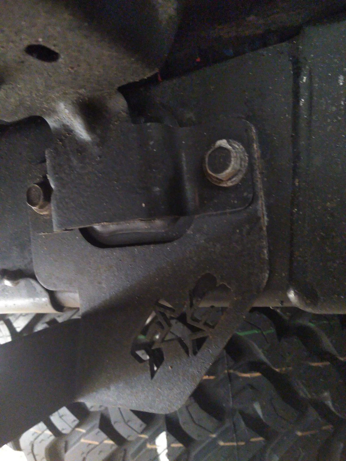

Has anyone requested and received the solution to fix the potential problem with the support brackets?
Email from Rokblokz:
Dear Buyer,
We want to Thank you for your purchase of our Jeep Gladiator mud flap kit.
We are constantly testing and striving to make our products the best out there, and have recently discovered that in super muddy situations there could be some issues with the weight of the mud causing the brackets to flex and potentially bend and crack (especially if your bracket is not mounted right next to the frame on the right(US Passenger) side of the vehicle, but on top of the factory support bracket). As so, we have created an easy solution to add better support to the arm that holds the flaps therefore eliminating this potential.
If you live in an area with super thick heavy mud or really only ride in the mud and are worried about or have already seen some flexing of the brackets, please reply to this email as we have developed an easy solution for that and would love help.
