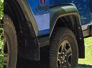

Think mine from years back were made universal for all the trims. There was an edge lip that molded to the fender when it was lined up, so a screw and then a tree clip was on the edge of the outside of the fender then attached with screw mid top with an extra tree clip someplace, if I remember right for front anyways. The rear attached slightly different with two screws on outside edge. Do the inner screws not line up right? Or are trying to line it up from the inside out instead of the outside in?
Inside seemed to line up ok but, looking at that left picture where that splash guard is on the right side...mine was still in the wheel well and not to the edge
Mine is a sport so the narrower flares, btw. So yeah that sounds like your first thought that even though it's claimed to work with the high altitude they really don't.

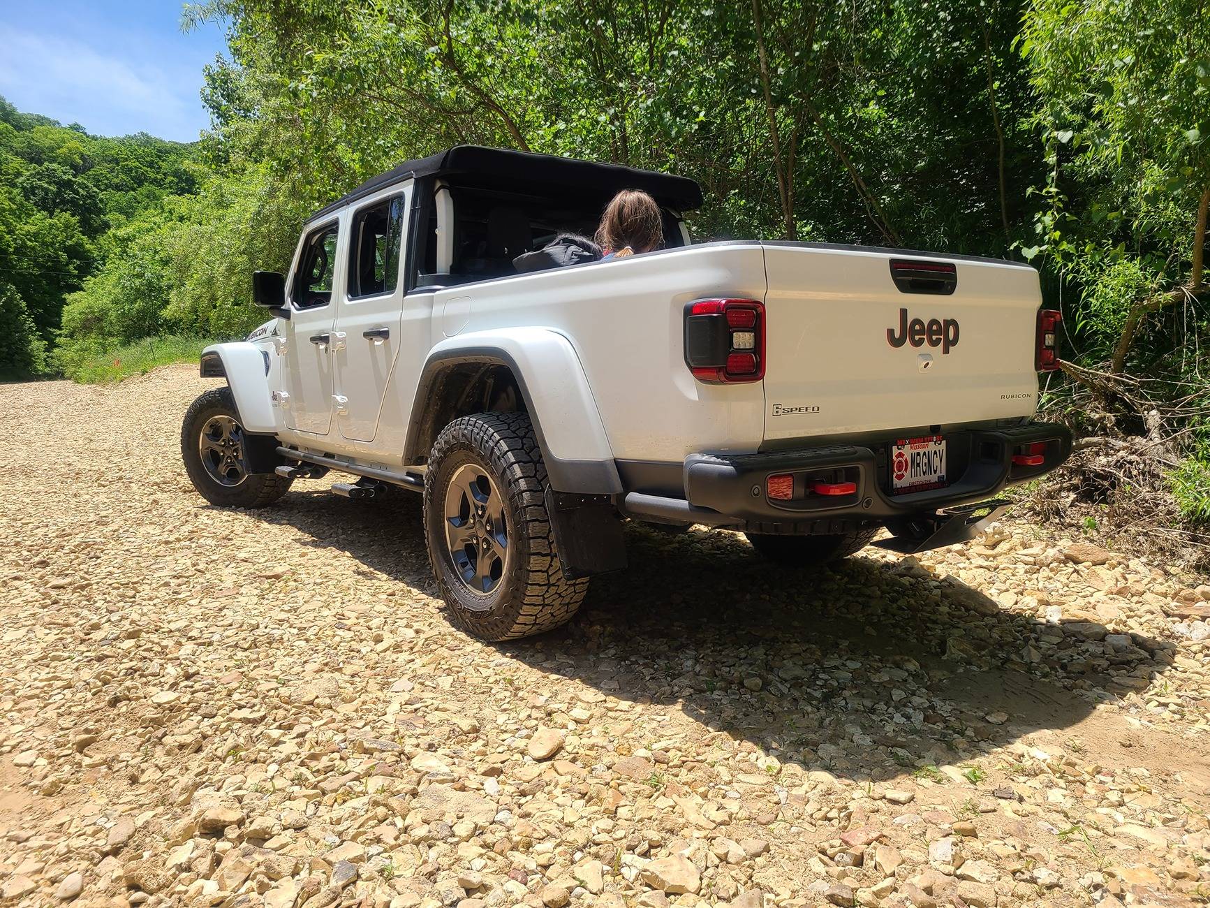

I bought mine new in July of 2019. It's a Rubicon. I've always been a big fan of splash guards and I try and put them on all my cars and trucks. At that time, Mopar didn't make any that fit the Rubicon (there was no High Altitude trim or Mojave then). I went with Rokblokz and I couldn't be happier. They don't conform to the fender lines, but I think they give the Jeep a Land Rover flavor and they are excellent at doing their job. They're also easily removed for wheeling.
