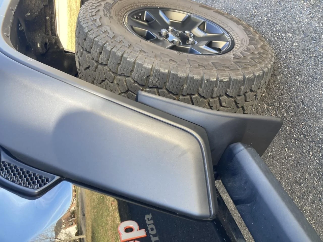

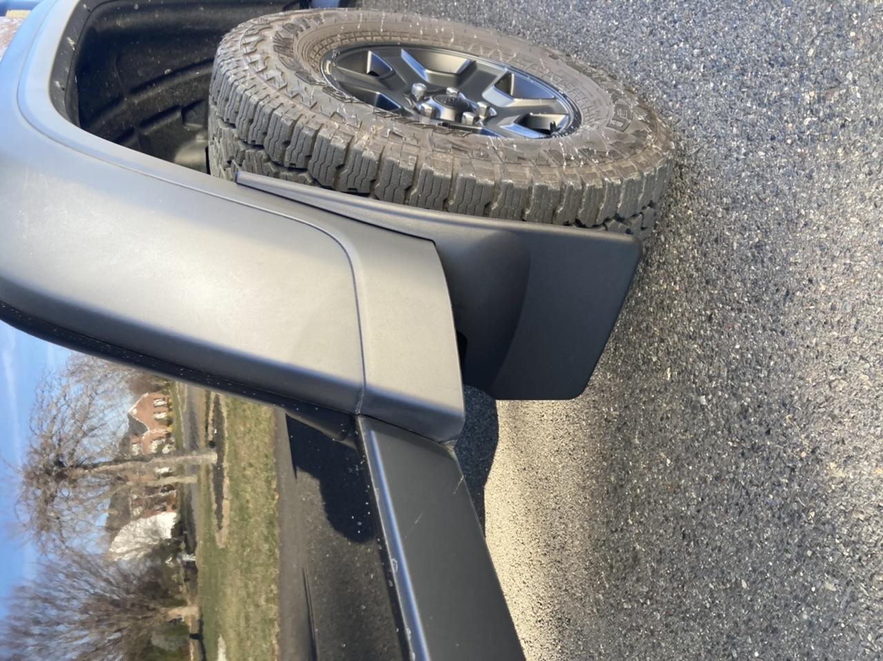

Great news for anyone who wants to use Weathertech Mudflaps on a Mojave
The Weathertech Rubicon Mud Flaps fit perfectly
Part #110100-120112 for both front and back
No drill and easy install.
On Weathertech’s website it says they do not fit if you select Mojave. So, you have to select “Rubicon”(Do NOT select Sport or Overland since the fenders are different)
I just installed them on my 2021 Mojave. I will get pics later today when my hands thaw out from working in the cold.

I appreciate you posting this up. I installed mine today and they look great and fit perfect. I could not get myself to buy the Rokblokz. I do not care for the look at all and they seemed way over priced. Very happy with the Weather Tech.

the Mohave and Rubicon will run the same weather tech molded gaurds, i put them on my Mohave fit is perfect, the rears are a little painful to install, use a dab of super glue on your finger to hold the nut while your get the bolt started, the mounting hole is up in there a bit on the rears.

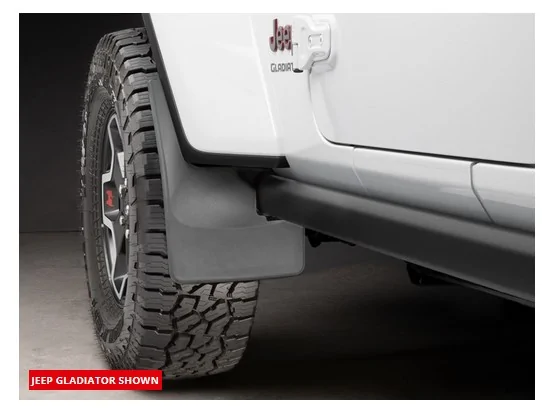

I had a Rubicon JT before my Mojave. I believe the rock sliders are the same. I put the Weathertech on my Mojave and they were a perfect fit. You can see the indent for the rubi rails on the Weathertech splash guards. Easy to install too.

And for comparison, here are the Rubi ones (from the Weathertech website):
