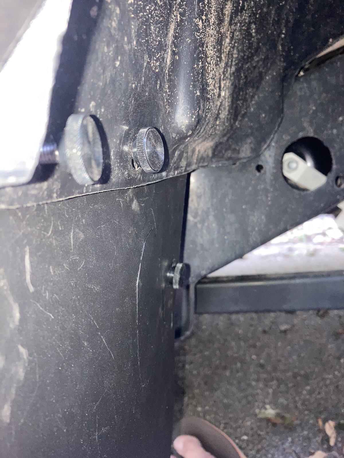

I have. The sidesteps sort of get in the way but you can still get the flaps on.
I cannot seem to get the thumb screws to go in completely flush against the inner fender wall, the 3 flap holes do not seem to align perfectly with the 3 vehicle holes and so you end up having to put the thumb screws in at a slight angle. This might have to do with the Overland steps pushing against the flap — will know soon as I have received Rubicon rock rails and will install them soon.
Hard to see in the photos but at least my experience was that I “felt” the screws angled trajectory when screwing them in.

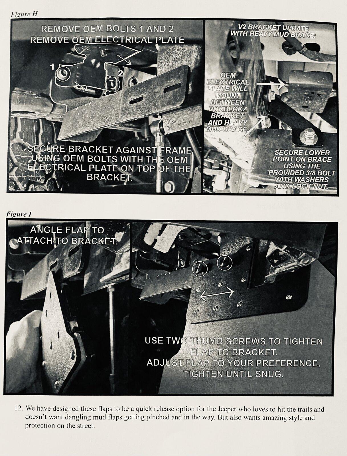

I am about to install the front and rear flaps in my Overland—can you tell if these are the updated instructions, or if I have to do something different with some of the mount tabs?
At least for the fronts, this is what I did: I did not follow the printed instructions. Just like the inside clip that goes on the body, I installed the other two clips on the fender tabs between the outer fender and the fender liner. Thread the thumb screws through first before trying to add the flaps. This allows you to line-up the threads easier. Once you do this, slide the flap between the liner and the tabs. Then you can install the thumb screws fairly easy. Doing it this way, I had zero clearance issues with anything and they fit great.

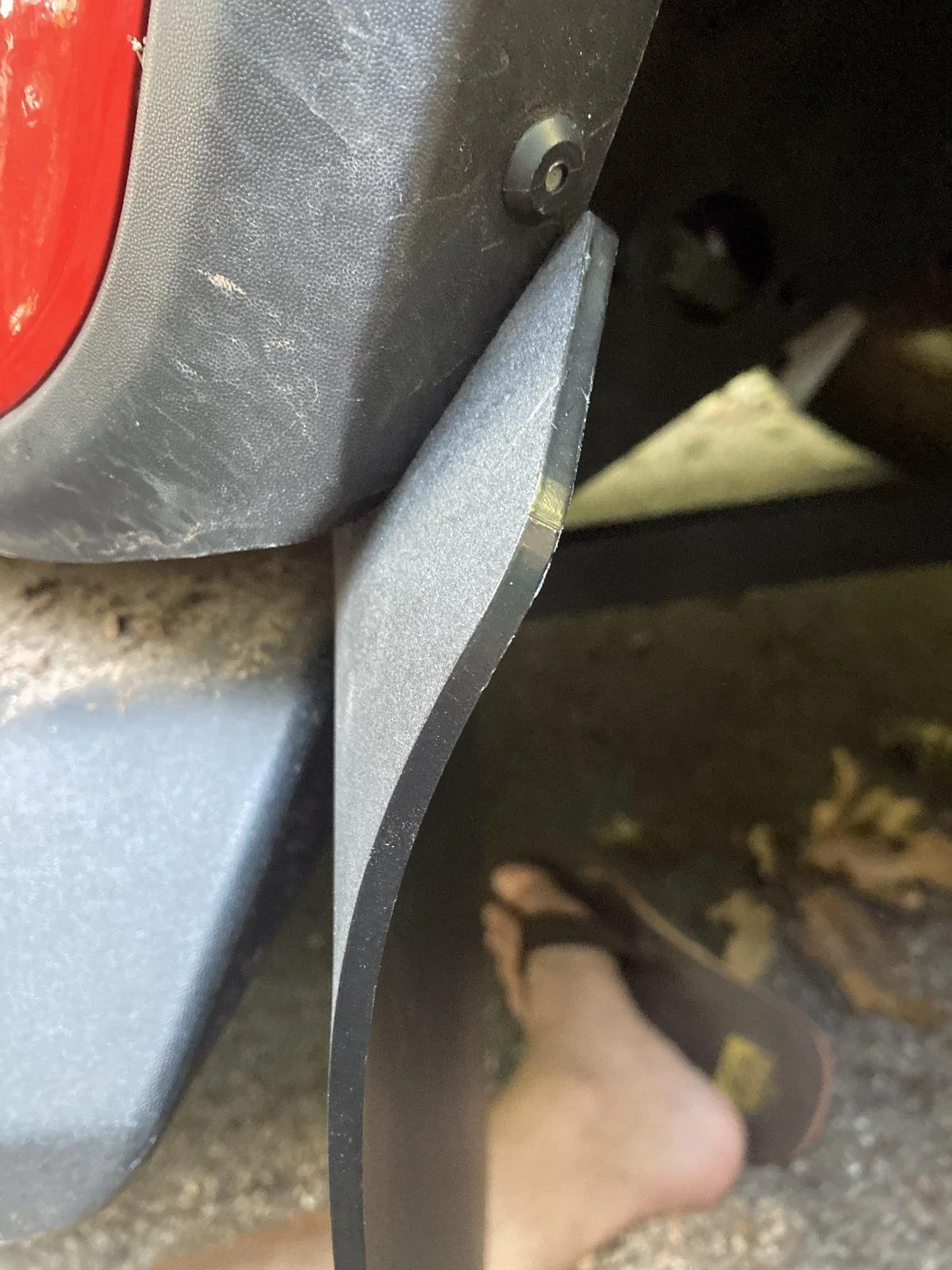

No idea, I just drove it on the freeway today. I heard some noise when I came into my neighborhood, and saw it when I got out.
Probably will be covered under warranty.
Please let us know if you get a hard time.
