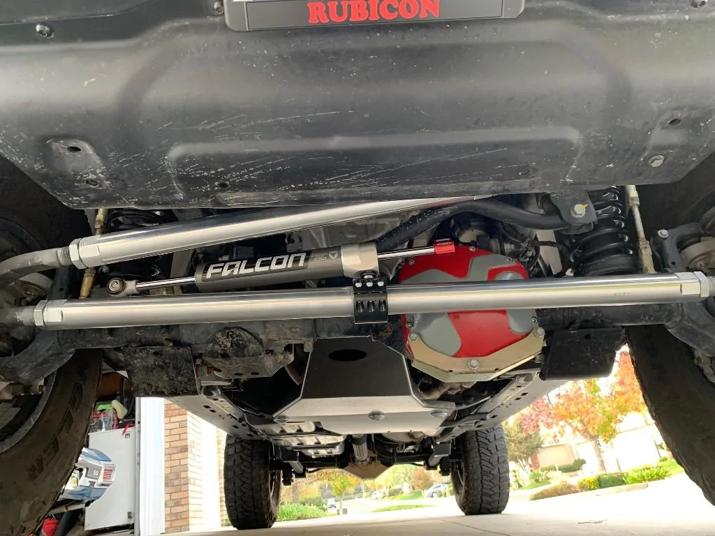

Have my RPM tie rod that I would like to put on and adjust toe temporarily until I can get a full alignment done. But have a question. I know it's 1/8 to 1/4 toe in generally, but measure from the hub or the tire? Tire widths all varying will change the measure at the tire quite a bit when it's that small a delta.
Or is the 1/8 to 1/4 at the tire meant to adjust for the tire outboard from the hub?

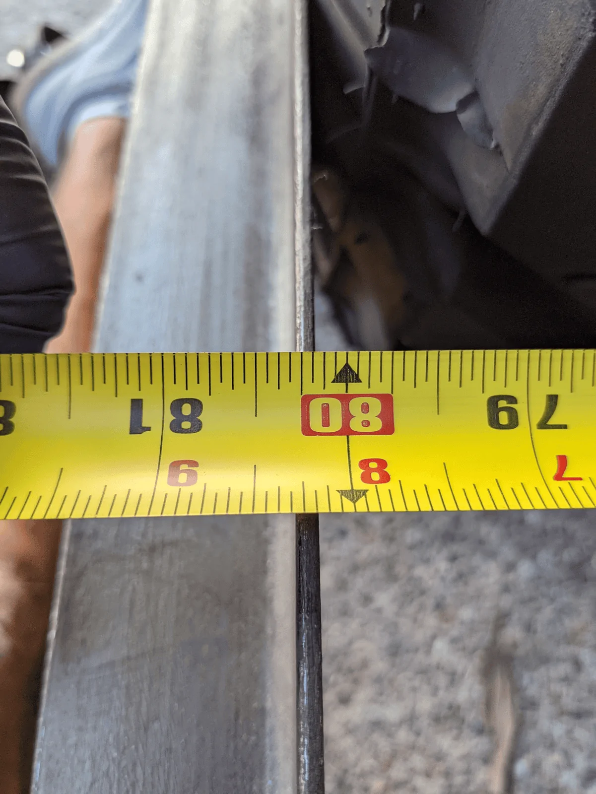

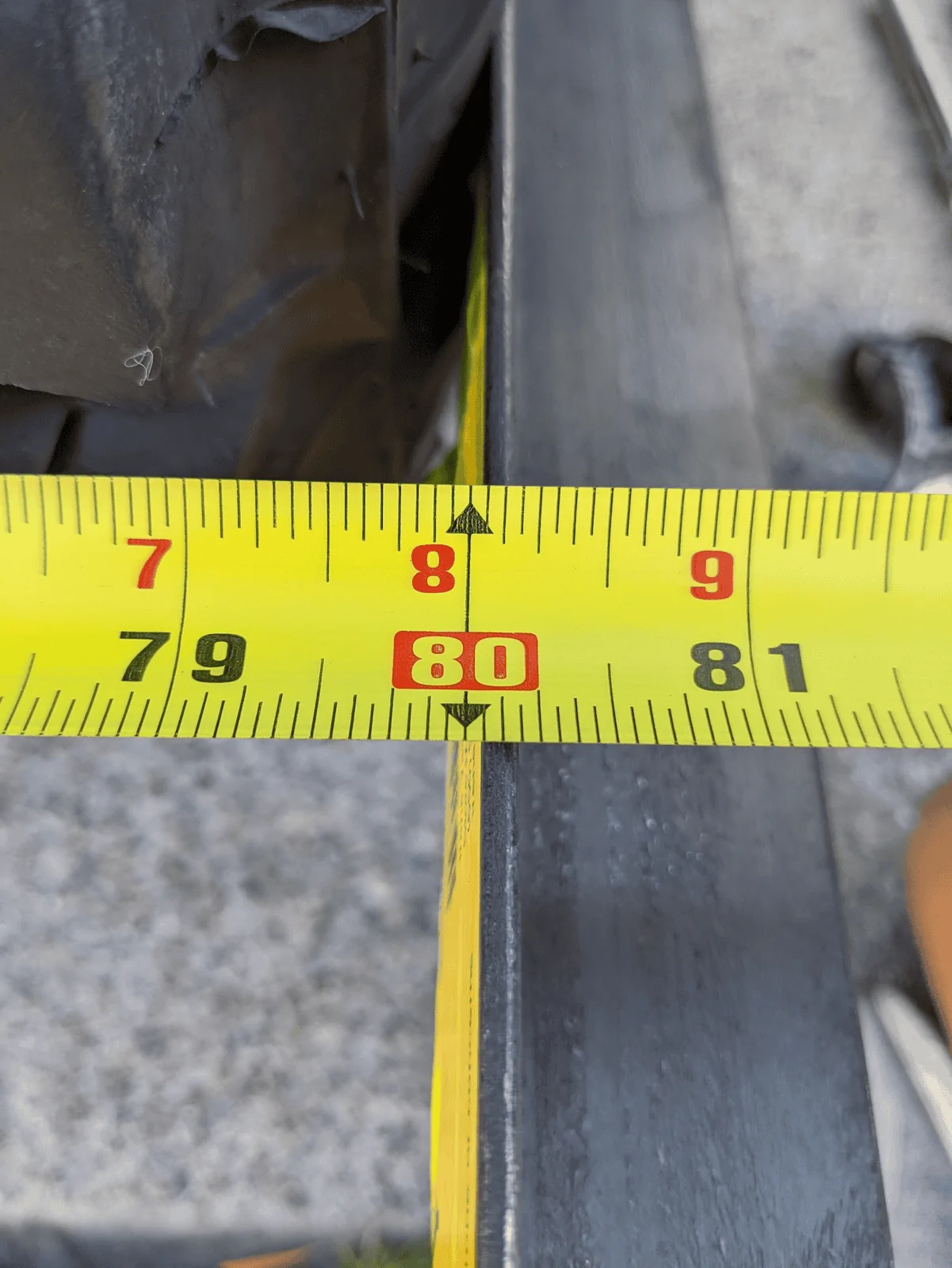

After swapping the tie rod I set up the angle irons at level at a height that would allow me to measure front and rear. Rear is 80 +3/8, front is 80 +1/8. So 1/4" toe in on this method. Knowing it was toe in I just left as is. Drives fine.

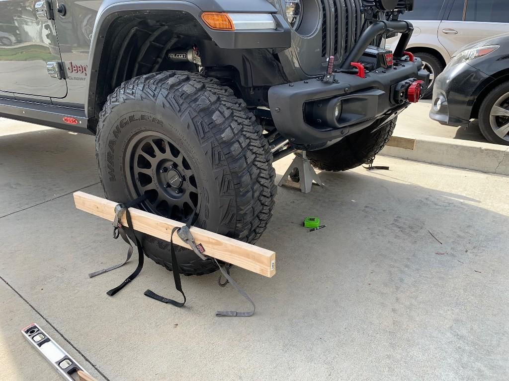

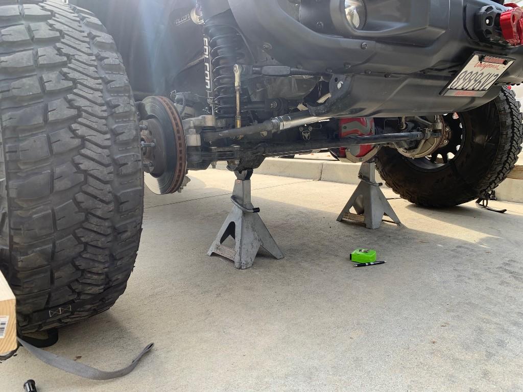

I just did the RPM Steering 2.5 ton drag link and tie rod. Great Kit ! First thing is to do your drag link and make sure the steering wheel is perfectly straight on the fwy.
Then, I strapped two of the straightest 2 x 4s I could find to the wheels and measured front and back. make sure the straps are tight and the wood cannot move - even if bumped, or the wheel turns while it is off... Use a level to make sure both pieces are level when you measure. It came out to 1/16" toe in from the factory at the edge of the 37" tires. When I switched the tie rod, I measured perfectly from ball joint to ball joint a few times, but, it still was off a lot when I installed it. To get the driver's tire looking straight, the steering wheel was off. The tendency is to make the new tie rod too long, no matter how good you measure..... Mine had to be shortened. So, I just remounted my tires with the wood still on them, and remeasured. I was way toe'd out. Once I got the measurements close to 1/16" toe in, the steering wheel was straight when the tires looked straight. After driving it a while, it felt just a tad loose and the steering was just a tad off, so, I went with 1/8" toe in at the wood, and the truck dialed in perfectly.
Note: a 30 degree turn down on the RPM Steering Tie Rod (turn towards the street) gives you about 1/16" additional toe in.
Here are some pics.
