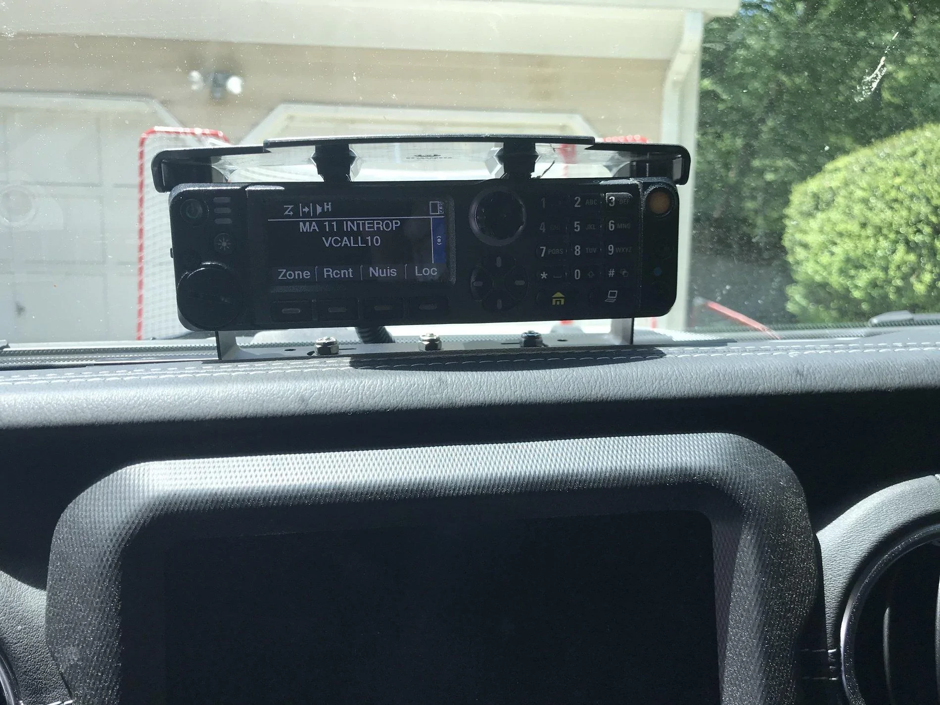

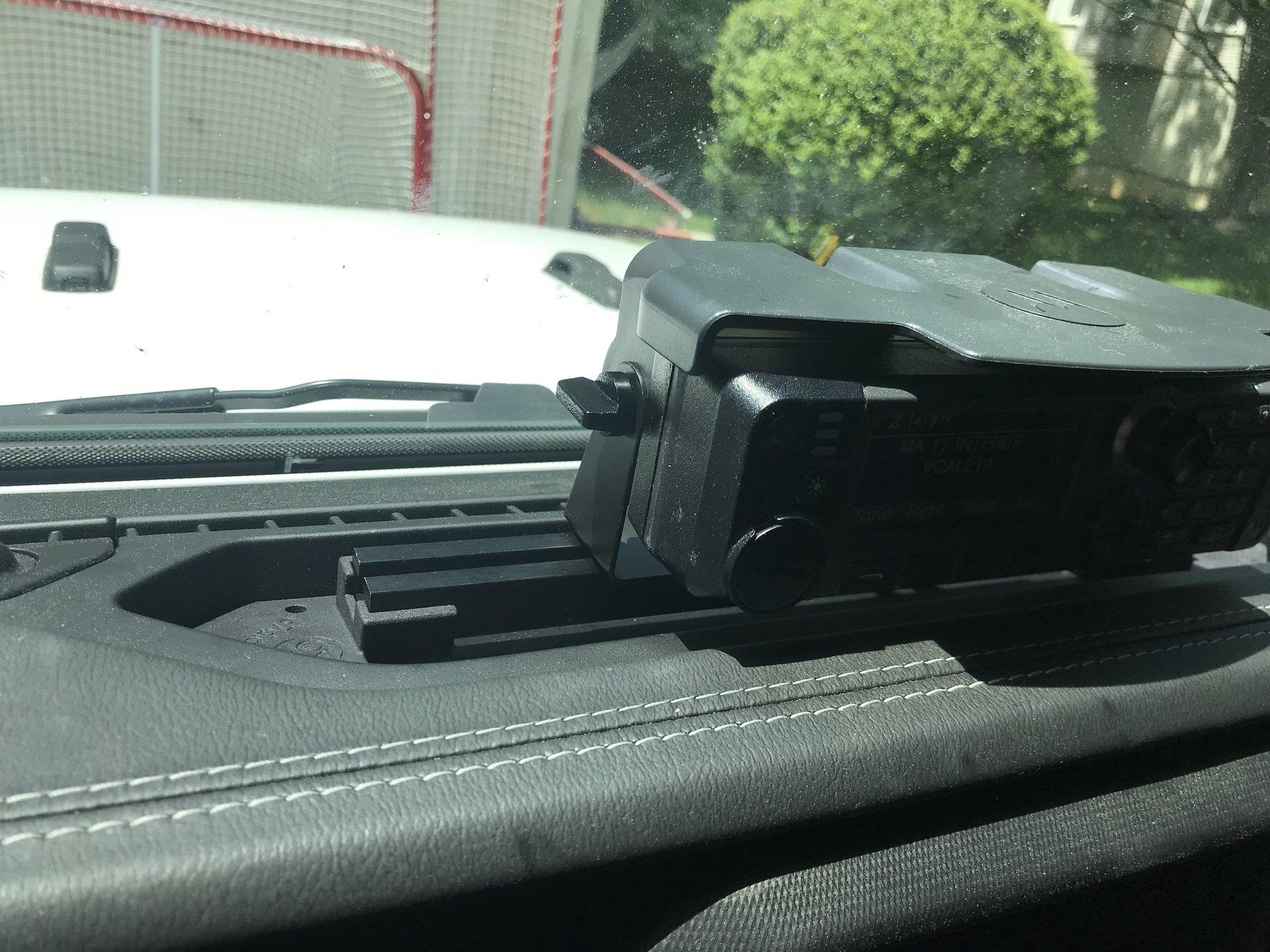

I have the RAM rail there now. I may set my O7 up there and see how i like it.

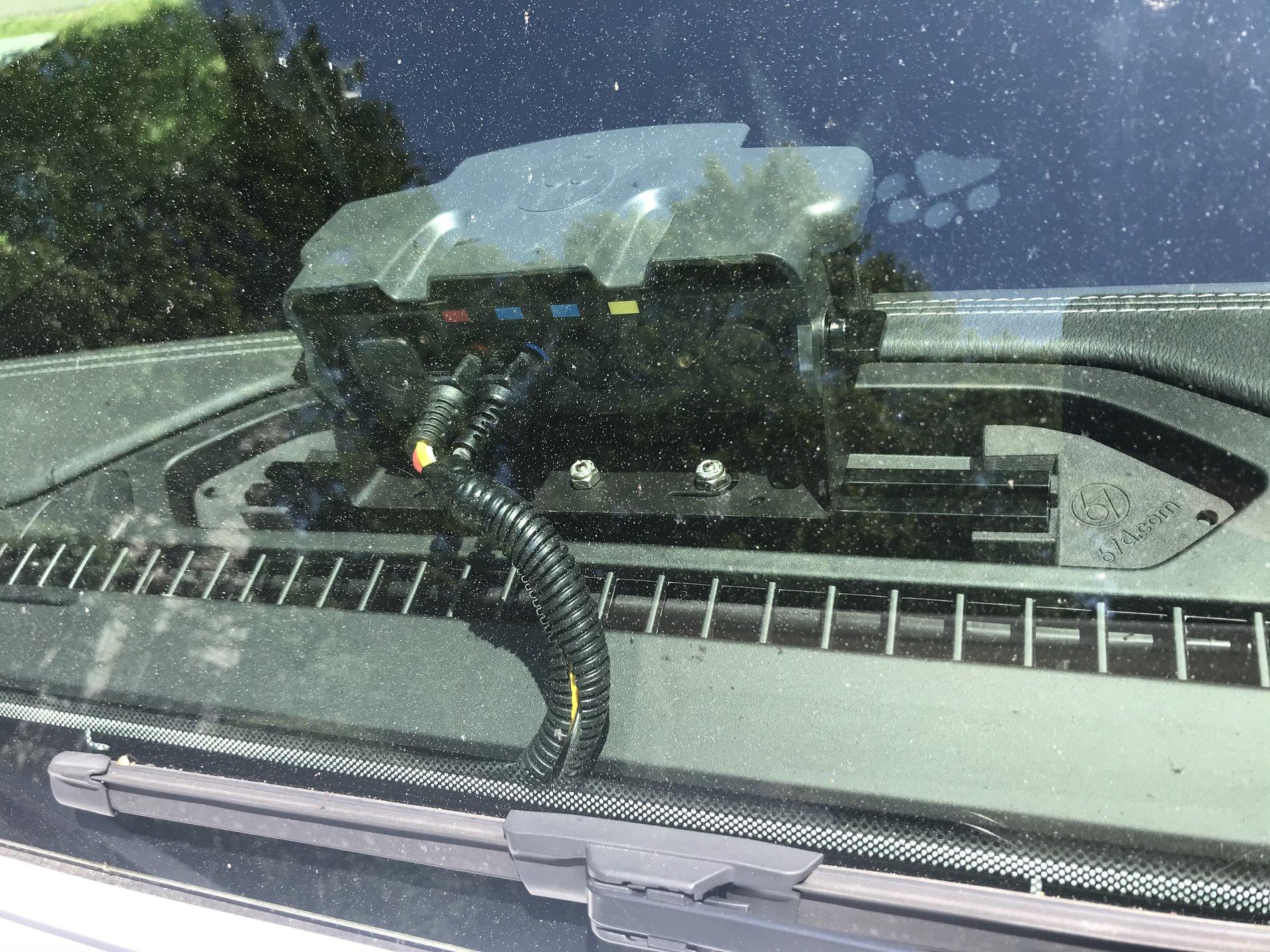

Nicely done install. I just picked up my JT last week and have ordered the mounts and intend to have one or two control heads in a similar location. Any issues popping things off to get the cables up there? It was easy to run stuff in my LJ, but I have not taken this one apart yet. I have been reviewing old threads, but don’t see one on the subject of running wires to the top of the dash.
Folded down the windshield and ran the wires there

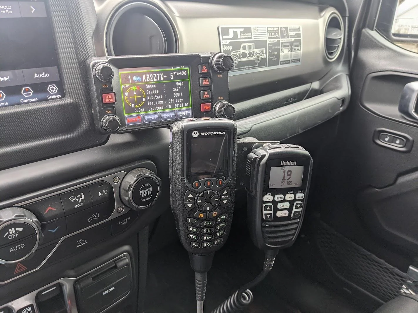

Forgot to ever post a pic. Here is my completed JT with FTM400, APX8500 (O3 Control Head) and CB. I also have the midland MTX275 and swap out the CB when using that. Both mics just drop in the glove box. The mount is the grab handle ball from CM off road with RAM short bar and ball on the back of a 3" piece of aluminum that is sprayed with truck bed liner. Magnetic mic on the O3.
