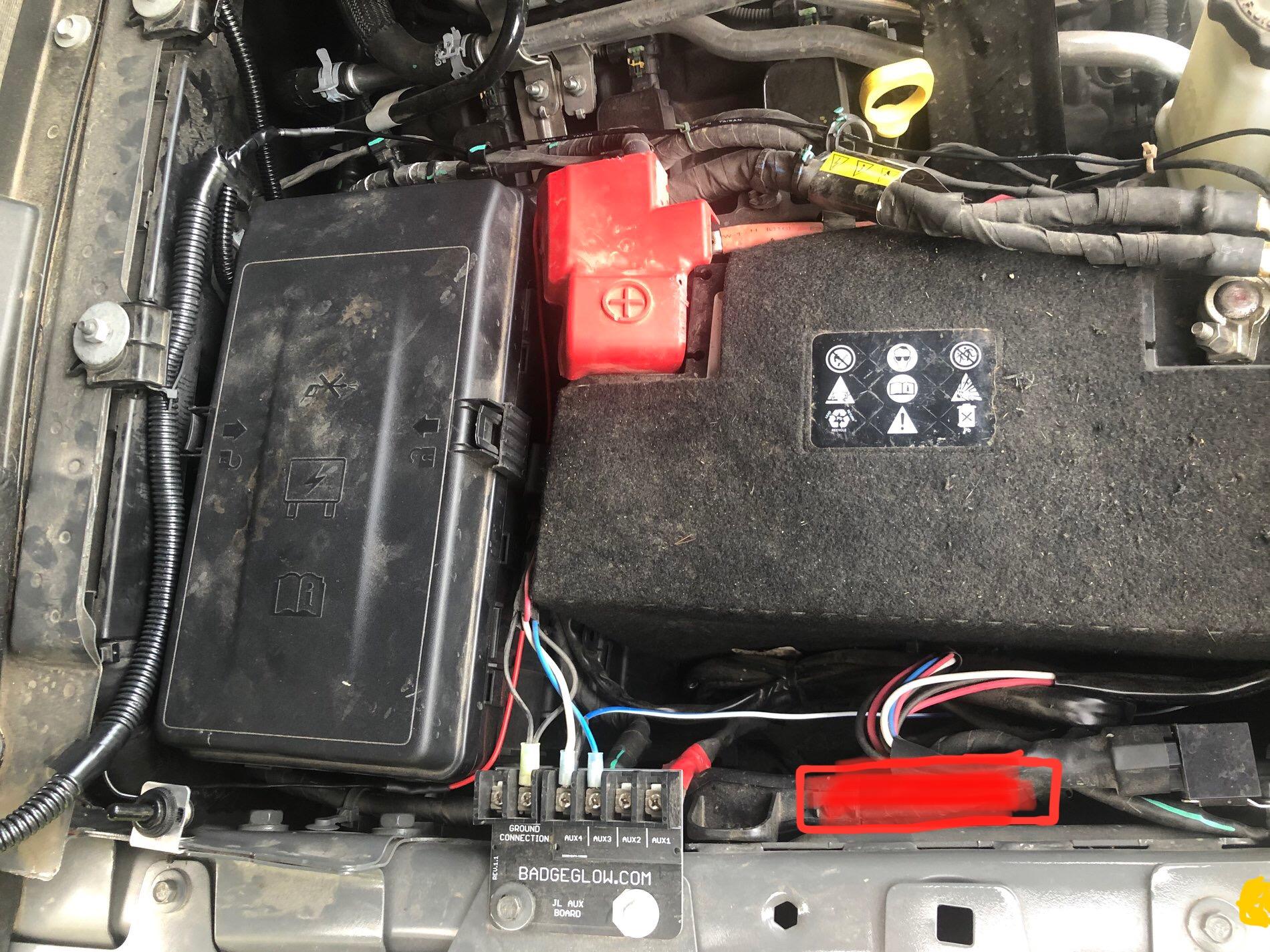

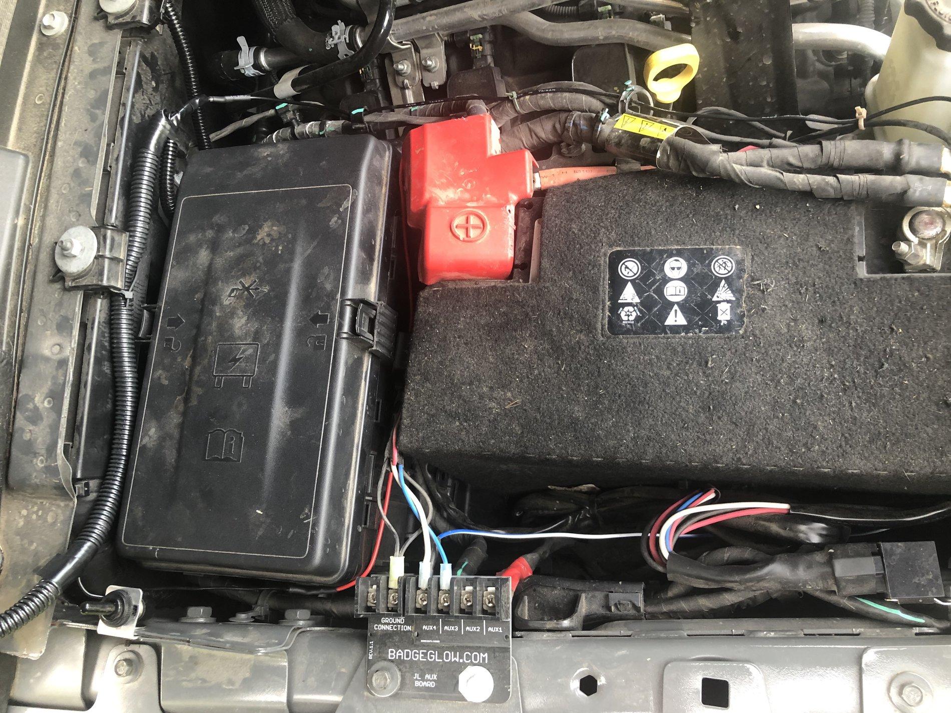

I picked up the Cyclone rock lights set (6 lights) from KC and am figuring out how to do the install. The biggest thing I'm trying to figure out is where to place the fuse bar, since there isn't really any free space on the wall of my engine bay anywhere near the battery (I installed a Badgeglow Aux Board already).
Jeep Gladiator KC Cyclone Rock Lights Kit Install - Fuse Bar Placement? Badgeglow Aux Board
I know somebody on this forum has installed this kit on their JT, and was wondering where you put the fuse bar when you installed your Cyclones.
Also, did you install the ground post that came with the kit, or did you just ground the lights to the existing ground post on the engine bay wall next to the battery?
Thanks
CB

I figure you have yours installed already, but I marked up your pic to show where mine is. Red is where I zip tied the fuses- easy to clip off if I need but I wanted to tuck it as much as I could. And the yellow in the bottom corner is about where I have my ground post- between the bolt and the air intake boot. I didn’t want to drill until I remembered it’s aluminum. Works perfect, super clean install
