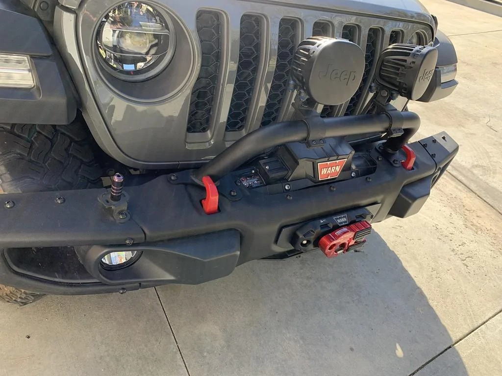

Piecing together a Factory 55 kit, this server me well using only factory hooks?
Jeep Gladiator Replace the hooks with loops? 1651861208533
