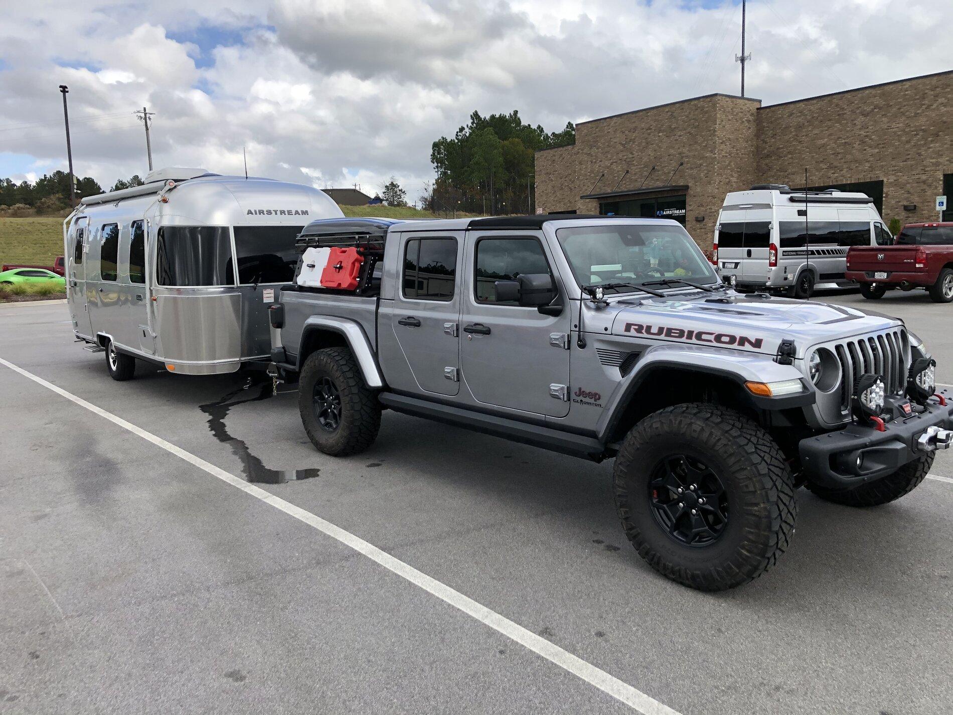

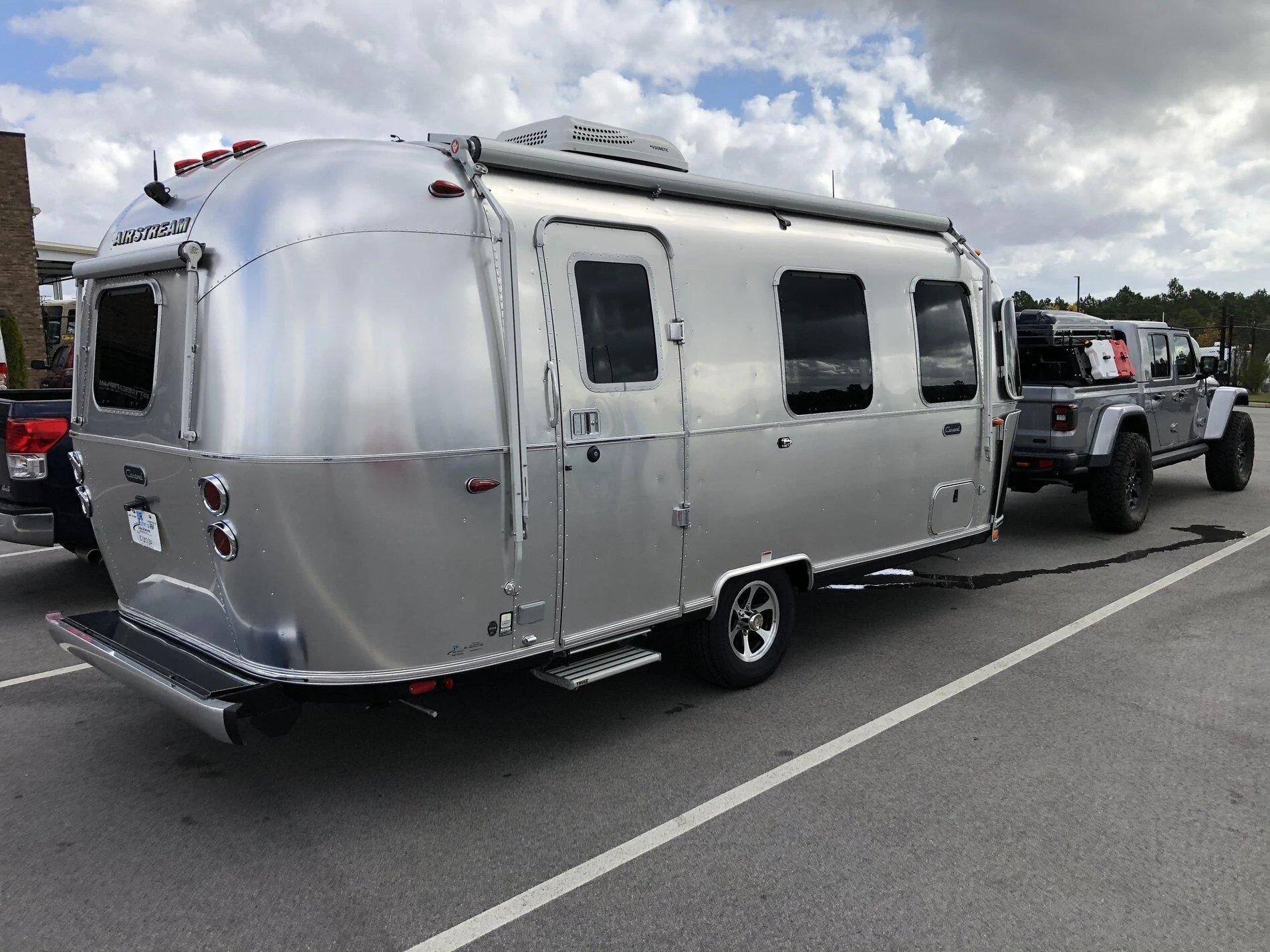

I'm not familiar with that hitch setup you have and its hard to tell from the pics but you have to remember the further the ball is from your rear wheels the more leverage the trailer has to induce sway. Think of how sticking a really long stick out the back of your receiver would make it easier to move the truck side to side.
40,514
54,044
I had not noticed how crazy far back that ball is. That's also like putting your payload on the tailgate and not over the rear axle. That's got a heck of a lot of leverage over the small light back end of that truck.
I prefer the ball be right up as close to the rear of the truck as is possible without interference.
I never magnified the photos to see - but now - I think MrJeep may be onto something possibly.
Yeah, thanks, first thing that jumped out at me. Very odd setup to be that long.
That IS long. Does it look like the whole heavy front section (tongue area) of the frame has been chopped off and replaced with a tubular metal? I expanded the picture to see the hitch better and I'm trying to figure that out too.

The hitch is very interesting, even though the ball is very far away from the truck it doesnt turn on the ball, The ball is fixed to the hitch and the front section of the hitch (orange piece) acts as a turning point(ball?) , Still further than traditional setup but not too much,
you can see how it works in here
https://hensleymfg.com/how-does-the-hensley-hitch-work/
I can also get some detailed pictures in the morning.
Currently I am adding some weight to the front and will check in two weeks for our maiden voyage (300 miles) . If I still have sway I will change the hitch and buy 3p
