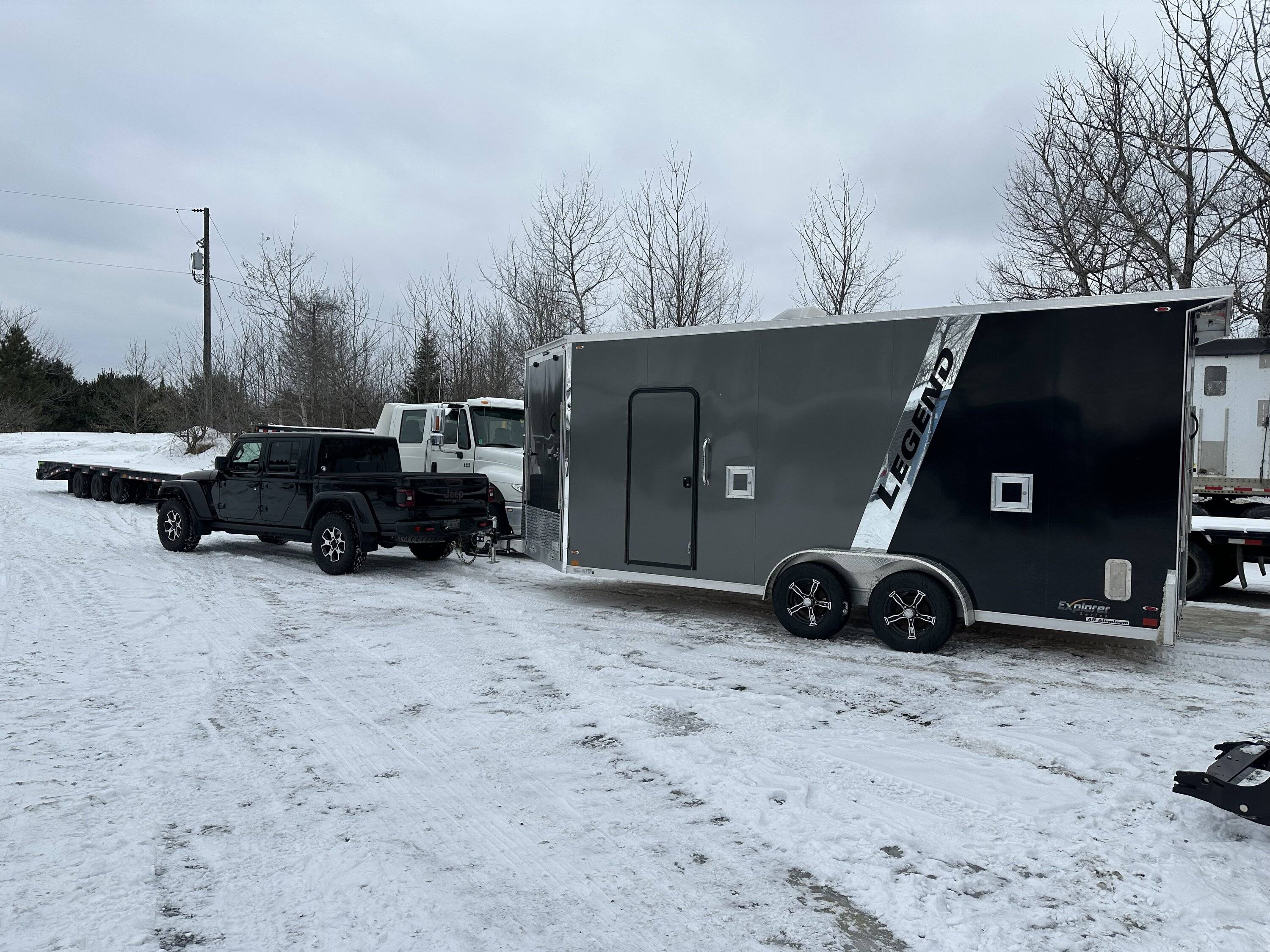

Mine is a 16' V nose, it's 20' over, 7' wide, loaded at 5500 it's a little beef cake.

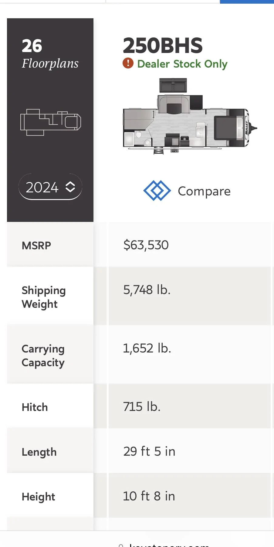

So what are you guys using for hitches? What brand and how do you like it? I am ready to upgrade from my old curt and looking for options, must have sway control of some type , what’s the good the bad and the ugly of them ? Will be towing a flagstaff 22 ft 5100 empty that weight does include propane and batteries
