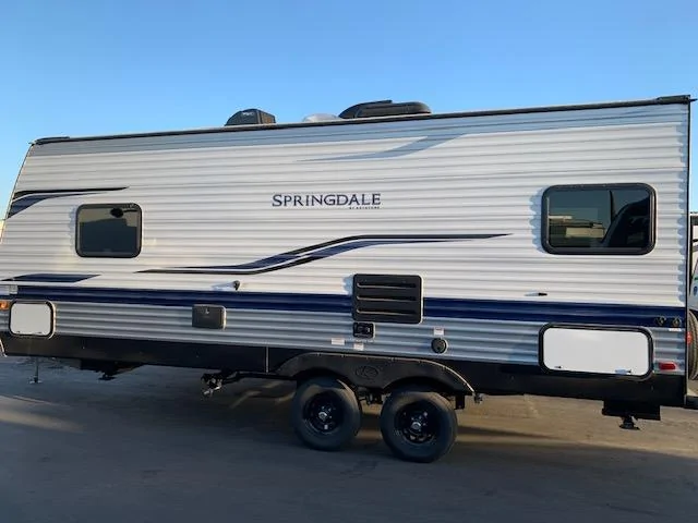

Since the gladiator has electronic sway control would I need a weight distribution hitch for a 4000lbs trailer? The RV salesman is pushing for one but I haven't seen anyone using one at that weight....

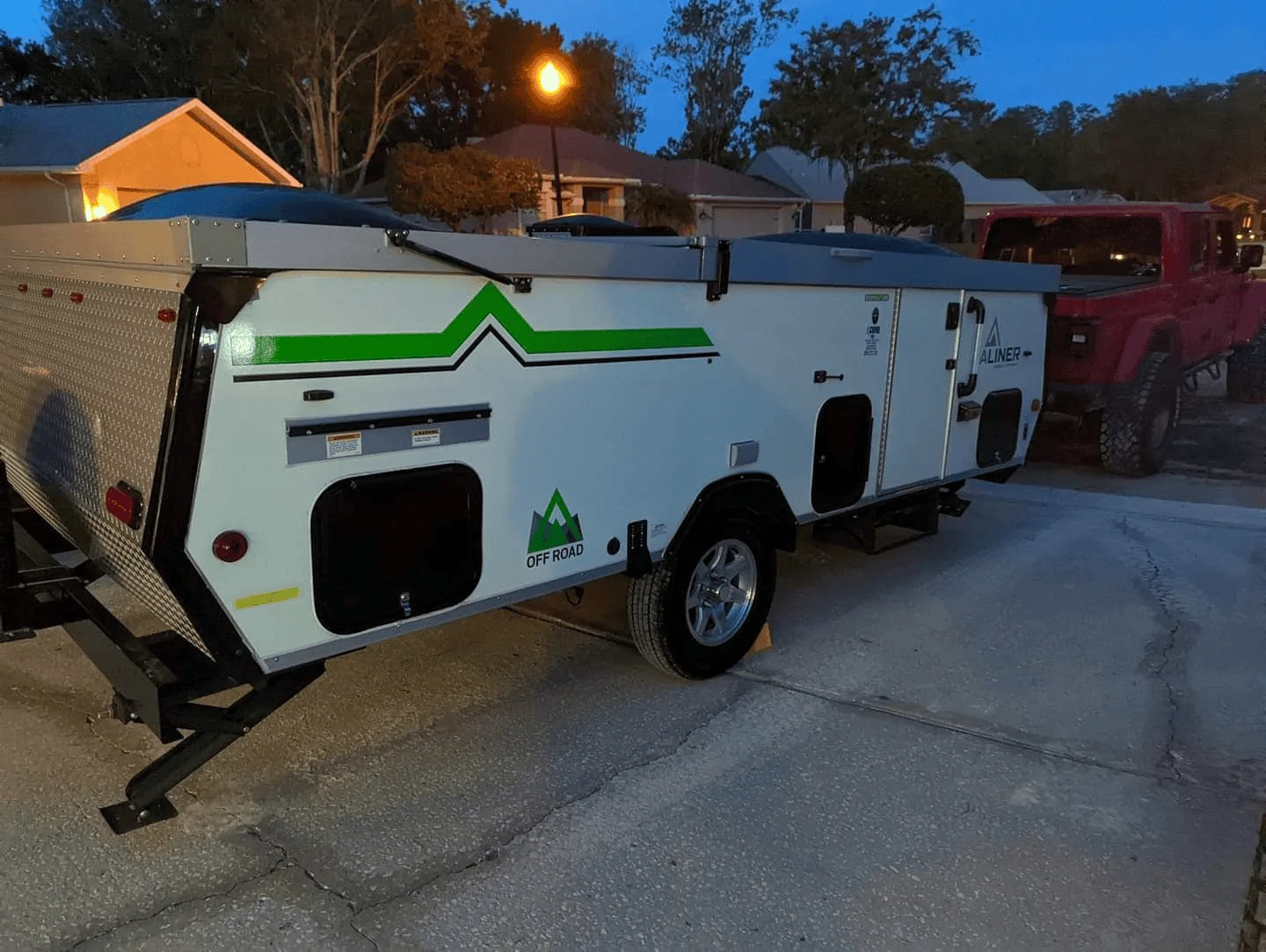

Rather than start another thread, what are you guys opinions on a wdh for one of these?
Jeep Gladiator Sway control 1650388652800
Its about 2K pounds dry, 3000k fully loaded, hitch weight is 325 or so fully loaded. I wasnt getting much squat on the gladiator with the clayton springs and it towed the 350 miles at 70 with no issues, but wondering if it would be worth spending the money on a wdh.

I've seen professional sites say 8 to 15% depending on the weight of the trailer. Apparently they have different suggested numbers if the trailer is heavier vs. lighter.
People are lumping all trailers, types, number of axles and other things all together too often.
Some of what you do will depend on the trailer, the weight of the trailer, the number of axles and where is the weight of that trailer - up high, or all down load like a flatbed?
Not all trailers are made equal nor should it be said "do all trailers this way" or that all need WDH.
Iv'e towed with several different trucks over the years, 1/2 ton, 3/4 ton, 4x4, 2 wheel drive, heavy trailers, light trailers....... I'm no expert by any means, but I avoid forums for info and go to the companies that make the rigs or sell the trucks. Forums are a lot of opinion, sometimes wrong.
My experience with flatbed or car hauler - the wheels are waay back there on the trailer, unlike most :"campers" or travel trailers. The longer the distance between ball and axles, the less likely it is to sway. I had a home made flatbed (heaver than heck, steel I beams from a mobile home) and the guy put the axles in the middle. It wanted to sway. A friend and I moved the axles back (that was WORK) and got rid of the sway. Because of the sheer weight of the trailer alone, then put a tractor or car on it, I did use WDH. Even with my F250 4x4 it was better with the WDH.
Then I traded it for a PJ trailer, lighter, lower, better axle placement, and I asked the company and the dealer "no WDH or sway control needed if you load it right". And I hauled that thing around the country for years, no trouble.
I bought the JT and upgraded to an Aluma tilt-bed trailer, weighing even less.
The dealer said "no WDH". I called the company to verify and the engineer, a structural engineer, said NO WDH, you'll mess up the aluminum frame with the forces those things apply to the trailer.
And thinking about it, most places I go where there are people hauling cars around on flat bed car haulers, you don't see WDH.
But I'd never not use one with a heavy enough camper or travel trailer. Especially if it was single axle - it would help take the "bounce" and rebound out over dips and bumps, too.
500 pound tongue weight which is a tad on the heavy side for 4800 pounds of trailer and car, front end isn't "light", handles fine.
BUT I'm talking flat bed which is a totally different weight distribution just in itself and different center of gravity, different axle placement and so on. My truck loses the rake, but isn't ever spooky handling.
Boats, car haulers, all very different than campers, even campers are hard to compare these days with the really cool new designs and technology. If I was young again........
250
40,612
54,288
Single axle, looking at axle placement, trying to imagine other factors - I would, but I'm not there.
Ignoring any sway control concerns, one of the biggest reasons for WDH is to get weight back on the front axle so you have steering control. Jeeps (and other sold axle vehicles) already tend to have slightly flighty steering so they can be greatly affected by reduced weight. When using a WDH Jeep specifies 100% front axle load restoration (meaning the height from ground to fender at the front should be the same as when unloaded), whereas most manufacturers specify 50%.
Personally I’d use WDH with that trailer, or any camping type trailer beyond the tiniest teardrop as loading and balance on them can be all over the place.

I doubt the tires are rated for 70 MPH, but I've towed single axle cargo trailers of that weight to San Diego with nothing but a brake controller hookup. That's up and down the Grapevine, 600+ miles roundtrip, for context.
That's a cool looking rig! I'd aim for 12% / 360 lb on the tongue, myself. If it has a rotating/360 deg hitch like other off-road trailers, a WDH isn't an option anyway.
