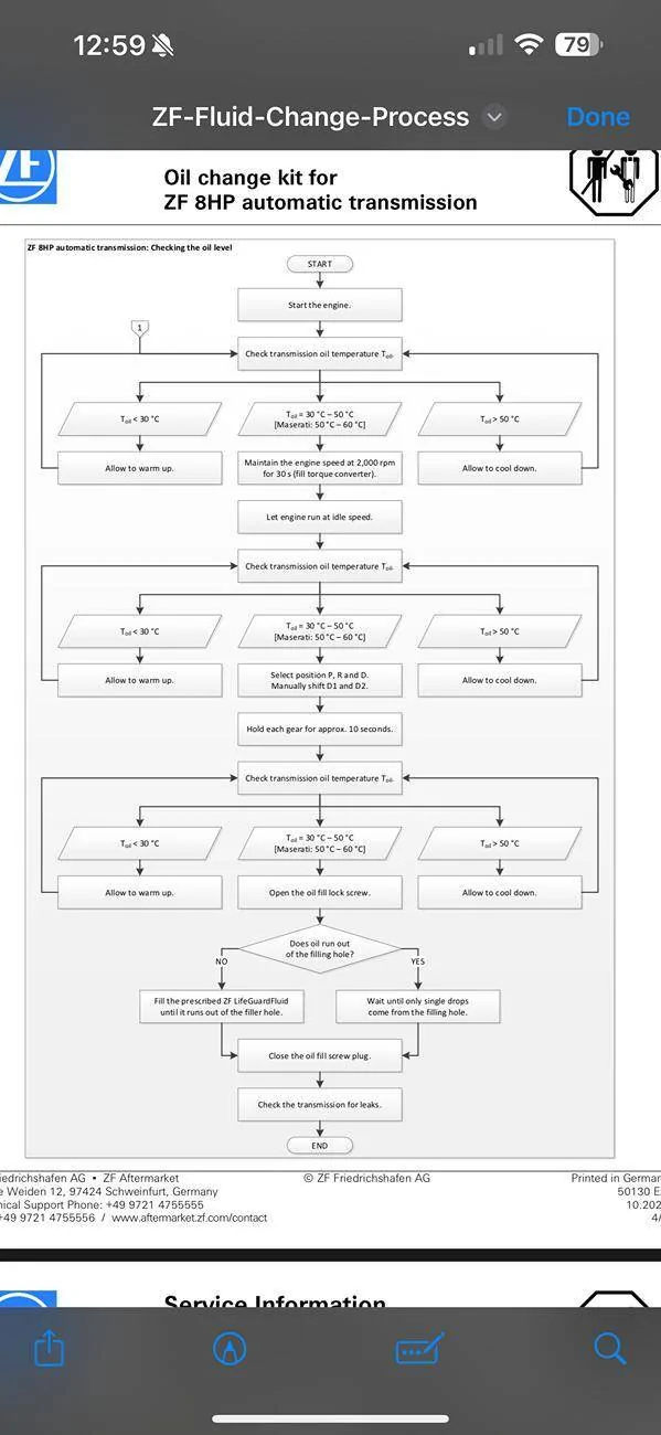

Is there an chart that utilizes Fahrenheit? Instead of celsius
Use 86 and 122 degrees.
86°F is the minimum temperature for all of the solenoids and valves to open and allow the fluid to flow through all passages. 122°F is the highest temperature that does not have a large effect on fluid expansion such that you do not have a false reading.

Here's the PDF - print it and use Google, Alexa, Siri or whatever to convert the numbers then write it on the print you just made.
Here are the "freedom units" you are looking for:
between 86 f and 122 f to do the work.
Below or above, and it is out of range.
