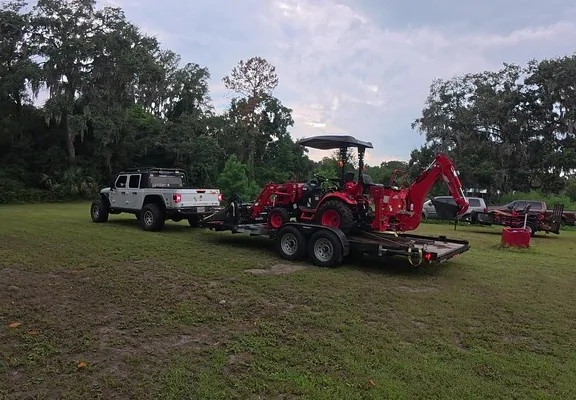

At the time I had moved back home to FL, was living in TX, and before that SC. So mostly warmer climates. Mostly flat except when I travel to wheel. But I do a lot of rock crawling, tow trailers regularly, and daily drive. Most people probably don't work their gladiator as much as I do, so that's a factor as well.
Jeep Gladiator Transmission oil change.  Maintenance 20250813 Tyson Jeep Pulling Trailer at Home - Flemington, FL (1)
