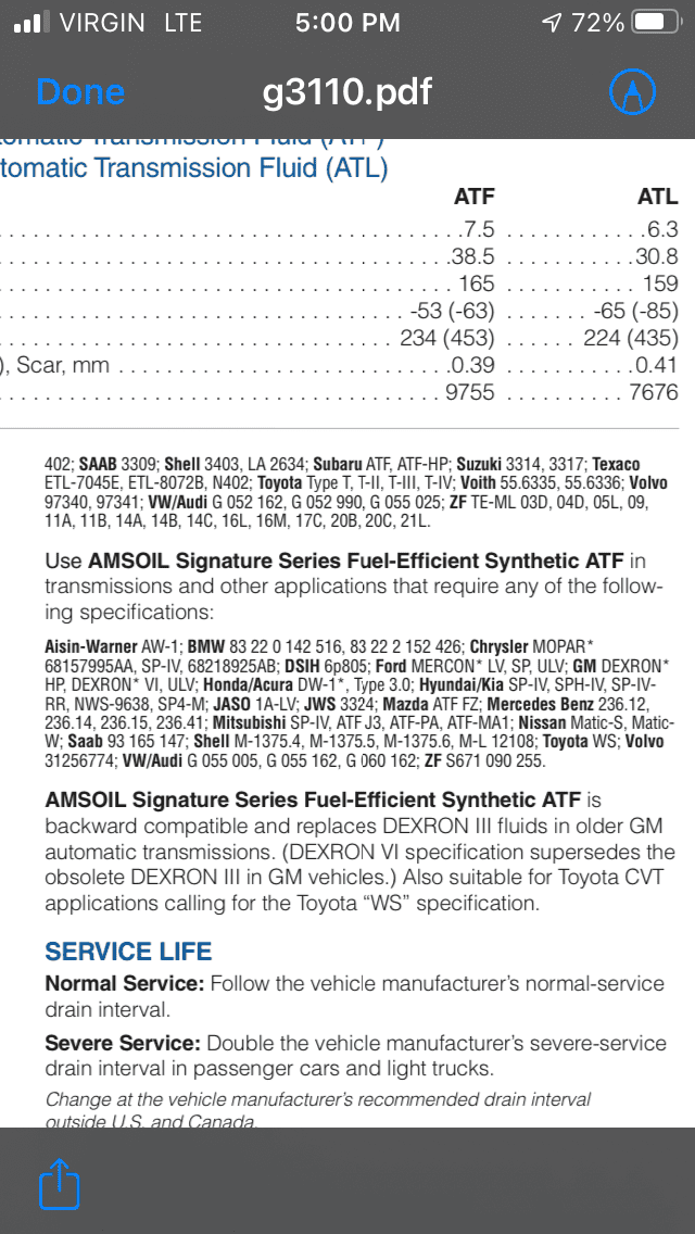

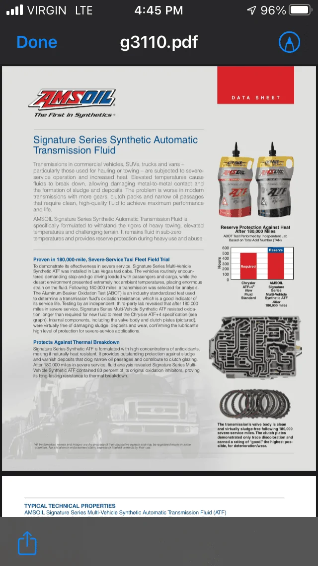

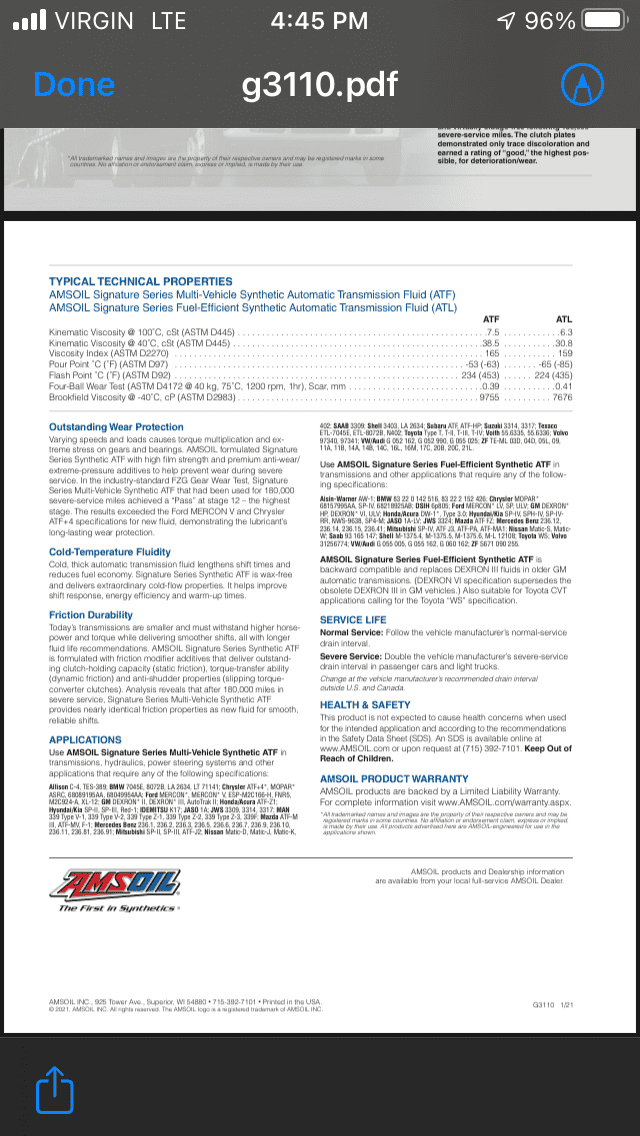

So, to be clear, I’m not promoting Amsoil, I’m just wanting a full synthetic for this ZF 85re tranny and I’ve now found out Chrysler/Mopar has published car manufacturer codes for oil companies to meet in order to be in compliance with ZF’s transmissions.
I asked my Amsoil dealer to reach out to Amsoil Tech to confirm Chrysler’s approval of their 100% synthetic ATF Signature Series oil and the reply back from Amsoil Tech is they didn’t go after an approval BUT their oil is in compliance with the codes. The list of codes on the 3rd pic is readable. The 2020 Gladiator Rubi falls under the first # “Chrysler Mopar 68157995AA”...

What we have is the specific code for the Chrysler Mopar ZF tranny they published that oil manufacturers have to be in compliance with in order to use our oil in that tranny”.
Well, if you're quoting Chrysler specification code as authorization to use the alternate oil, then you need to use the Chrysler answer when they admitted fault after the tranny blew in your story above:
"Chrysler determined the tech that did the oil change forgot to reflash the tranny."
Therefore, yes, yes you do need to re-flash the tranny after an oil change.
