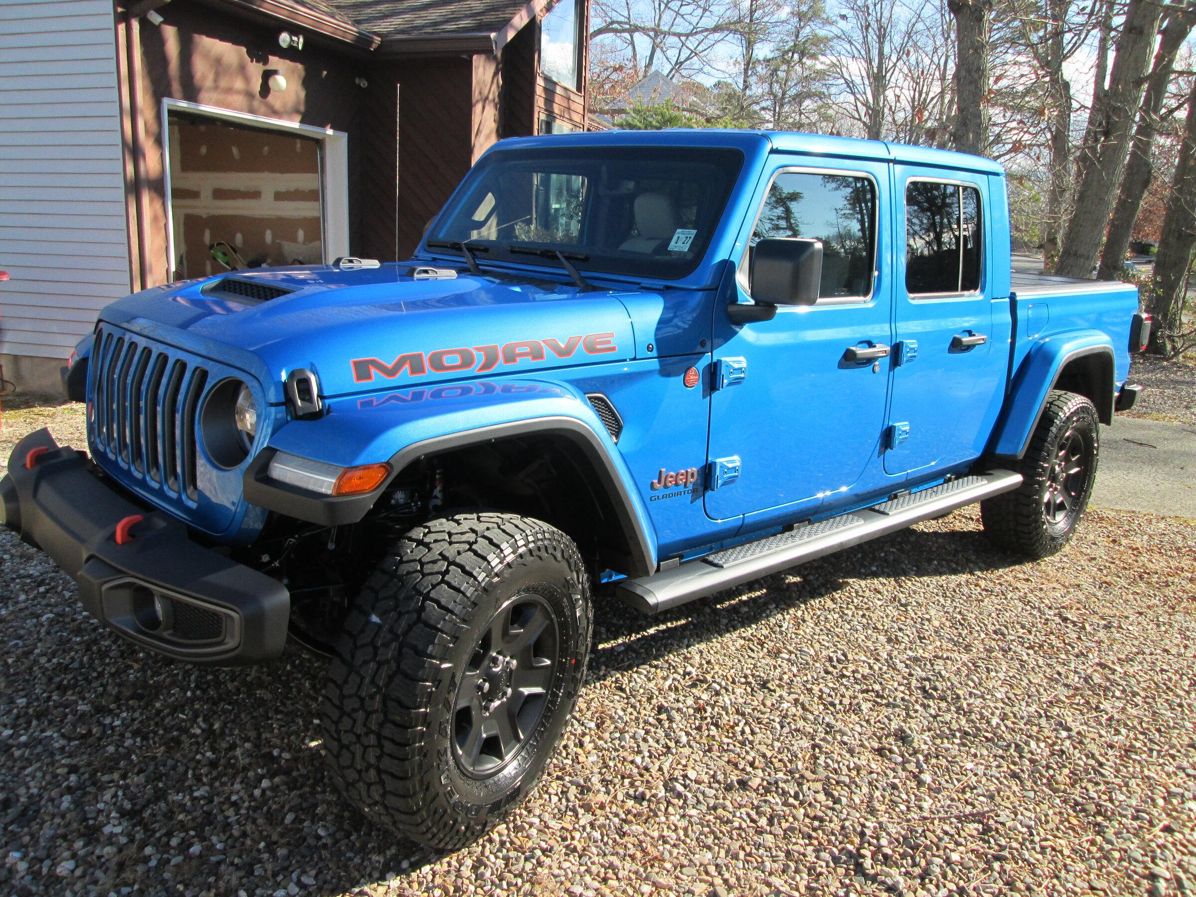

Hi folks, just got my Mojave a few days ago....Absolutely love it!...Only issue is getting it to go into 4WD-Low...Some times it will go in, sometimes it will not (even when using a lot of force).....Is there a "special" way of getting it to go in 100% of the time?
Thanks,
-Joe
