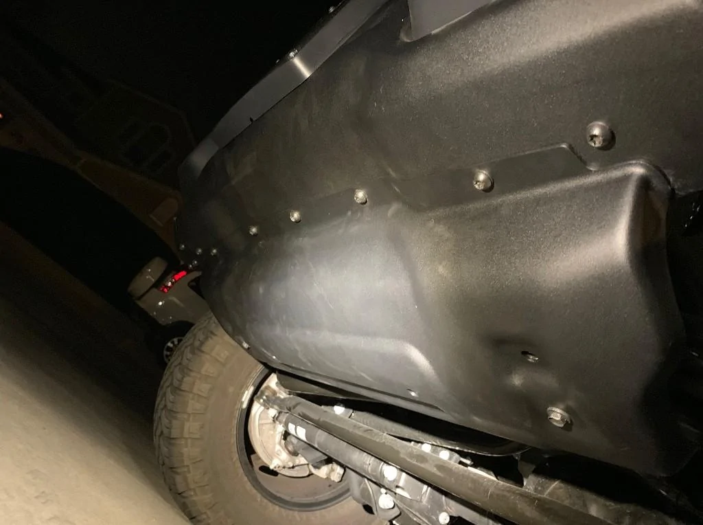

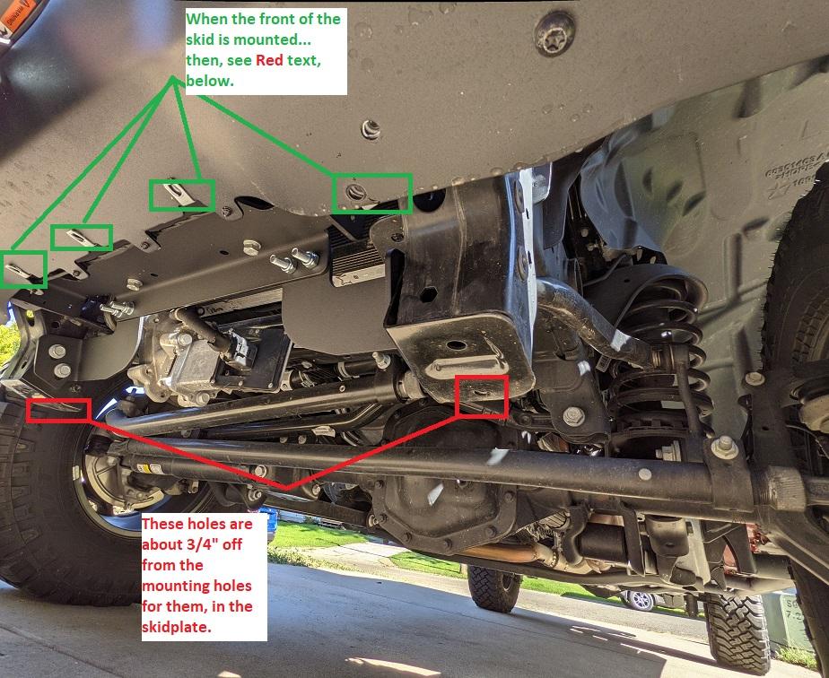

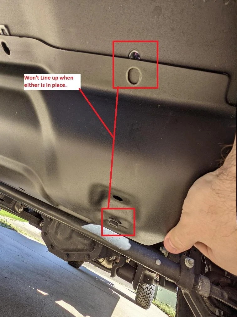

So... parts came in.
Removed the skid, started to mount the brackets.. only to find that they're already installed on there. (literally, same part)
Here's the issue, and I'm up for any suggestions from folks on this:
Jeep Gladiator Rubicon - Plastic bumper to Steel Bumper Conversion PXL_20211016_184338166
When I mount the front holes of the skid plate, to just the bumper, it doesn't align with the rear mounting holes in the brackets. It's just about 3/4" off.
Jeep Gladiator Rubicon - Plastic bumper to Steel Bumper Conversion PXL_20211016_192150451
Considered just drilling the rear mount holes out a bit more, to offset this, and use washers to fill in the gap, or perhaps make the front holes a bit larger.
Maybe I'll loose up the silver bolts the bracket attaches to,to see if there's any wiggle room.. heck, I don't know what to do at this point.
Any suggestions?
Edit: Just found this... looks like this is common... time to get drilling.
https://www.jlwranglerforums.com/forum/threads/question-for-you-warn-winch-installers.60110/
~ Casp

Dremeled out about 1/2" from the skid (horray for titanium drill bits) and it bolted right up, no issues :)
Sorry for the long winded drivel ;)

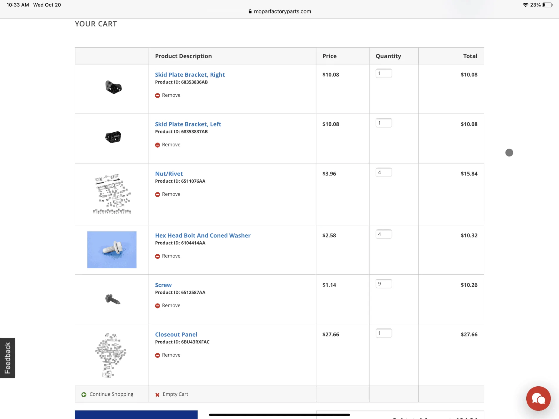

I bought a steel bumper and skid plate take off, and these are the parts that I needed to do the conversion as it did not come with this hardware. Some of you may need the U-clips, however I did not. Hopefully these part numbers help someone who needs the hardware.
Jeep Gladiator Rubicon - Plastic bumper to Steel Bumper Conversion BFF614FC-B633-403C-A785-FDF06120B0A7
