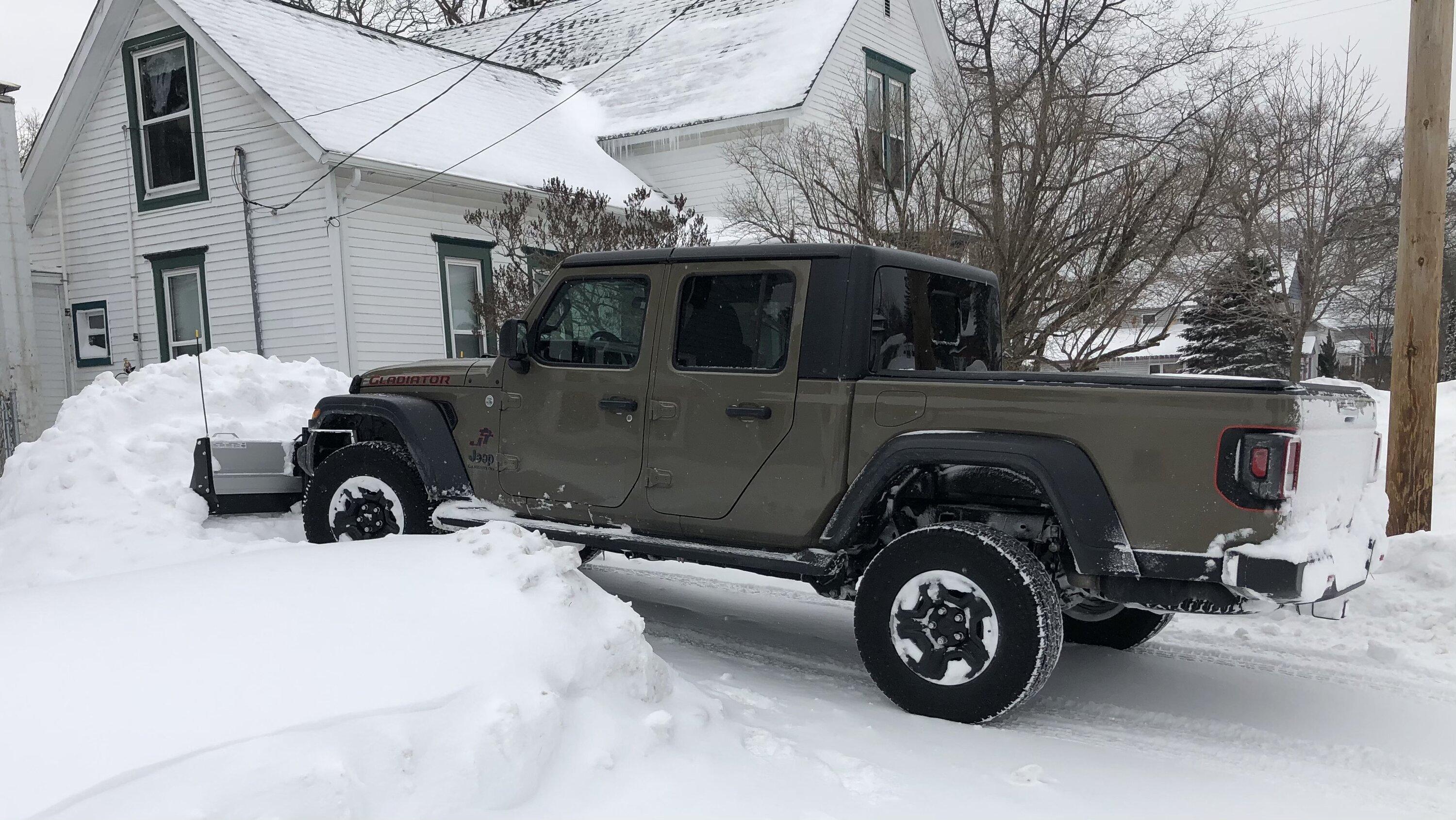

I went through this same process before I bought my plow. It all came down to this. It only stays on long enough to clear the drive and my neighbor. The sag is only temporary and with it being removed so fast there is no long compression of the springs or suspension. Because it’s a floating plow the front only carries it during transport and not while In use.
