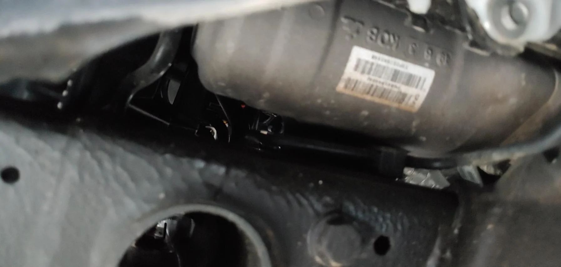

It's the old one unless it's been swapped by a dealer.
New ones weren't used until sometime on the 14th of August 2020.
Look at the thing - is it black? Or sort of gray?
Do the bolts that hold it have nuts on the engine bay side, or not - do the bolts just thread into the holes. Old originals had nuts on the bolts that hold it to the frame. The new ones don't have nuts and the bolts are all 4 the same diameter.
Left front wheel opening, lift up the plastic shield and look above the frame, you'll see the steering gear - look at the part number.
This is the OLD aluminum one -

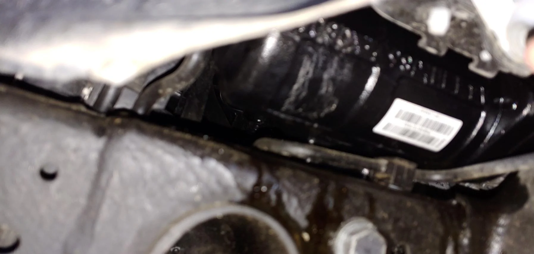

This is the new replacement - semi-gloss BLACK
Jeep Gladiator TSB Steering Gear Boxes Are On National Backorder 20200904_110430
