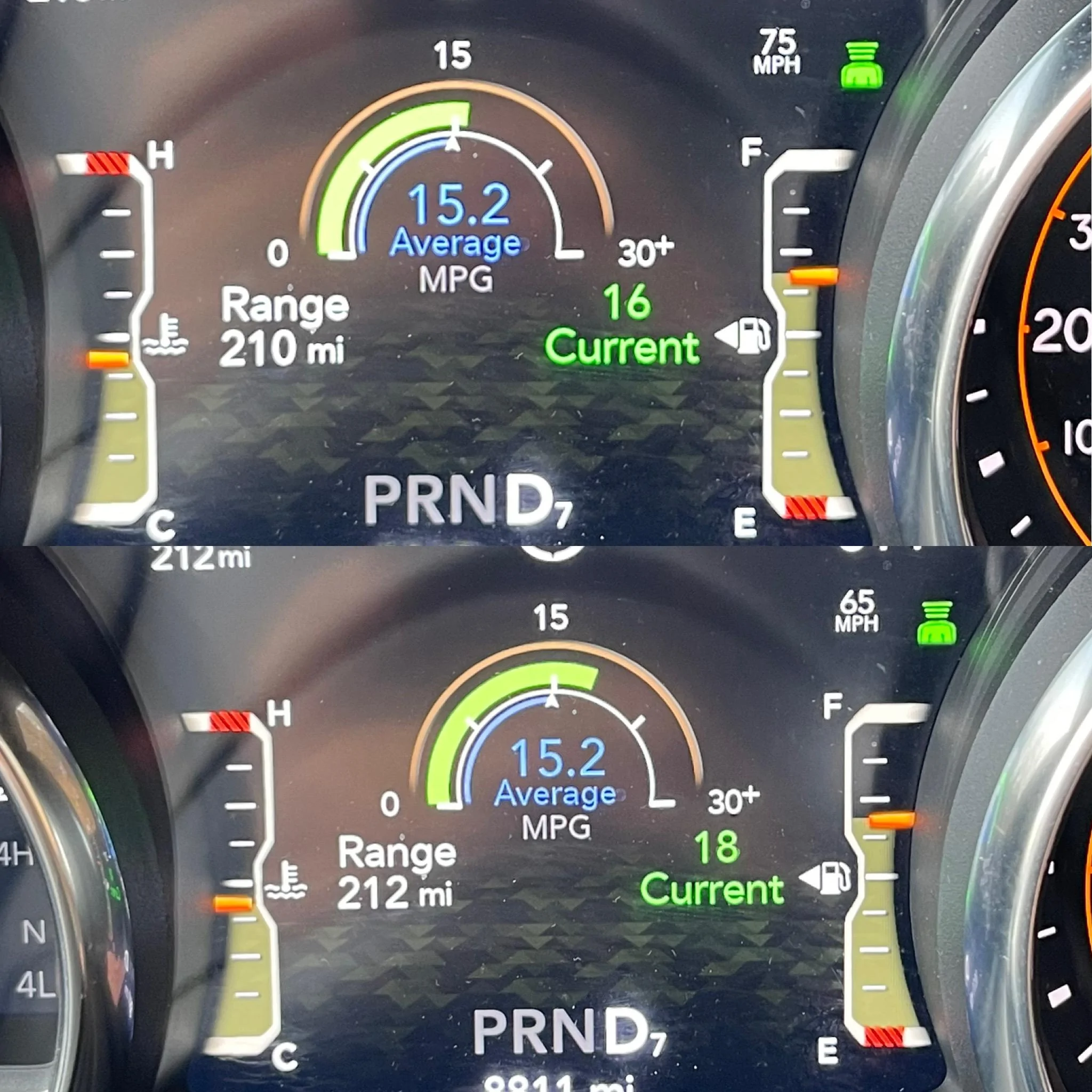

Little experiment today. Almost impossible to be accurate but I did the best I could. Calm wind day on an open freeway 36° outside. It’s sea level here but never flat. It’s usually up or down a 2% grade constantly so flat, but not flat enough for accuracy. Found a couple stretches that stayed flat long enough for it to stabilize. Each was +-1mpg bouncing back and forth. Experiment only shows difference between 65mph and 75.
My experience shows you'll see a greater difference for the duration of a full tank, so your numbers should improve.
Calm? We are expecting 70 mph+ winds later today. IHP, and other entities are warning drivers - stay clear of the big rigs and any other high profile vehicles. And I have an appointment 30 minutes away later today - will be testing my truck once again against record winds.
Anyway, one thing I've noticed and EVERY Wrangler, CJ or JT owner already knows this - wind speed has a huge impact. I can drive a road with the wind at about 10 mph out of the SW and get maybe 19 mpg - and on the way back get over 20. And the only difference - is that bit of wind. And the road I'm talking about is a N-S road so even that SW wind has an impact.
