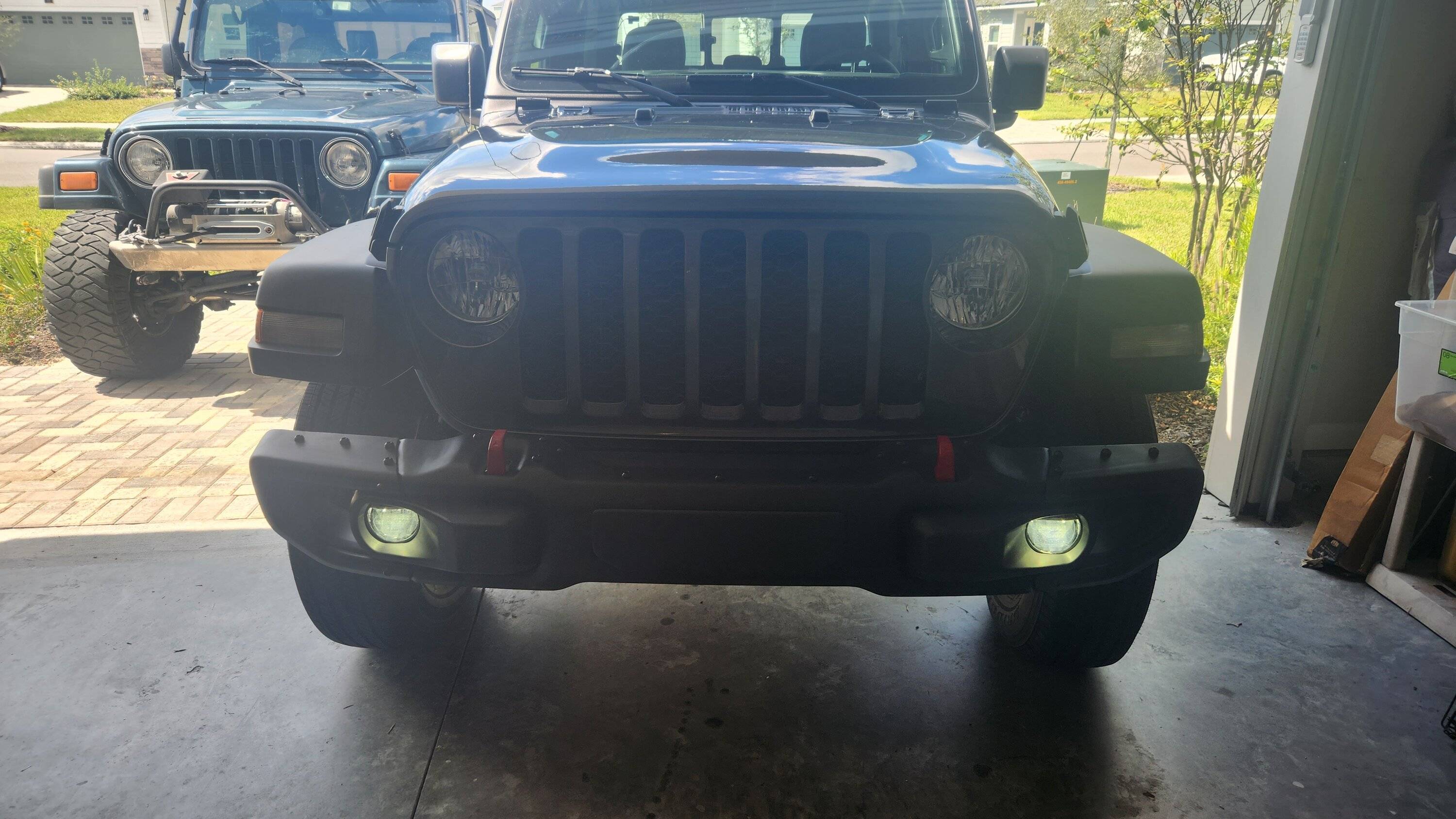

My 23 sport has Hallogen lighting all the way around. I installed a Mopar Steel bumper that was a takeoff with stock LED fog lights. Programmed the Fogs to be DRL and to not drop out with highbeam with AlfaOBD. It was all in programming. Wasn't able to find any topics on this.
Program
DRL Location to fog
LED Fog to Yes
Fog DRL to Yes

From what I've read, it's about a rule that you can't have more than 4 forward facing lights on the roads at one time. The old days when standard US lighting had crap cutoffs, they limit the amount of light that was allowed to be produced facing forward. Example would be a vehicle that has separate low beams and high beams when High beams are on along with low beams, fogs would make it too many lights and too much light. It's antiquated rules from nanny states.
DRL - Daytime Running Lights
AlfaOBD - Software to modify settings. Supposed to be much more advanced than Jscan or Tazer. I haven't used the other 2. Tazer too expensive, jscan marrys to vehicle. I have 3 jeeps. $50 license works with as many vehicles as you want, unlike jscan. Currently using with my old obd2 scanner that I picked up for $20 5 years ago. Haven't needed the expensive obd readers yet. just the 12+8 adapter for $15.

Fog lights are designed to put a lot of light low in front of the vehicle to aid in navigation during poor driving conditions (primarily fog and storms). High beams are designed to throw the light out as far as possible to aid in long-distance visibility. Having the fog lights and high beams on at the same time makes it hard to focus out and pick up movement and objects in the distance with the fog lights putting a lot of light right in front of the vehicle. Having fog lights on with high beams creates a safety issue for the driver.
