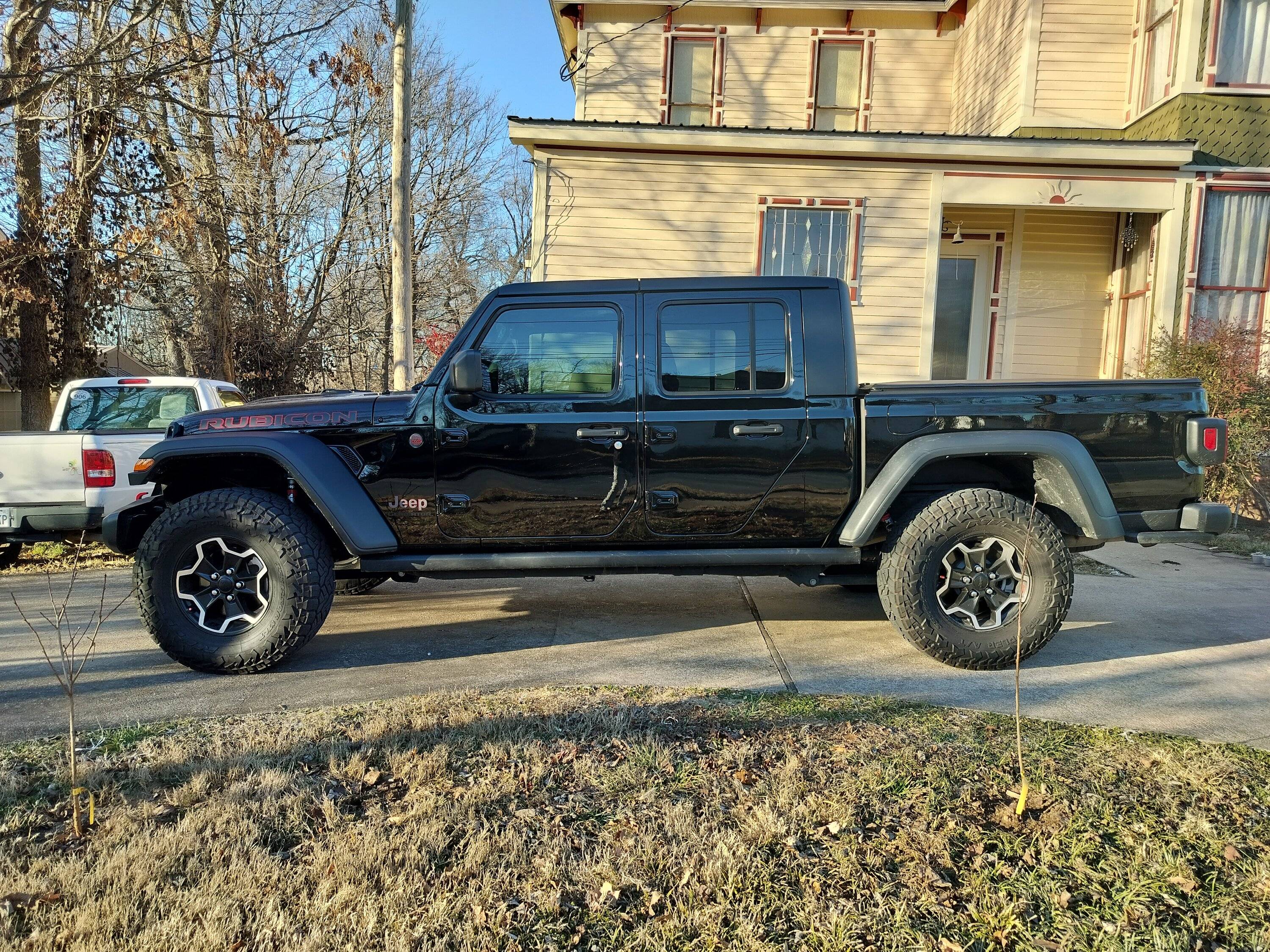

De-lifted:
Jeep Gladiator Un-lift a Rough Country lift IMG20240213165354
Looks more in balance to me. Plus, I swear I'm getting a 2 mpg increase.

It does look great and your mpg increase may be accurate. After installing the lift on mine it dropped about 2 mpg. Can you tell much difference in the ride now? I've heard a lot of negatives about RC lifts but never experianced it myself.
