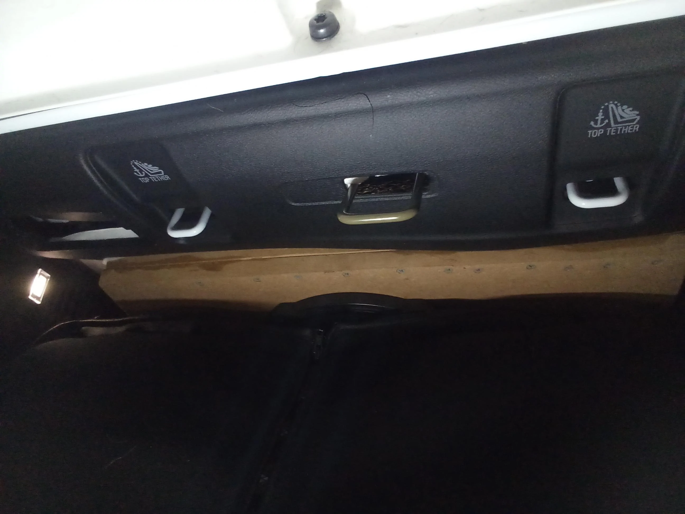

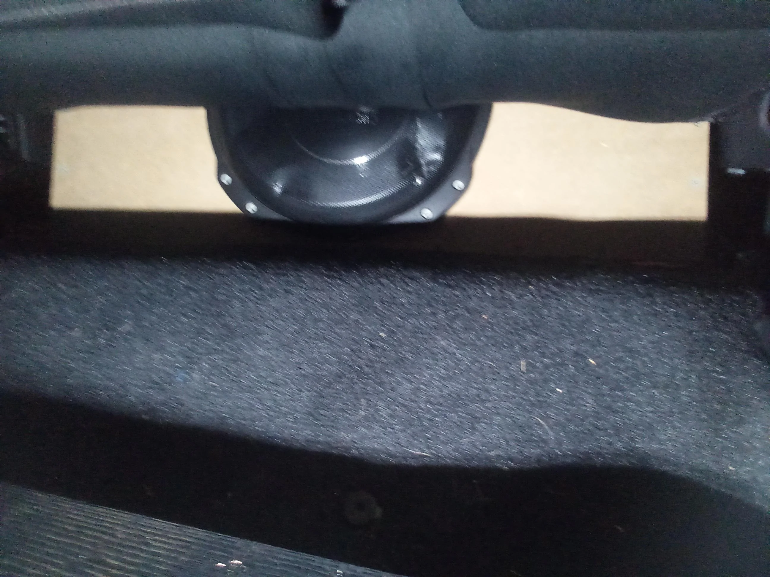

I have changed everything except the head unit, pods in the dash with 6.5 Infinity, plate adapters in the sound bar with 6.5 Infinity as well. Made brackets for the dash and put Rockford tweets, built a behind the seat box with a JL 10tw3. All JL amps, don't remember what I used to get the RCA out, it plugs into the stereo like the pedal commander would and I retained all of my cross path and reverse beeps and Bluetooth functions as well front, rear and sw rca's.

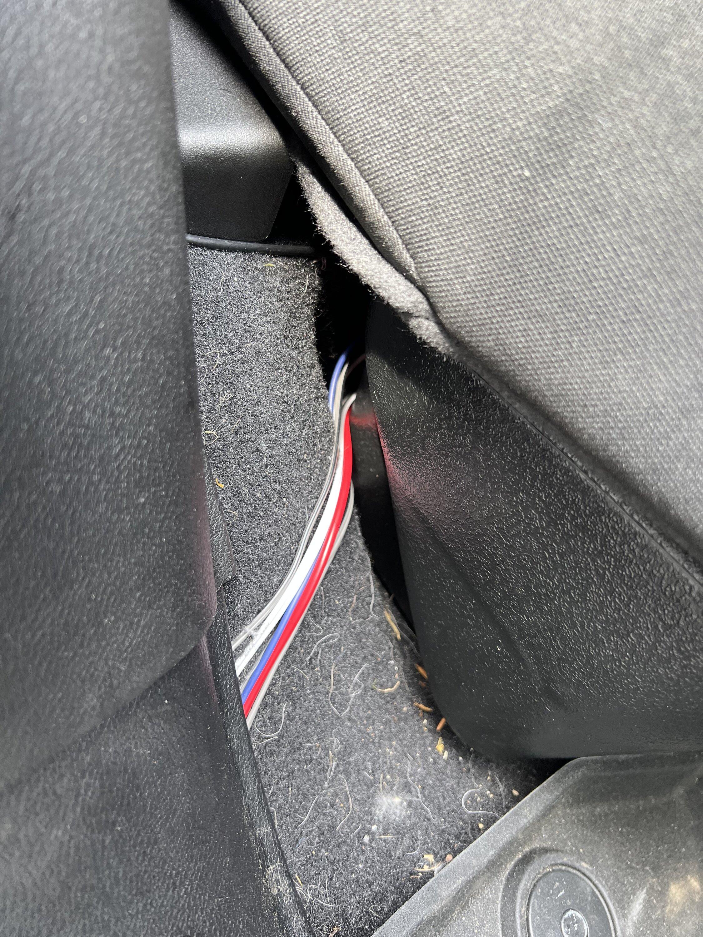

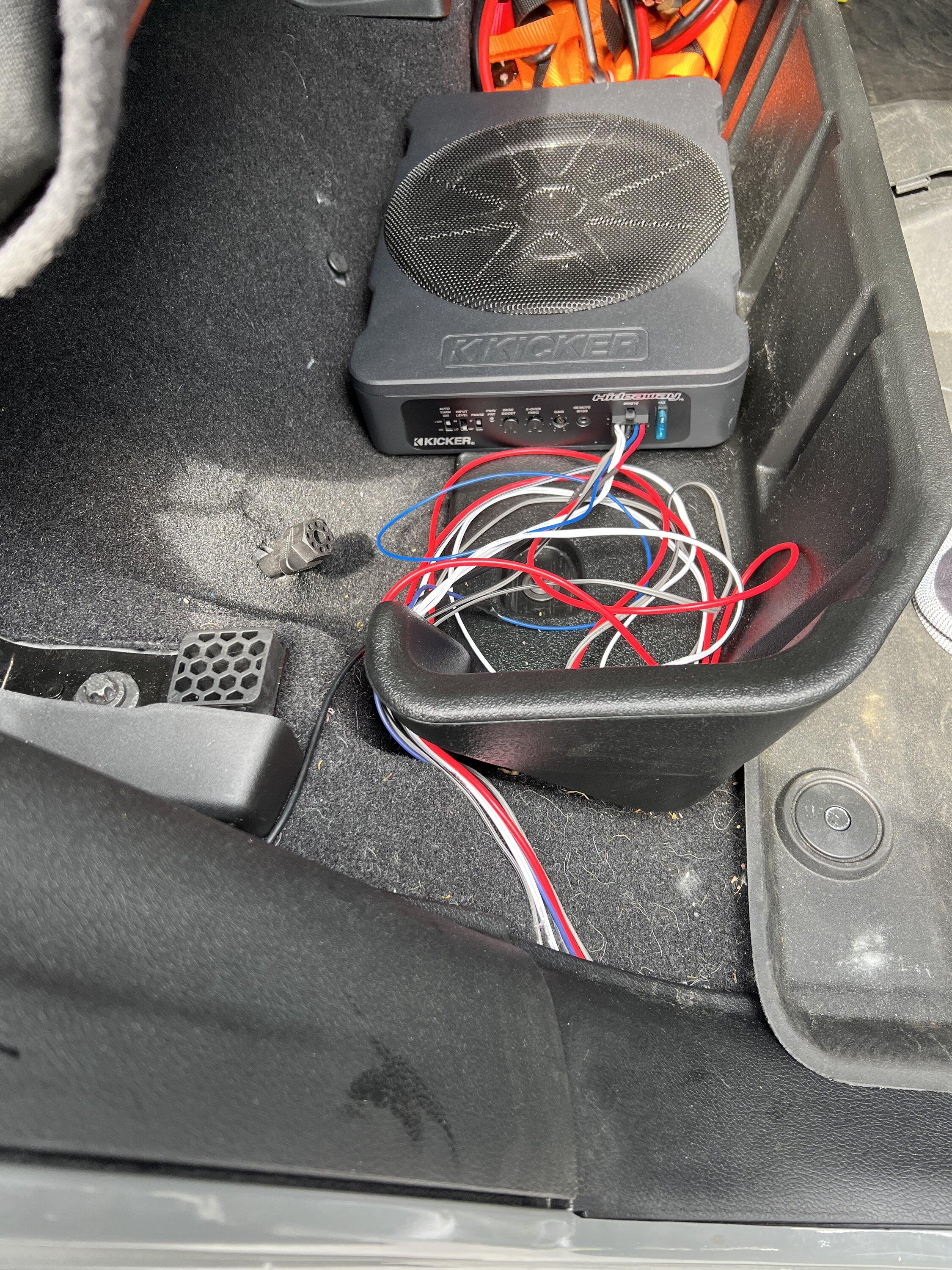

Upgraded from a 7 inch to a 8.4 uconnect. Upgraded the dash and sound bar speakers to Dodge Dart tweeters
https://www.amazon.com/gp/aw/d/B008I2UYPI?psc=1&ref=ppx_pop_mob_b_asin_title
Under back seat installed a kicker HS10 hideaway.
https://www.amazon.com/gp/aw/d/B083M9HR4D?psc=1&ref=ppx_pop_mob_b_asin_title
The amp was a pita getting grounded for some reason.
This system seriously booms now. About $500 in stereo upgrades. Night and day difference from before.
Do you have a pic of the sub install ?
Jeepaholic
Jason
Aug 6, 2019
91
213
Lancaster, Pa
Do you have a pic of the sub box/install?
