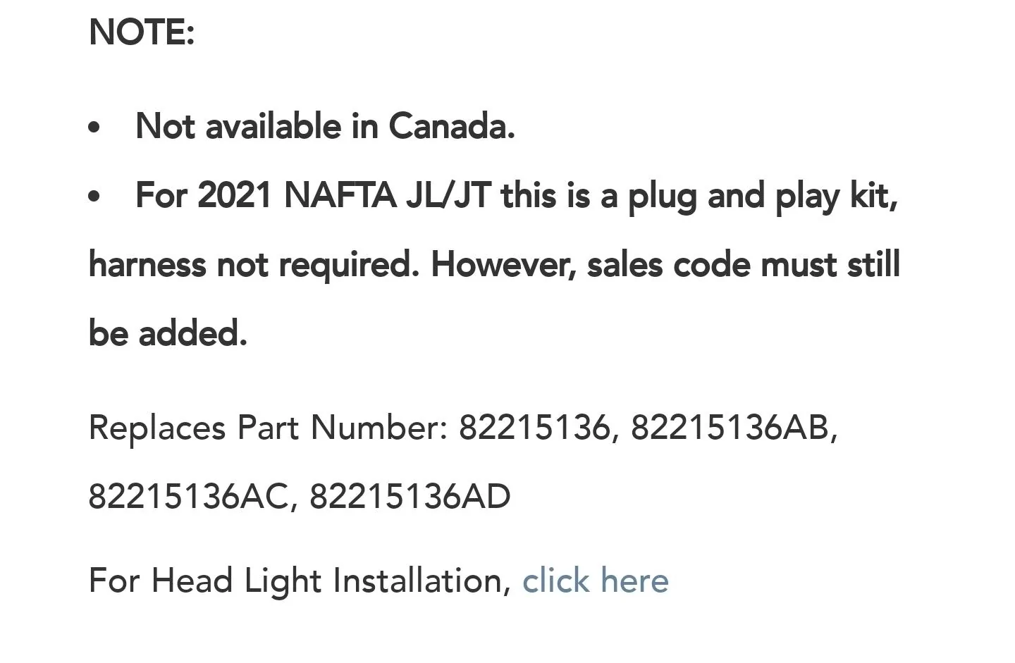

Upgrading headlights fron Halogen to OEM led lights it has been quite difficult to find the Mopar wiring harness, any suggestions?

Anyones know a generic wire brand? Other options

Why not just hook into the harness attached to the headlights?

The actual connector I believe it is for three wires and I need the extra wire harness for the halo…

2021 Sport S

2021 Sport S
You have the halo wire already there if this is a NAFTA truck ( US ). Harness isn't needed. All you need is the lights and either a dealer flash or programmer.

Yep, OEM LEDs use a different wiring harness. I'm not sure how much of that has to be replaced or how difficult it is. You might be able to find an adapter of some sort.
2020s do. 2021 have the same harness.

Thanks for the info. I am installing the headlights soon and I will have them reflash…

I went halogen on my 2020 to save money. Regretted mid build but to late to modify. Ended up getting a pair of takeoff OEM LEDs and needed a way to power the halos. Found this on eBay. Worked perfectly. Just grabbed a fuse tap and ran the extra wire to my cigarette adapter fuse. Have been using for over two years and no issues. Looks and acts factory.
https://www.ebay.com/itm/334397096406?hash=item4ddb9ec1d6:g:VvQAAOSwHGFcYHlE
Hope this helps!

Anyone knows if the headlights supposed to turn on without reflashing? Not the halo, the regular low light.
