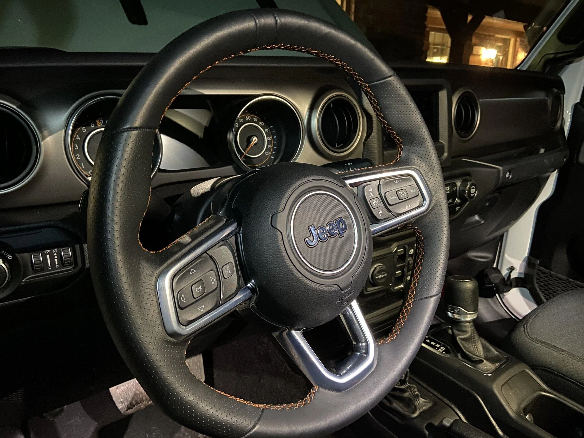

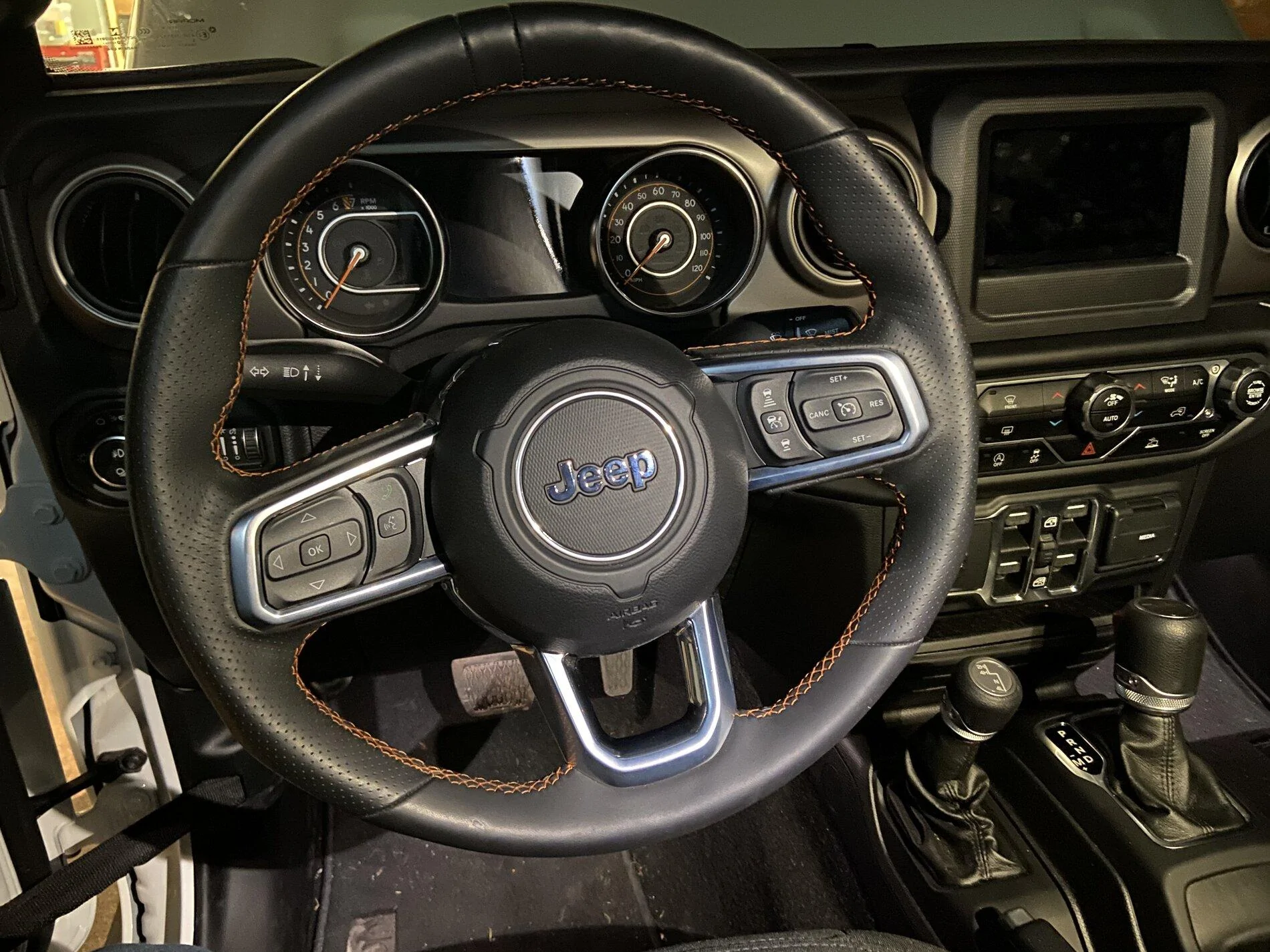

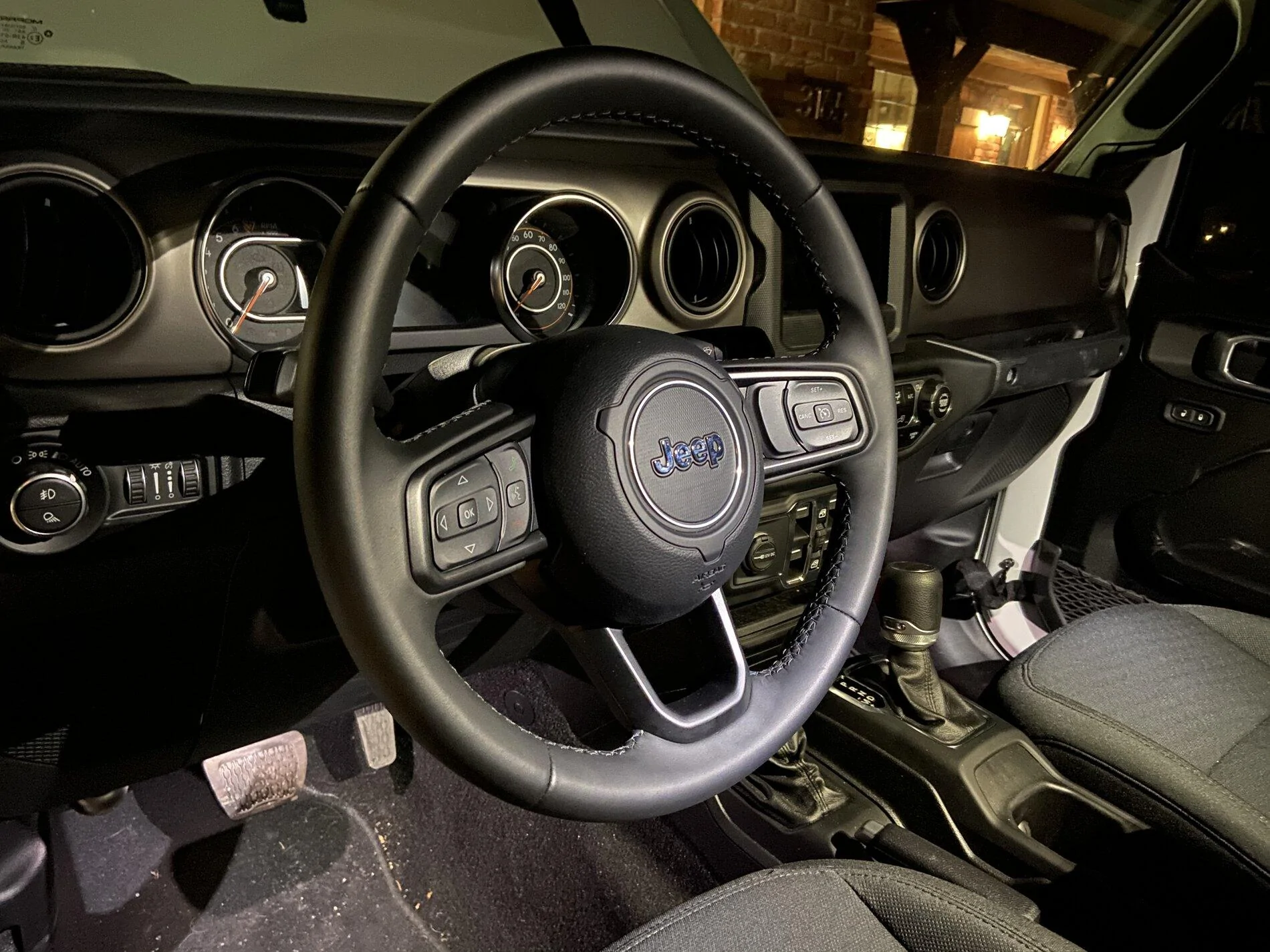

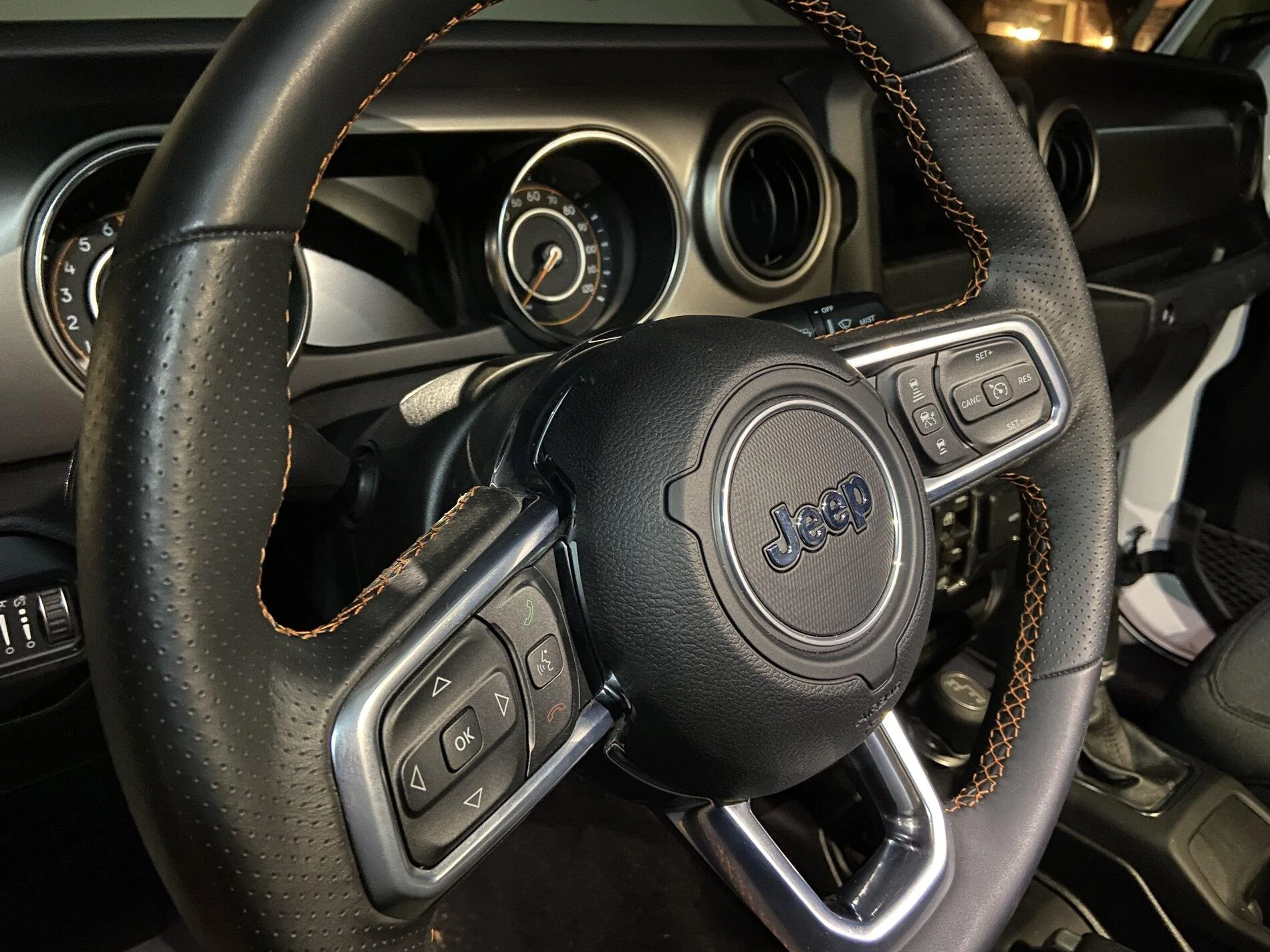

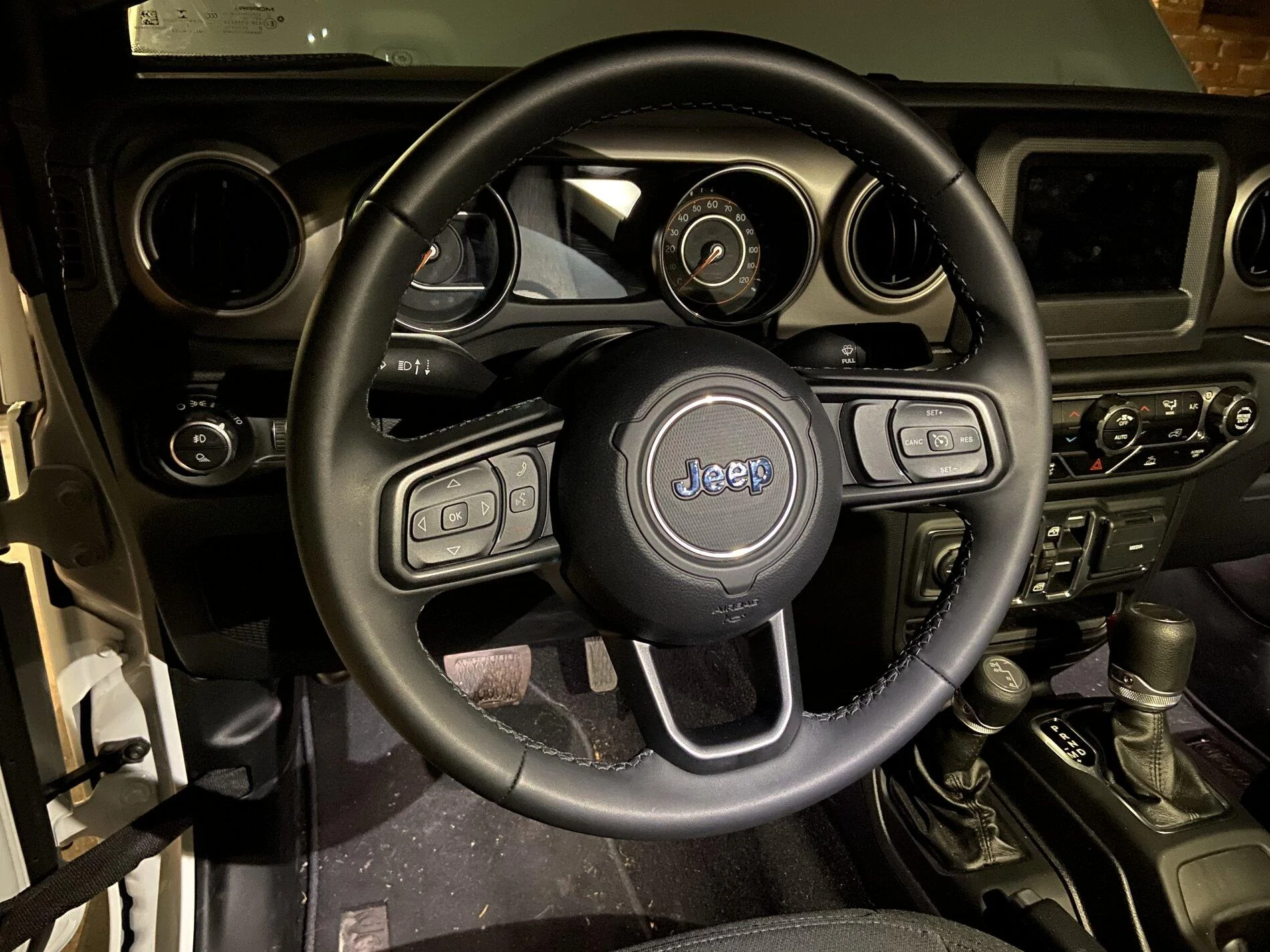

I just upgraded my steering wheel to the Mojave tonight.
very nice look. im thinkong about the same but with a 392 wheel to have also the shifter paddle. could be amazing.
Congratulations i really love the result
