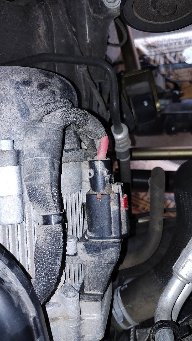

FWIW, here's mine (2021) looking down sans airbox. Seems my harness is a little shorted than others...
Jeep Gladiator US investigating 781K Jeeps over underhood fire reports (Wrangler & Gladiator) -- power steering pump electrical connector issue IMG_20240911_130936048

I plan on wrapping the high power cables with better material than factory after seeing this.. I did this with the wiring harness next to the DPF on the diesels that seem to give problems just to prevent it from giving me electrical issues in the future as I plan on keeping the truck for a while and don’t care to have the dealer touch it. I’ll dig into it one of these weekends and get some pictures wrapping the entire cables.
From the vibration and very thin sheath the manufacturer uses Im not surprised to see them shorting out.
I’ve seen this on winch battery cables that aren’t wrapped or routed properly and allowed to vibrate.
That is my thought. I was thinking about taking some rubber fuel line or heater hose (what ever is the right ID) sliting it length wise and wrapping it over the wires where they are close to parts. Then use some zip ties to keep the hose closed and in place.
It takes a lot to chaffe through a 1/8" rubber hose.
