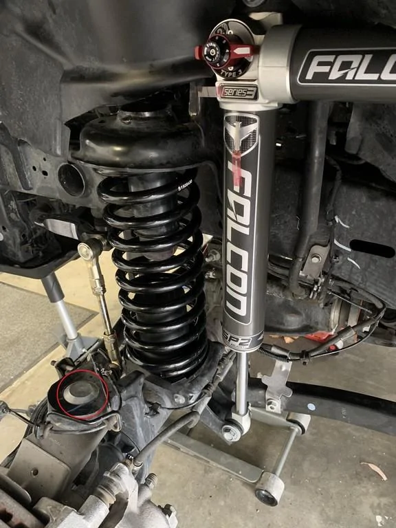

I've watched some youtube and read articles but I feel nothing actually describes where to take these measurements.
I installed the Mopar 2" lift myself and had the TSB work done then added 37s. Life was great until I added the Teraflex 1.5" level to the front and now I have a crazy hard pull to the right. I also have an adjustable track bar and the axle is centered.
I picked up an angle finder, the gauge style with the magnet but I don't know where to measure. My toe was roughly 1/8th" toe in last I measured but I'm sure the angles are trash since the level install. I am assuming I will need at minimum adjustable LCAs but I want to see how bad the angles are first.
Thanks in advance!

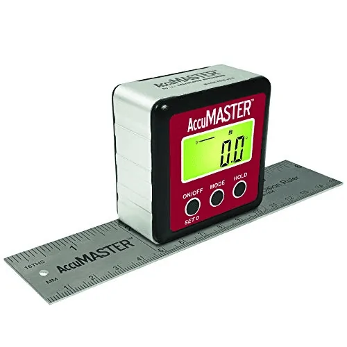

Hello, I measure my caster with this instrument. It is digital and it has a hold button. It is magnetic, so, you just put it on the top of your "C" on each side and use the hold button to save the reading. See pic with "red circle". You need to be on level ground, with the tires on, at rest. You can also use the supplied ruler with the angle instrument to try to figure out any slope to the ground you are on and subtract or add to the reading. This process will get you an accurate reading. Note my caster is around 5.8 and it is perfect for my truck.
Jeep Gladiator School me on suspension angles 1613314795904
Jeep Gladiator School me on suspension angles AKSac1

Hello, I measure my caster with this instrument. It is digital and it has a hold button. It is magnetic, so, you just put it on the top of your "C" on each side and use the hold button to save the reading. See pic with "red circle". You need to be on level ground, with the tires on, at rest. You can also used the supplied ruler with the angle instrument to try to figure out any slope to the ground you are on and subtract or add to the reading. This process will get you an accurate reading. Note my caster is around 5.8 and it is perfect for my truck.
Thanks for the info. That's interesting, I thought 5.8 would be too low for these? When I was taking measurements I was around 7 degrees and my alignment wasn't bad when I had it put on the rack. Damn nice shocks also!
I took the reading at the flatest gas station around, but, I did not try to account for their slope. I installed the Clayton 3.5 inch kit with all the control arms set perfectly to their specs, so, they probably shoot for approx. 6 deg. of caster - which would be perfect I believe.
