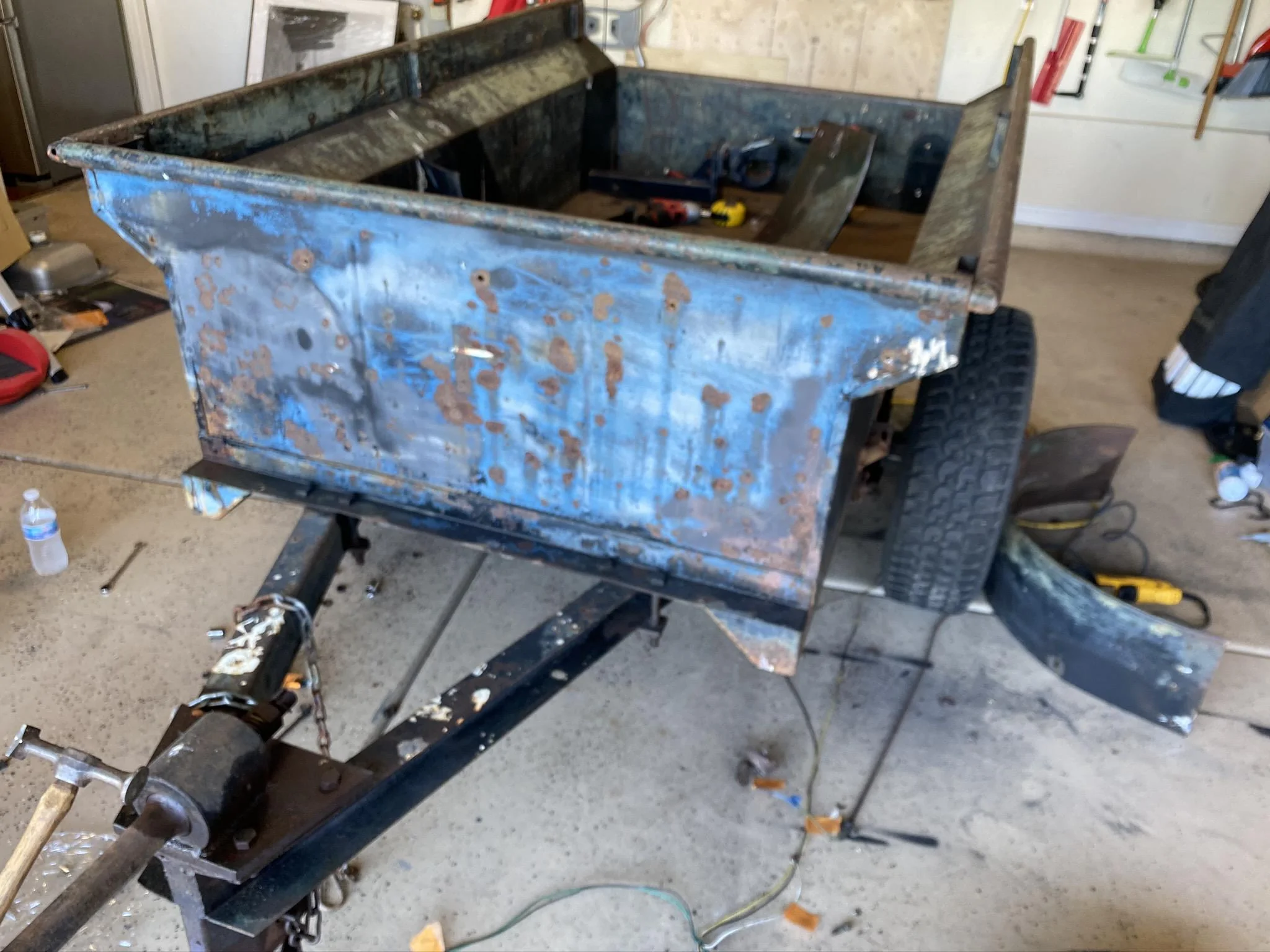

When I was building mine (m101), I just bought a new axel. Then I was able to order the width that I wanted, lug pattern, electronic brakes and the parking break. I even ordered it flipped with new leaf springs.
