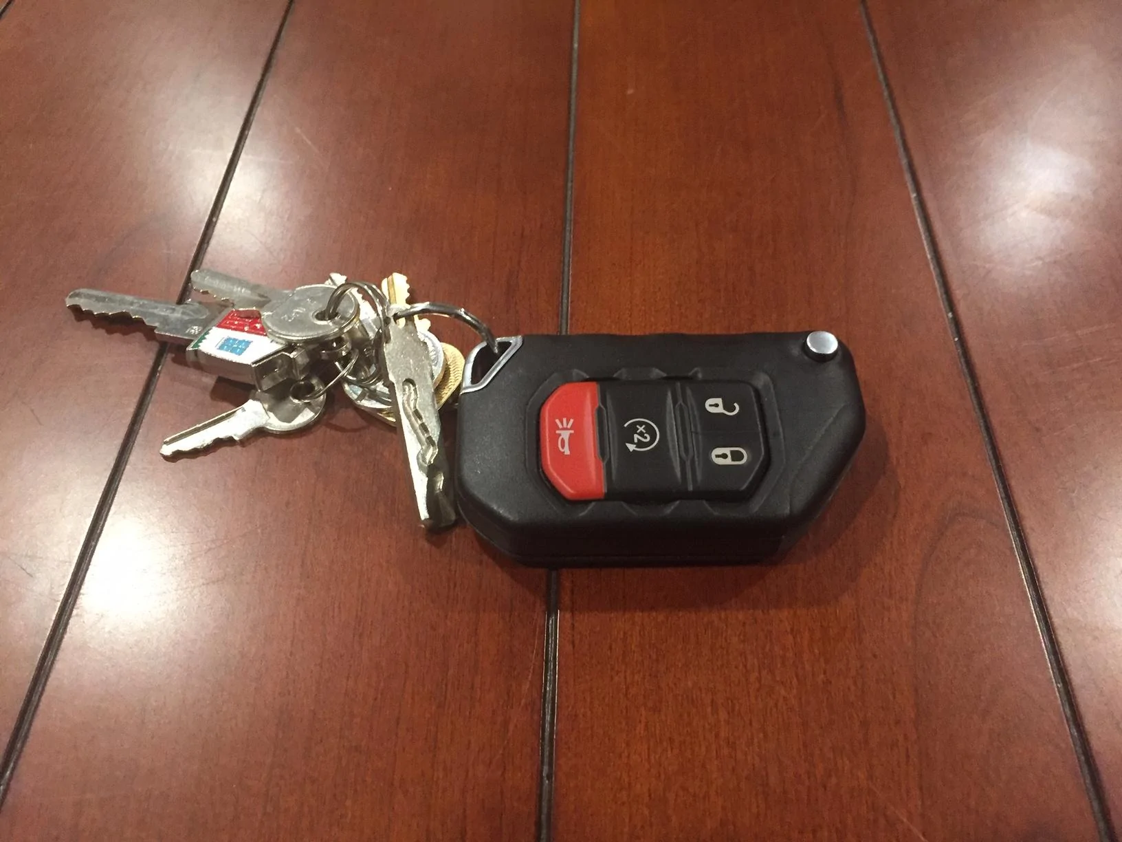

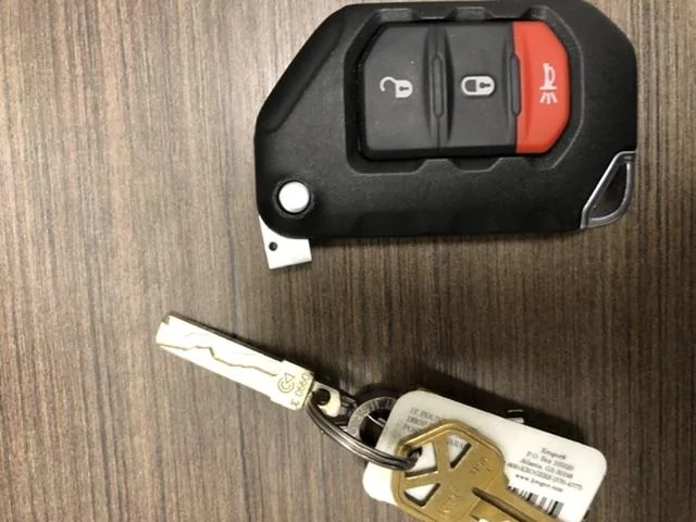

My wife and I met our daughter and son-in-law for dinner over the holidays. I was surprised to discover it was Valet parking only. Since I had a pistol in the console that I didn’t intend to take in with me I had to drop her off and park down the street a bit. Got me thinking on how utterly useless the little switchblade key is when you have to leave the key fob with a stranger. This would also apply to service departments. So I resolved to find a cure. I noticed that the switchblade key is held in the fob with a tiny roll pin. I tapped that out, pulled the key out and drilled a small hole so that I could just keep it on my regular key ring.
Jeep Gladiator Valet Security 5BA156D4-7D7E-4312-B896-B8FA493C415F
Now I can lock the console or rear seat backs and be reasonably secure in these situations.

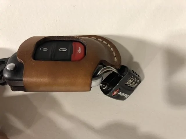

Part 2
Later I thought of an even easier solution. I use the Gibson Leatherworks key fob holster. I normally have my gym stuff in the Jeep and I discovered that I could use the same lock that I use at the gym to secure the switchblade key in the Gibson holster like this:
Jeep Gladiator Valet Security 8666EE61-BF3C-412D-86C5-006CABAA8F2C
has anyone else figured a good way to secure the console short of buying the Tuffy locking lid? I didn’t want to go that route because I’m using one of those nifty tray inserts and like it a lot.

WOW, hadn't thought of that! Ouch.
Great solution.
Silly that Jeep didn't think about things in the glove box, console or back of the seats that you didn't want even a dealer or other service department - or worse, a valet of all things, to have access to! Just wow.
I hated the switch-blade key thing from day one and I find it keeps opening when I don't want it to - just a touch to the button, maybe it hits the other keys or tape measure in a pocket, whatever, there's that thing jabbing where you prefer not to be jabbed with a key.

...So I resolved to find a cure. I noticed that the switchblade key is held in the fob with a tiny roll pin. I tapped that out, pulled the key out and drilled a small hole so that I could just keep it on my regular key ring.
This was a perfect solution for me, and I followed suit.

Nope. The glove box, console and rear seat backs all lock with the switchblade key that is part of the key fob. So if you use a valet, drop the truck for service or loan it to someone you cannot secure your personal stuff. You can lock it all up with the key but then you gotta hand over the key because it is integral with the fob. Kinda shot sighted. If you remove the key from the fob and attach it to your regular key ring as described here you will not have to hand over the key unless you want to.
