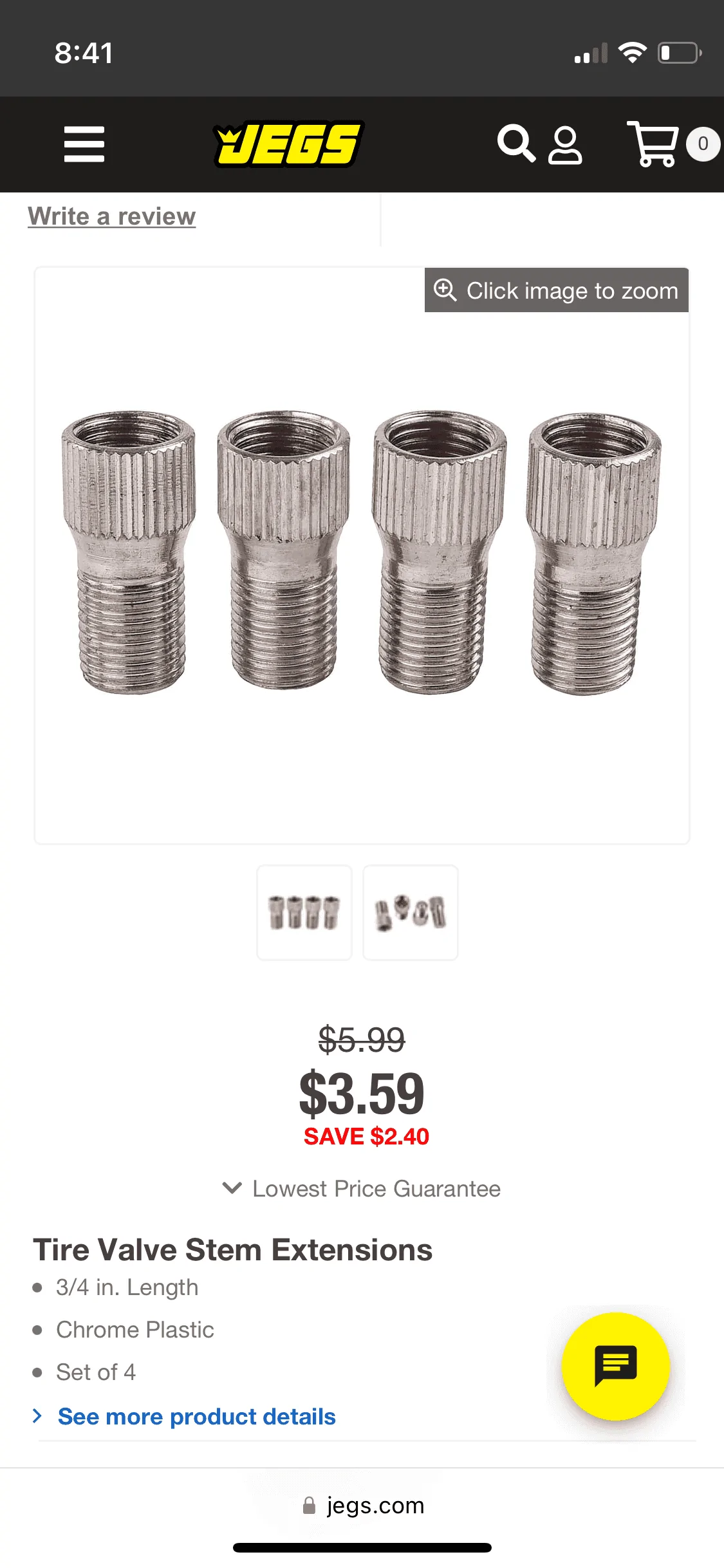

pics would be helpful… is there enough thread left to put a valve stem extension on? Maybe some Teflon tape to help seal the bad threads.
AmishMike
Michael
Jul 29, 2020
64
1,817
4,213
Central Pa
Whipping boy
I second @Gatorized valve stem extensions for now. New stems or whole sensors at next tire change.
Most parts stores will have some version on the shelf, metal or plastic. These are nice and short though-
