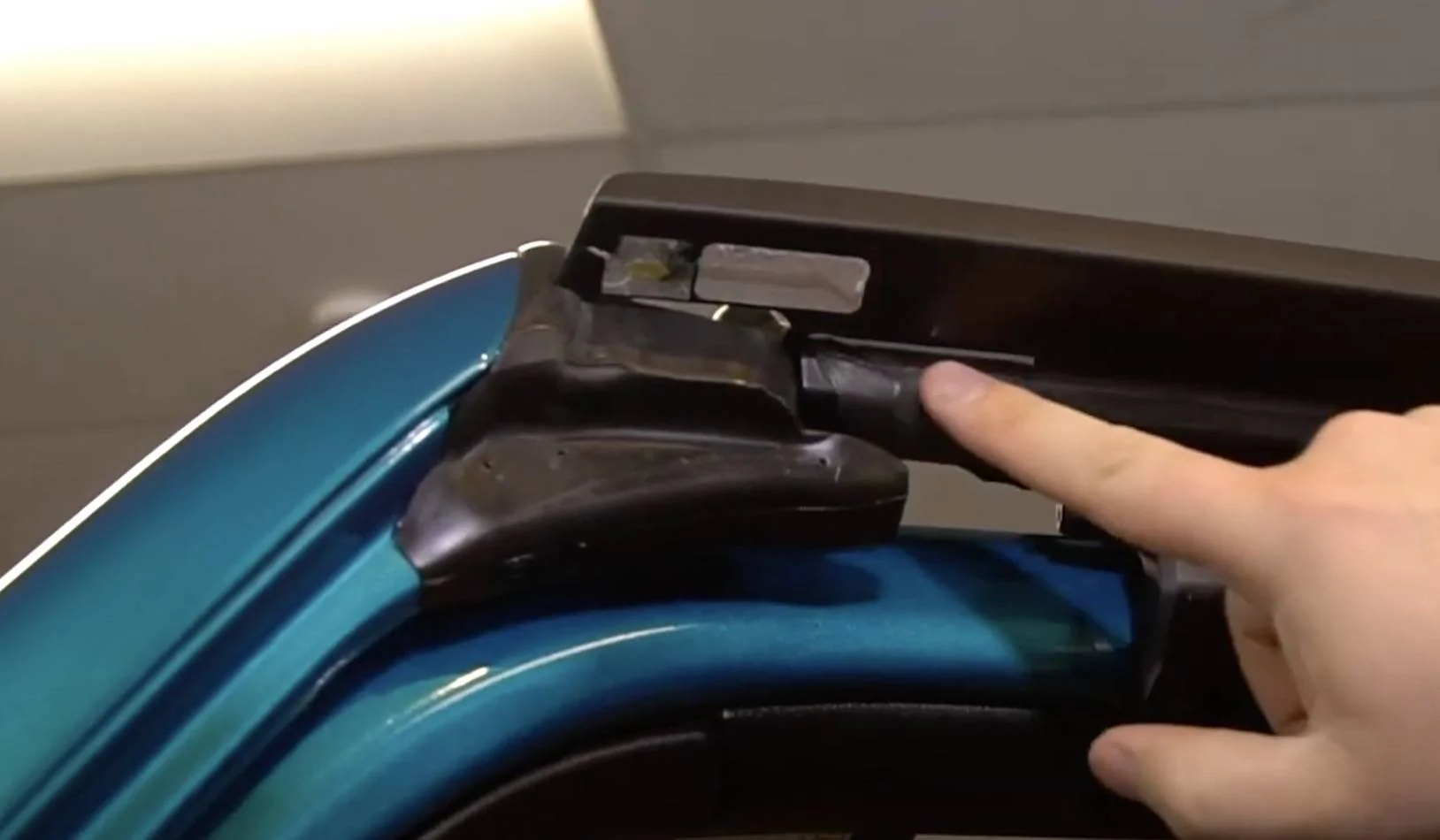

Glad to see this question pop up. The flap on my '23 is also on the outside, seems to pinch and offer little benefit when closing the door. Noticed when raining that flap really drops more water inside than even the usual annoying amount. The other frustration was watching the install videos to save time with the z clip process by installing the side brackets first, then to discover they changed to a loop and screw w/loctite setup. It is a better setup, and thats what I get for skipping the printed directions.
Interesting that almost no one brings this up in the videos. Early videos, where the Sunrider rails fit into a rubber channel do mention the topic, but not later ones. Just watched a few more videos, and it's almost even between pushing that rubber behind the rail or letting it rest on the outside.
For example . . . grabbed from a video:
Jeep Gladiator Very quick question about Sunrider install grab291

Here is a response from Bestop: "The door rail should sit inside the mucket seal, if the seal is pinched it will cause the top to leak. "
Still not sure what is best, but would be interested to see how a few more have handled this.

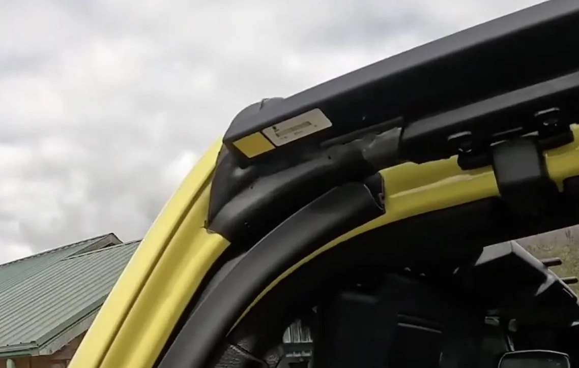

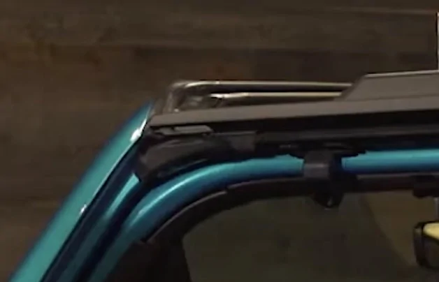

OK, last post for those that might be interested in the future. I think the weatherstrip design has changed since Bestop came out with the instructions. Here are a couple clips from their installation on a JT a few years ago. Note that the flap causing the flap (sorry!) is not evident.
Jeep Gladiator Very quick question about Sunrider install grab292
Jeep Gladiator Very quick question about Sunrider install grab294
Just for fun, I looked at my door closed with the rail behind or on top of the flap. Water is going to go the same direction no matter what! In my case if I have the flap on the outside it does not sit flat and the door crunches it, so I will just put it back behind the rail.
