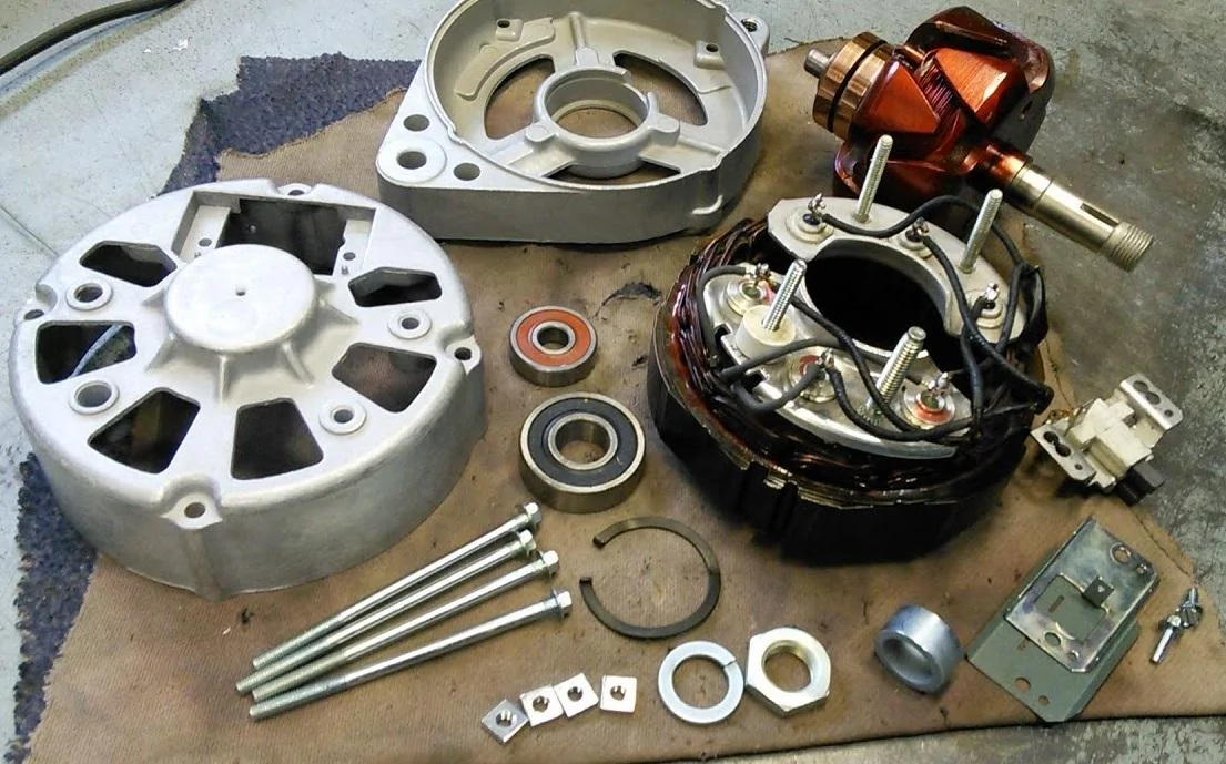

As an automotive professional, experienced, trained, and still doing auto-electric restoration, etc. - yeah, but there's no way we will ever know. Sure, I'd love to have had HANDS-ON that alternator to inspect it, some forensics, diagnostics, not simply say "it's not working, let's replace it". I never do that, never have. Even things sent to me for restoration I will often photograph, make notes, even test things before disassembly.
But there isn't a single thing anyone can do now. The OP has no clue, the dealership I'm sure has long since let the part go out either for reman or warranty inspection by Jeep.
Short? Unlikely. You can get these VERY wet and not destroy them - but this wasn't just plain water on a rainy night blacktop highway splashed up in there.
I know you can get them wet because - well, many of us PRESSURE WASH our engines and engine bay. I do. I pressure washed my entire engine and engine bay before the last show I had my car in - people commented you could eat off the engine, intake or even the exhaust pipes.
I gave it no mercy. I washed it - then rinsed (that's the KEY - RINSE!! plain clean water) and then I started it -still wet.
My other cars - the alternator is mounted down low, it sits above the crankshaft pulley but below the water pump pulley - off to the right in between the two.
Shielding? None, zip, nuttin'. You look at the alternator and you see pavement.
But unless you are really dumb with 'em, all they'll get is wet, not sandy, gritty, no mud, no salt spray. Water, maybe dirty water, but that's it. Nothing that would look like the mud and filth in the OP's picture/video.
Clues as to what really happened can be found in the fact that originally, they were talking radiator. Wow, sounds like maybe it was really plugged up with muck or something. Another dealer, no, but the first, yeah - so how does a radiator get mucked up that bad - don't concentrate on the alternator so much, clues lie elsewhere. It's a far far bigger picture, you have to treat it like a puzzle, a problem to solve, a who-dun-it and read beyond the post and pictures.
Based on video, pictures, and the comments on radiator as well as alternator - those things took a hell of a hit.
ANYTHING anyone says here is pure 100% unadulterated speculation, opinion, some based on logic, some on emotion, I like to think mine is based at least in part on experience and skill.
No one here knows all the facts and that's the truth of it.
If I were an ornery dealer - i could say - geesh, this thing was in a battle - signs of water and muck waaay up high, radiator plugged, not running, not charging - likely many other electrical bugs will show up soon. I'd say it looks like it has been sitting next to the mississippi in the floods of 93.
But then - I did not see the truck, I am basing it off what I do know, as limited as what's been presented to us.

I'm not the only, but for years was the best in Iowa LOL. Still get work sent to me from all around the country. Hobby and pro - differences.
Anyway, odd that things were mentioned that aren't even possible on these things. Starter hung up because of autostart and shorted something? Uh, no.
Voltage regulator? Nope. (and testing is simple)
Seriously, some are treating this as if it was driven on a dirt road with pot holes. It wasn't. It was deep, it was fast. Too much emotion going on and no logic or diagnostic abilities being applied.
Just a lot of "stuff" being tossed at the wall to see what sticks.
We do not know when the alternator actually stopped working - could have been second pass through, then subsequent passes or driving finished things off. But these will warn you if the voltage gets low. Even my 4.0 transplant does that. It started and ran - but told me the voltage was low -triggered MIL.
Custom built for a show car in Texas............ one owner car - I deal with auto-electric daily, starters, alternators, wiper motors, etc. not just backyard shade-tree parts swapping.
Just trying to show I'm using logic and experience, not emotion or pure guess-work here.
