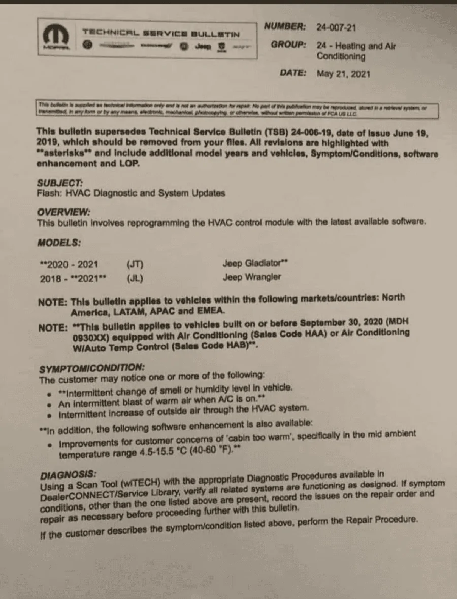

Kinda annoyed…Took my Jeep in due to the known AC issues. Apparently Chrysler voided my warranty because I swapped to 4:88 gears and now I have to pay for them to fix the known AC issue.

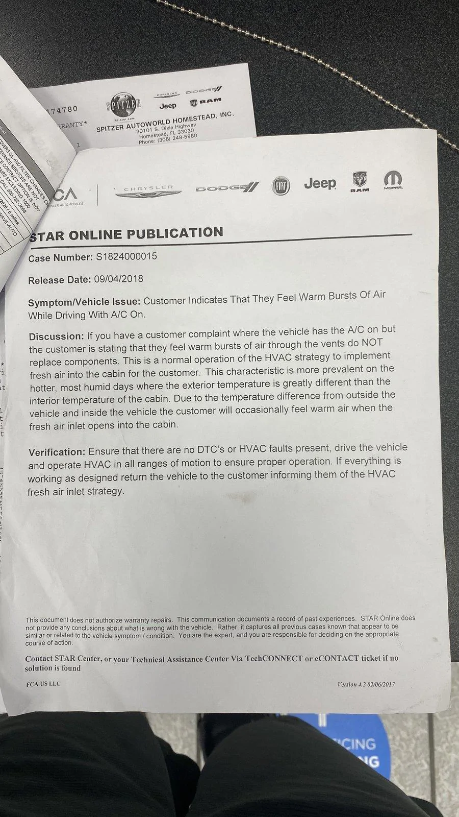

Prior to that it was "inform customer of HVAC fresh air inlet strategy"
I guess their letting fresh air in on long drives to help the customer get fresh air simply pissed 'em off so Jeep decided to let people breathe stale air? HAHA

TSB 24-007-21 says yes. (that's the one earlier in this thread I believe)

Guys - that's the OLD thing - ignore it, this is the NEW one.
Read the LAST LINE. That's what the dealer should do as well - READ THE LAST LINE - it says if customer complains, FIX IT.

@ShadowsPapa, clearly understand, old vs new, I just love how the old one basically says "now lie to the customer with a FCA formulated excuse"

I took my JT to the dealer today for the final wave oil change and tire rotation.
I handed them a copy of the TSB and explained that on longer trips hot humid air comes out the right side for a few seconds and then stops.
But as an added thing - I noticed my wife kept bumping the inside temp down - it would start set at 68 then I saw she had it at 67, then 66 and the other day down to 65. I asked her what was up and she said he wasn't cooling off, she was still hot.
Hmmmmm, doesn't that sort of fit the TSB? Never realized what she was doing and never asked, I guess.
So I asked them to please check.
After they'd done some of the other stuff I had asked - the guy came up and said the tech was wanting to take my truck for a drive and make sure it was ok after the flash.
The kicker - apparently they'd done a lot of those TSBs, as the guy said the tech told him the flash had always taken care of any problems but he still liked to drive them to make sure it worked after the flash and that the flash didn't cause any problems (but added it always worked fine)
On the way home I had to set the temp up to 70 as otherwise it was getting cold in there.
I found a note on my paperwork from the dealer shop:
CLEARED DTC's, 18-50-10-AC
Whatever that number means.
In any case, sounds like they've done TSB 24-007-21 a few times and didn't even balk at it.
