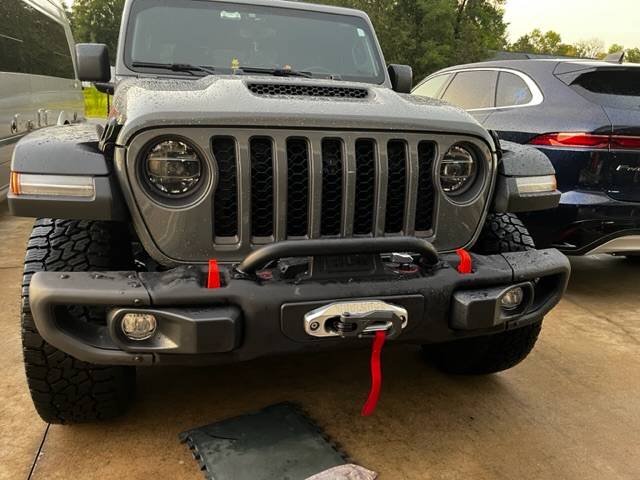

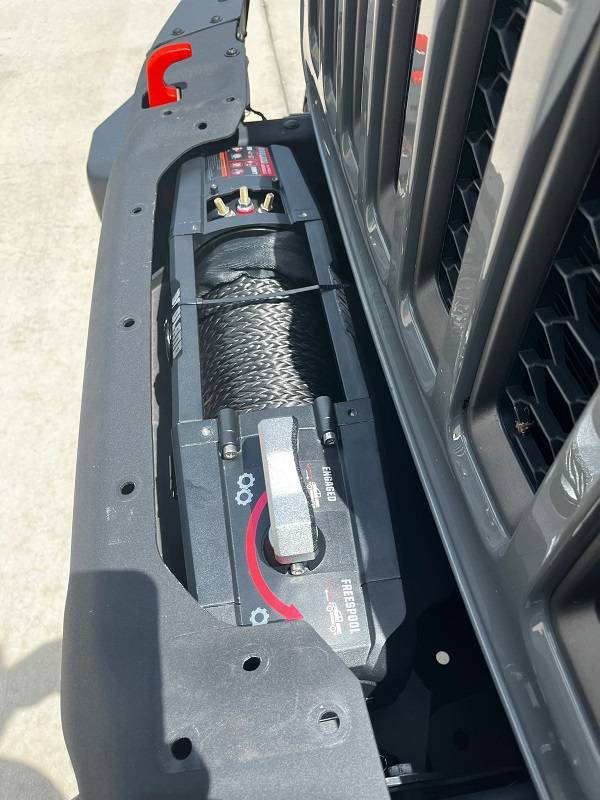

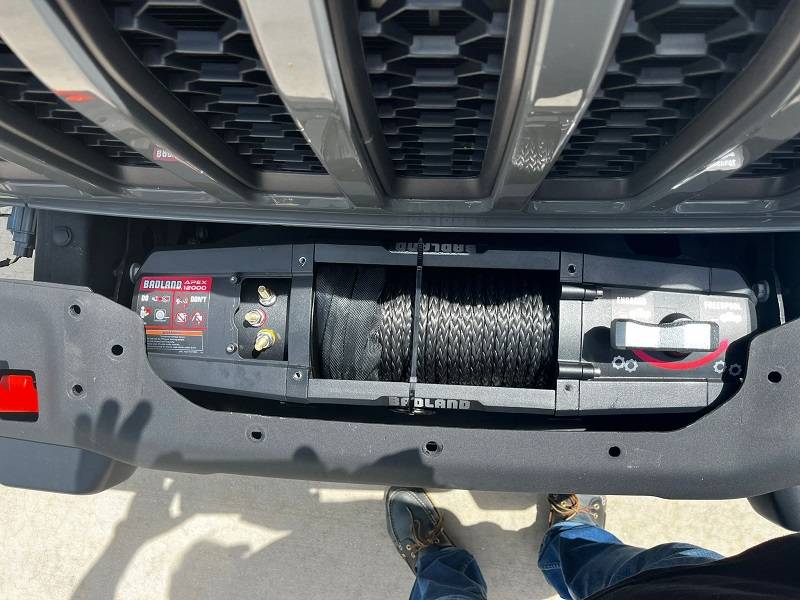

Is there a specific reason why the bumper needs to be removed?? I was modifying the exit for the wiring... so it comes on the side instead of the back,
Jeep Gladiator Wachuko's Mojave Build Thread W3
Jeep Gladiator Wachuko's Mojave Build Thread W4
and tested the winch with everything in place... It went in without issues...
Jeep Gladiator Wachuko's Mojave Build Thread W1
Jeep Gladiator Wachuko's Mojave Build Thread W2
Am I missing something??
I do know that I need to modify the locking handle... to avoid interference with the hoop.
Unless I am missing something, it looks like I can do the rest without removing the bumper...

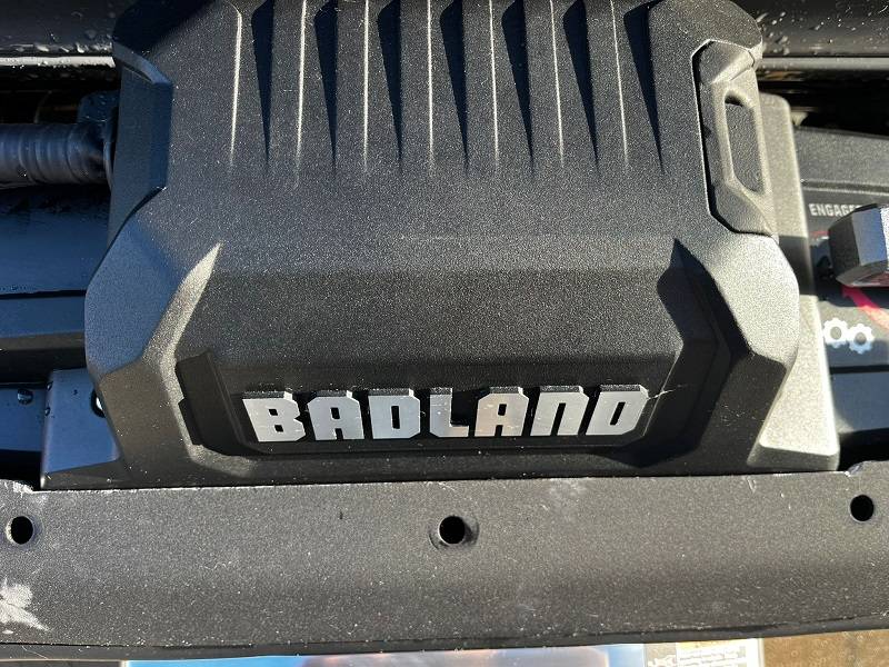

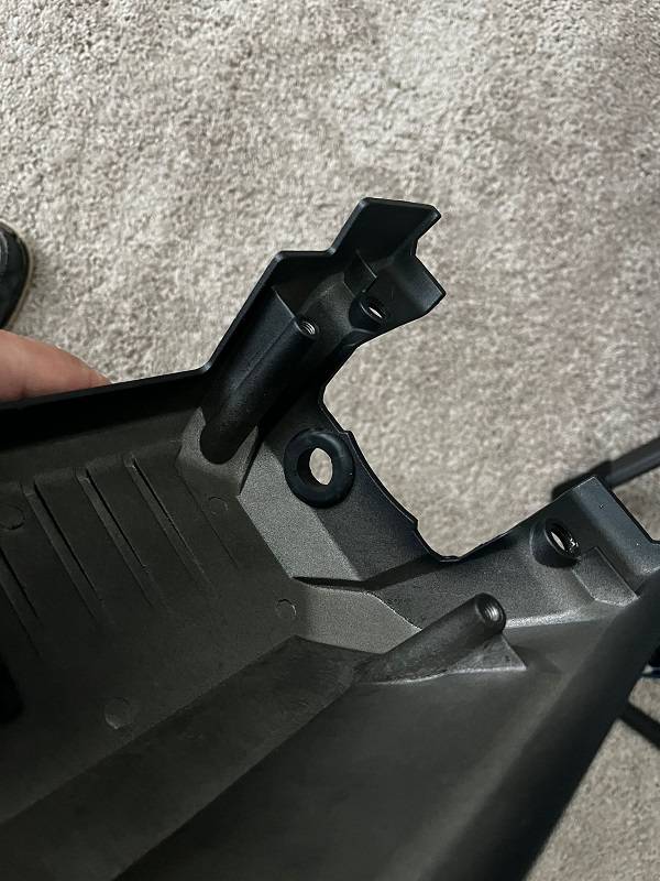

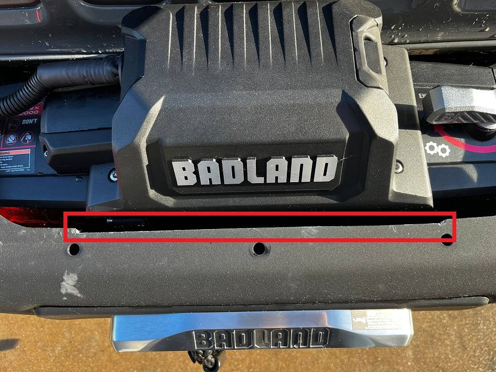

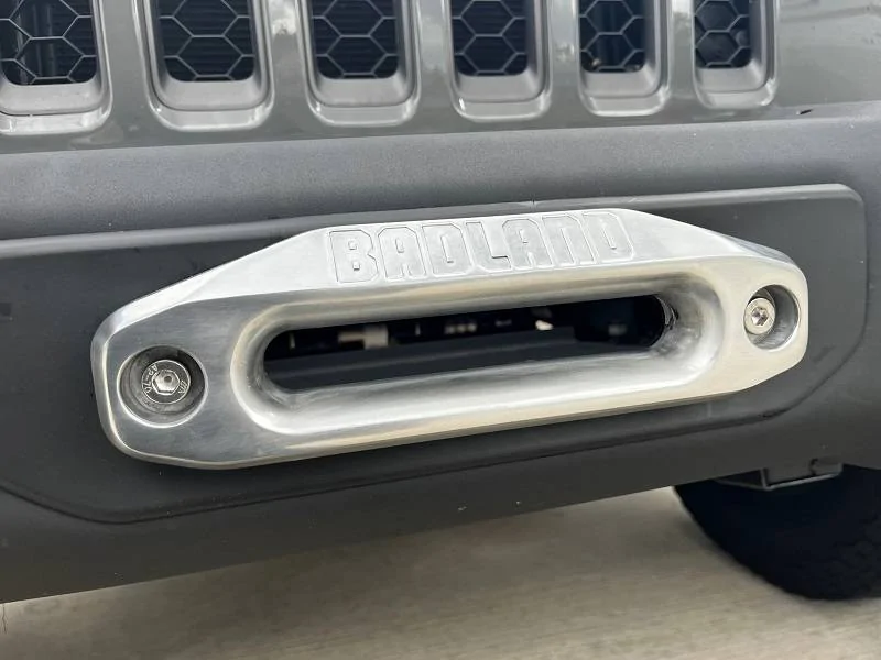

Well, I spoke too soon. Without the control box, bolts aligned perfectly... Once the control box was installed, I was off by about 3/16"... turns out that the front cut out is not completely straight and the corners would not allow the winch with the control box installed, to come forward enough.
Easy fix since this bumper is aluminum... straighten the front and it aligns fine now... just need to wait until everything dries up (never stopped raining last night)... to paint that border.
Jeep Gladiator Wachuko's Mojave Build Thread W11
Also painting the logo black... I don't mind the fairlead to be bare metal, but I just do not like the logo like that. Black, like the rest of the cover, would be just fine. I have some wrinkle spray paint that I can use for that.

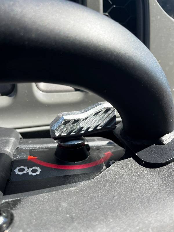

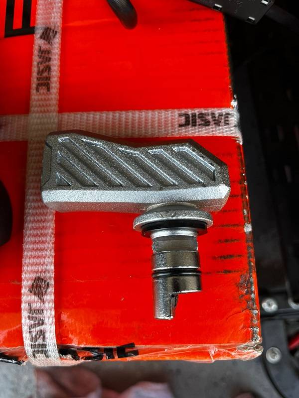

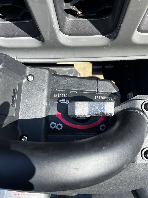

Almost there... modified the Locking/Unlocking handle. Installed the hoop. Secured the hitch with the bolts.
Jeep Gladiator Wachuko's Mojave Build Thread W12
Jeep Gladiator Wachuko's Mojave Build Thread W13
Jeep Gladiator Wachuko's Mojave Build Thread W14
Only thing left to do is to hook up the power. Need to route the cables and install disconnect switch.
Jeep Gladiator Wachuko's Mojave Build Thread W15
Oh... and then give it a good wash... it is dirty as heck... But hey, it is a Jeep...

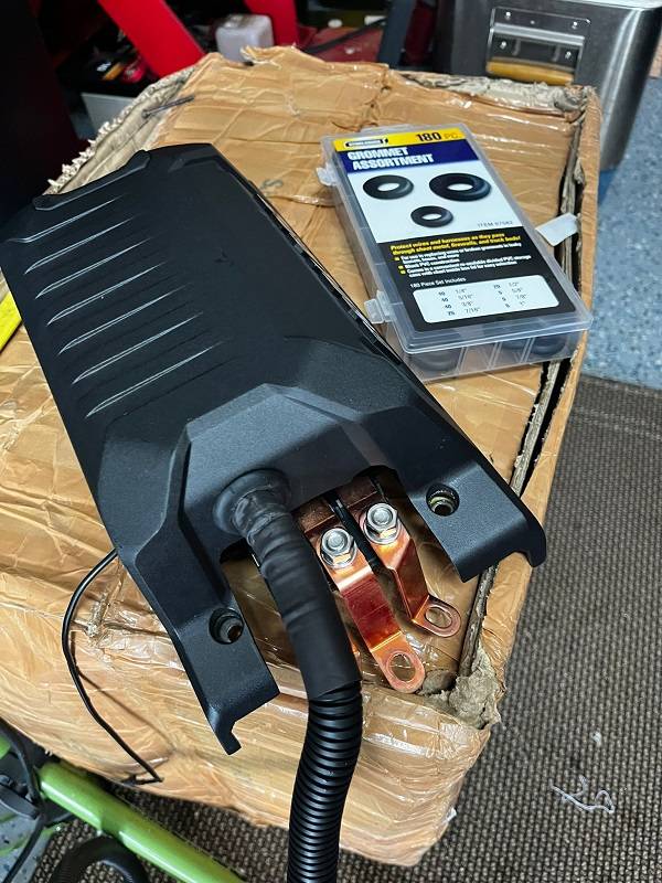

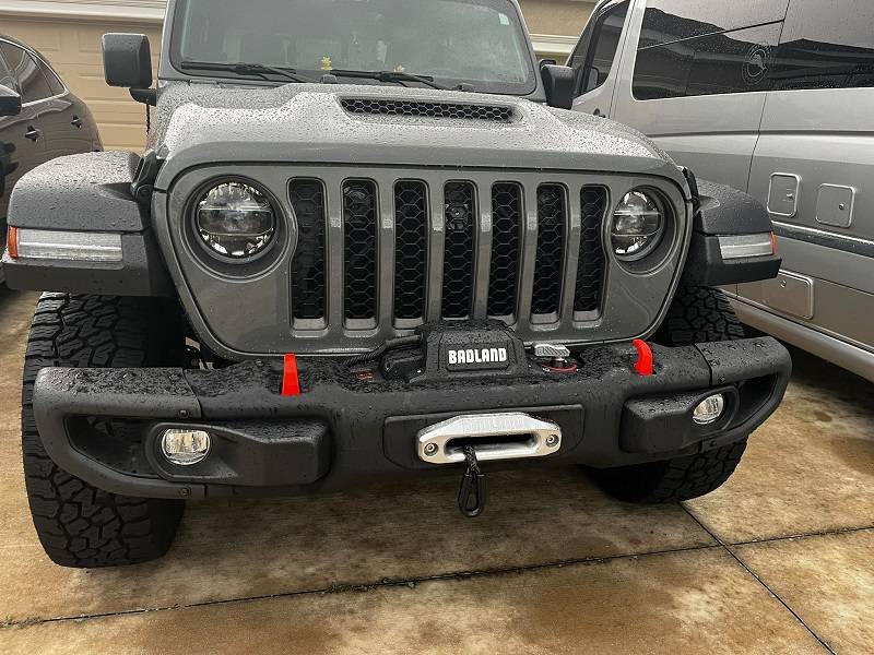

Wires routed to the battery area. Nothing hooked up.
All bolts and covers buttoned up…
Just need to read a few threads on how folks wired these…
Jeep Gladiator Wachuko's Mojave Build Thread IMG_2485
wachuko
wachuko
Nov 7, 2017
507
544
Ocala, FL
2024 Jeep Gladiator Mojave X

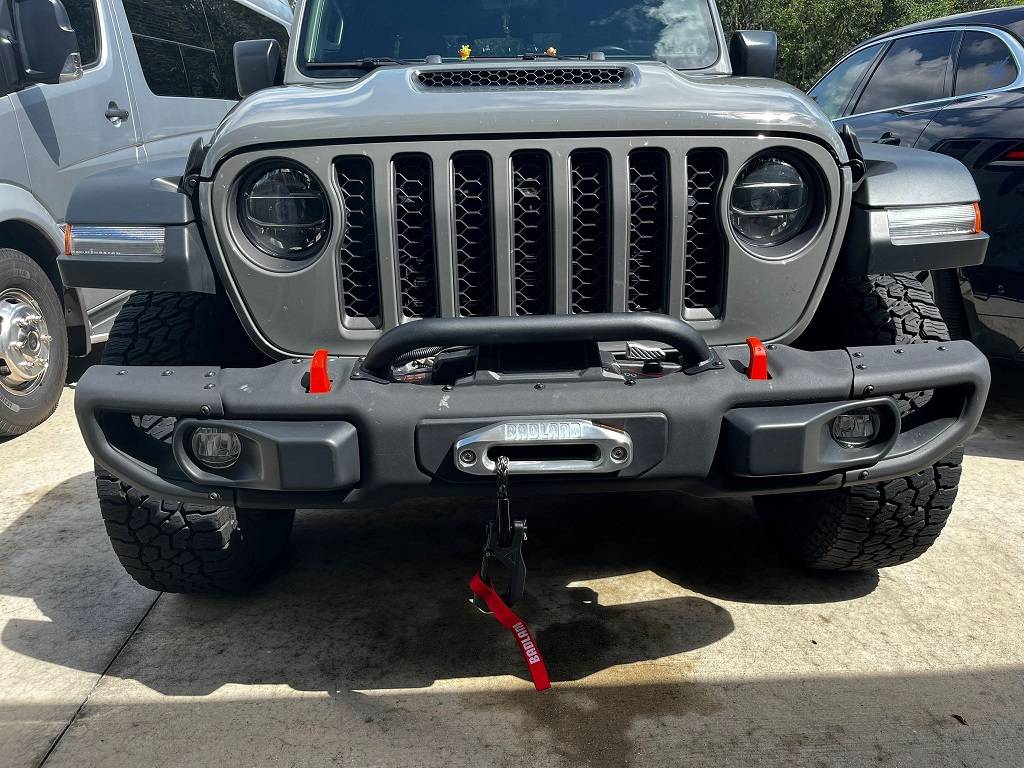

Done… just need to tension the line…

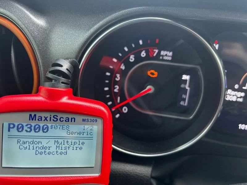

Here we go...
Jeep Gladiator Wachuko's Mojave Build Thread CheckEngin
Minty JL
Jeremy
May 15, 2019
4,803
7,658
Ft Meade, MD - AOR
Your JTM is rejecting the winch mod LOL
