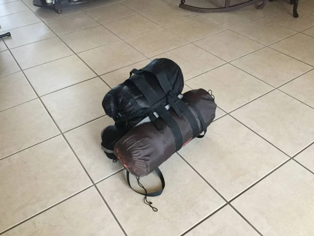

Before I plunge that amount of $$, I will be using the setup that I had on my adventure bike (now gone)... Compact and has worked well so far...

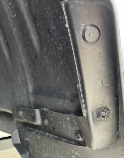

I apologize if you mentioned it in the thread, but what mudflaps are those?
Those are factory (Mopar) mudflaps… They come with rivets, but I did not have good luck with those so I used bolts instead.
Here, take a look… only one rivet held… had to use bolts for the rest.
Jeep Gladiator Wachuko's Mojave Build Thread 336C66BE-B782-4F49-BFB5-D473A1882044
Also, not all holes will align… if going this route, be prepared to drill a couple of holes in the back plastic liner… no drilling in any metal is required….

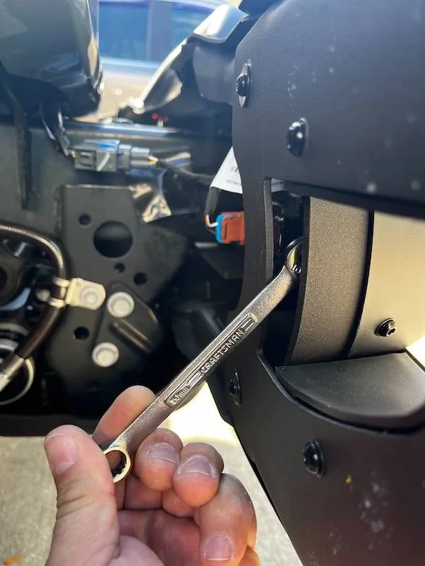

I can understand why folks would say that installing those two bolts on each bezel is a royal PITA...
I managed to install them using the open end of a 10mm wrench... sliding while pressing against the metal until it reached the hole... Then inserted the bolt and tighten using a 4mm allen wrench...

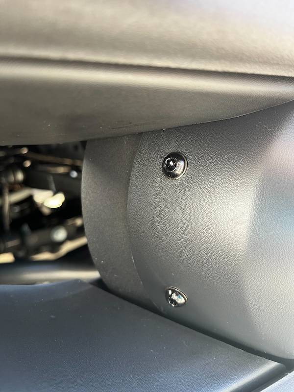

Jeep Gladiator Wachuko's Mojave Build Thread IMG_0079
New Mopar fog lights bezels installed with all four bolts... Done!
Jeep Gladiator Wachuko's Mojave Build Thread IMG_0078

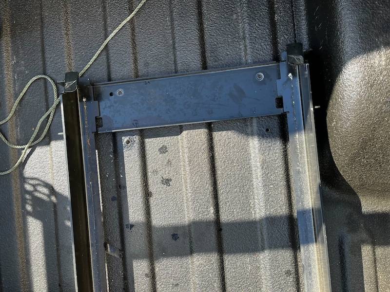

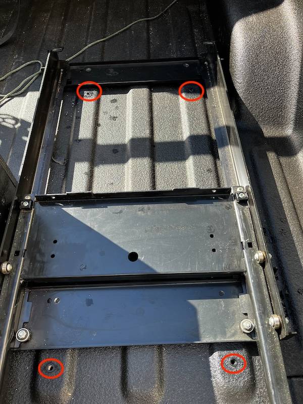

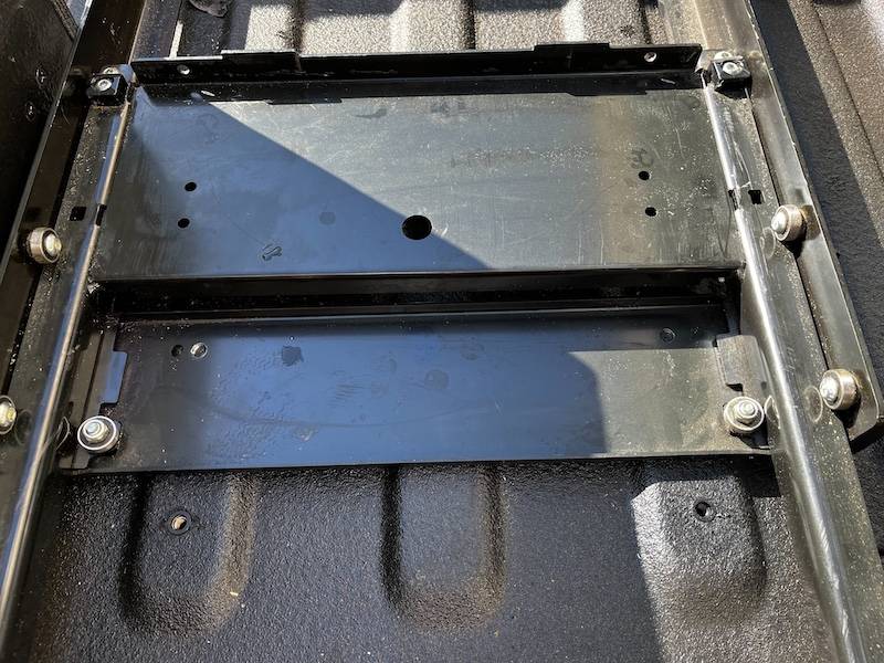

Holes in the bed and rivnuts installed... 4 M8 rivnuts to hold the slide for the kitchen box.
Jeep Gladiator Wachuko's Mojave Build Thread IMG_0081
Sprayed them to make them disappear ;)
Jeep Gladiator Wachuko's Mojave Build Thread IMG_0080
Jeep Gladiator Wachuko's Mojave Build Thread IMG_0082

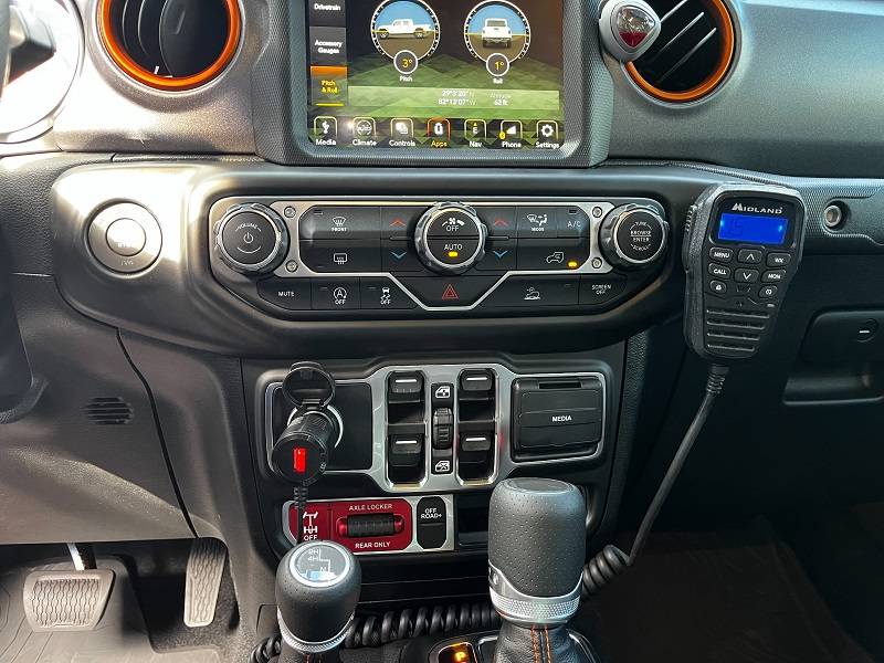

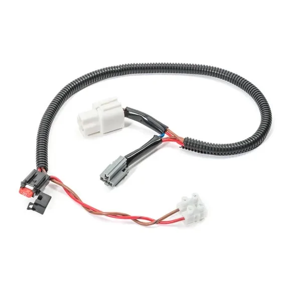

Finally took the time to install the power to the GMRS radio... Using the Quadratec 12 Volt Power Adapter for 99-22 Jeep Wrangler TJ,JK,JL & Gladiator JT
And only managed to loose one clip ? It went into the void... I went ahead and ordered a few to have some spares... Meanwhile, borrowed one from the cover under the steering wheel. Easier to replace that one when the new one comes in...
Anyway... that is done. One less power cable visible in the cabin...
I that a Midland MX275?
Based on the mic, I would say it is. I have one sitting on my kitchen table waiting for a reasonable day to install it.... and I guess I need to figure out what I am doing for an antenna mount that doesn't nullify the benefits of the actual antenna.

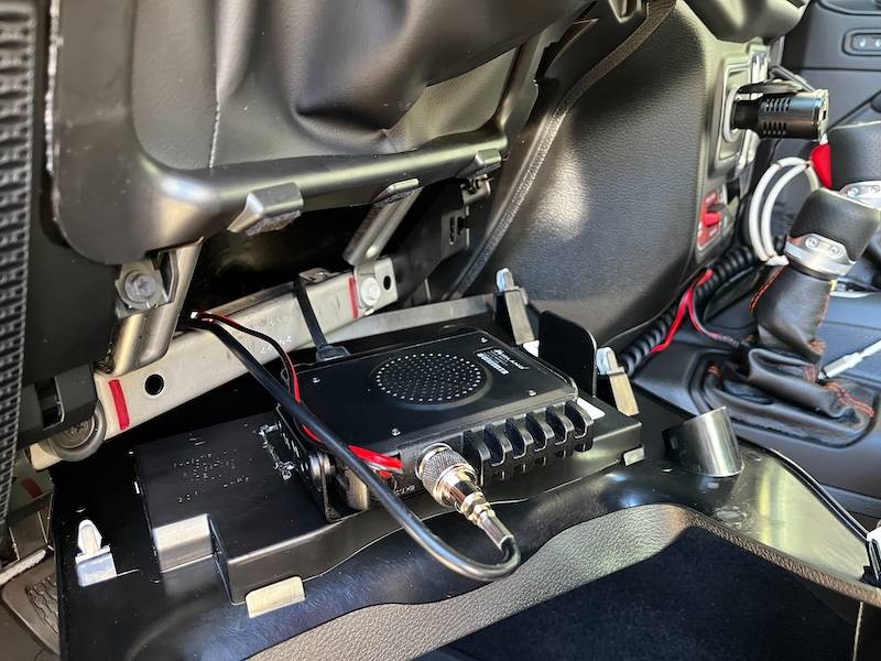

Yes. But do not install it they way I did... I was not aware there was a plate that could be installed in there and would make it easier to install.
Right now mine is attached to the cover, as you see in the photos. I will change that at a later time. Plan is to make the plate and just bolt it in place... Looks easy enough to do myself.
