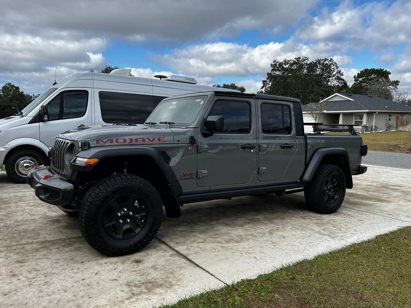

Congrats on the Mojave! That thing will get you about any place you'll ever want to go, and with a very smooth ride. I've seen many of them geared up for overlanding and getting deep into the trails. Good choice.
I've had great luck buying and selling take-off parts on this forum. Keep your eye out for a factory steel front bumper. You might find a good deal from someone who's swinging for the fences with an aftermarket setup.

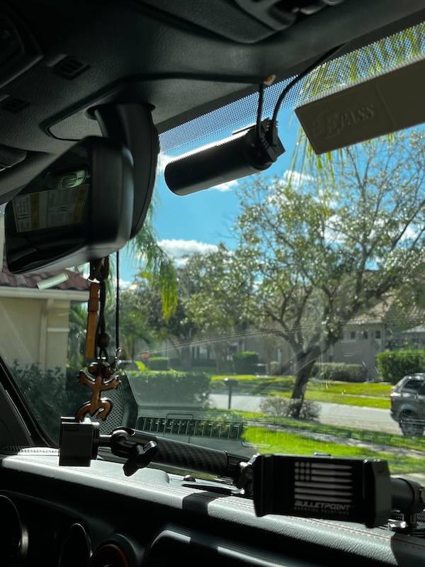

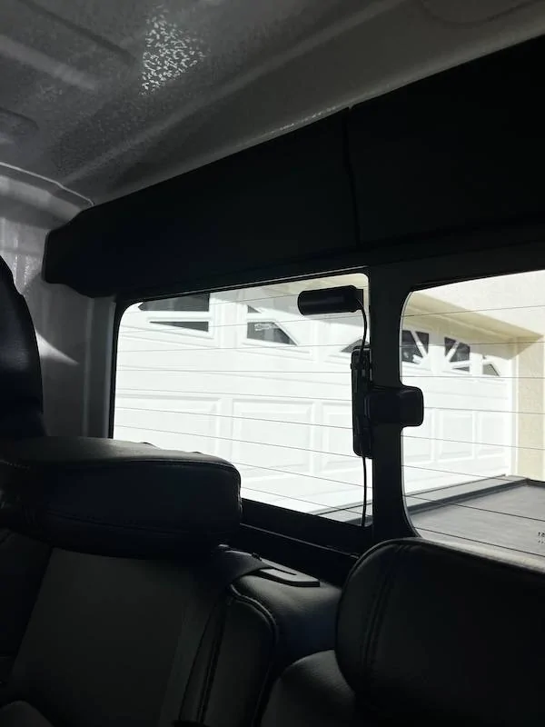

First impression with the dashcam. Works as expected... not sure I can say much else, lol... it is a dashcam...
Jeep Gladiator Wachuko's Mojave Build Thread IMG_9624
Jeep Gladiator Wachuko's Mojave Build Thread IMG_9625

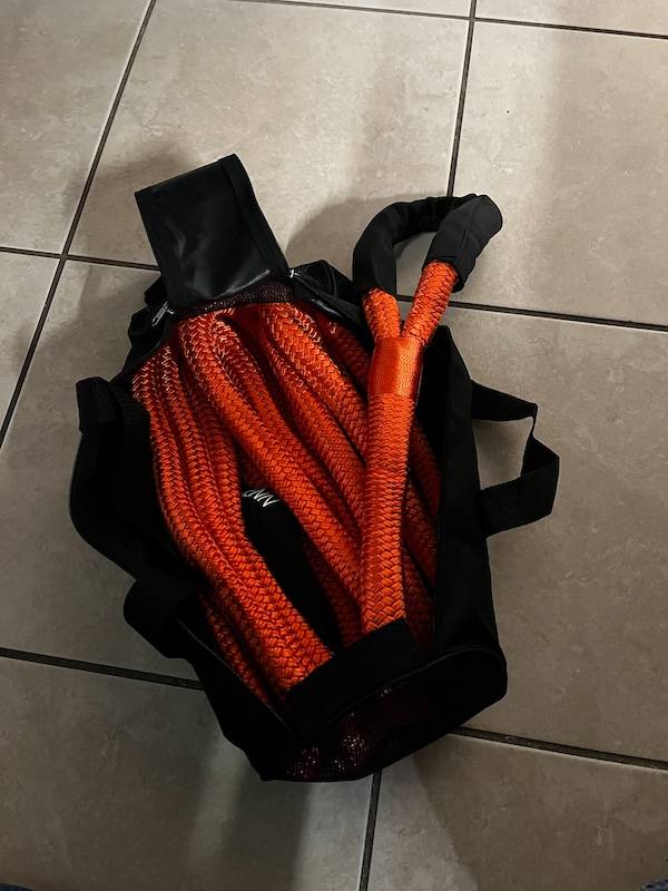

And, on other news, sister-in-law sent me a gift... 1"x30' HD kinetic rope / recovery tow strap... In orange!
Jeep Gladiator Wachuko's Mojave Build Thread IMG_9623

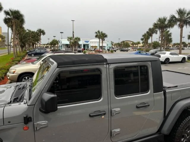

Second hand Bestop Sunrider… but in like-new condition and at a fair price…
You can't see them... but the hard tops removed are in the backseat... I installed it right there with the help of the seller. A plastic clip, two spacers and 6 bolts... that was it. Did not know it was that easy to install...
All I need to do is give it a wash as it was a bit dusty as you can see in the photo.

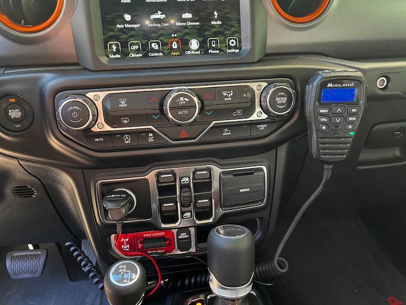

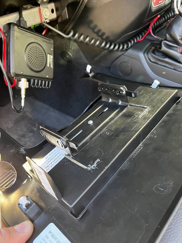

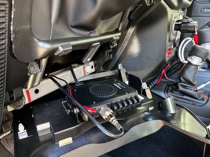

Finally connected the Midland MXT275
Jeep Gladiator Wachuko's Mojave Build Thread IMG_9657
Jeep Gladiator Wachuko's Mojave Build Thread IMG_9658
Jeep Gladiator Wachuko's Mojave Build Thread IMG_9659
After the install I found a video where the install a small plate on that crossmember under the cover... I would have preferred to do that... oh well... maybe I will change it later.
The benefit is the ability to remove the cover and not have to deal with the MXT275.... so I will make that plate.
I also want to hardwire the power... when I get to changing the plate (mount location) I will tackle that as well.
For now, it works.

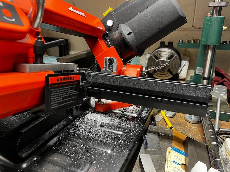

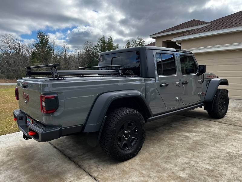

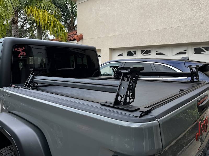

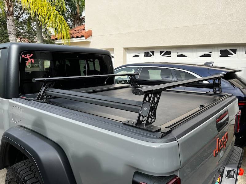

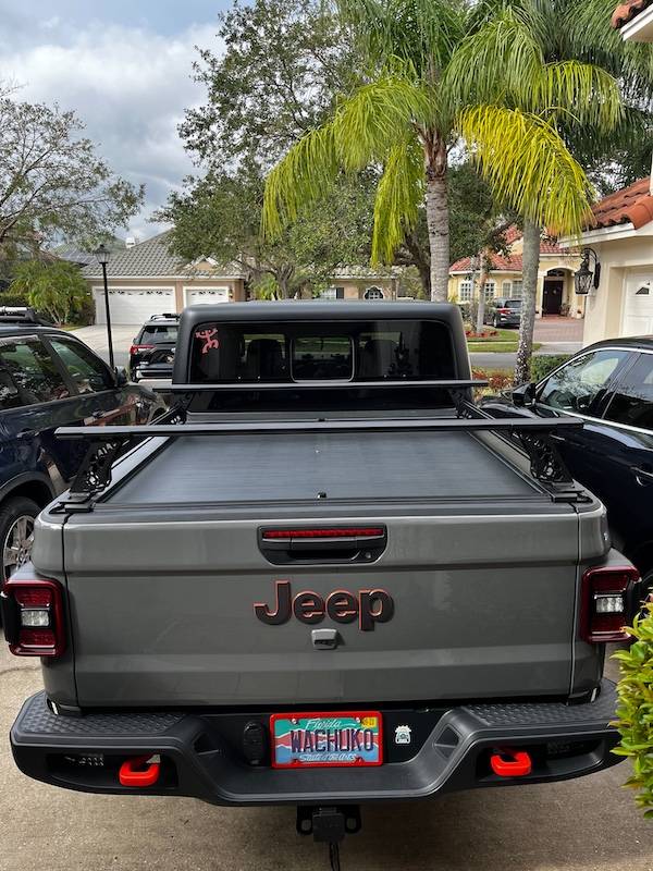

XRS setup arrived and now installed... some cutting to size was needed...
Jeep Gladiator Wachuko's Mojave Build Thread IMG_9752
Sides bars cut to 40" including the end plates that the bars come with...
Jeep Gladiator Wachuko's Mojave Build Thread IMG_9753
Crossbars cut to 58", again, including the end plates on the bars...
Jeep Gladiator Wachuko's Mojave Build Thread IMG_9754
The crossbars stick out 3" on each side from the top of the base... but do not extend beyond the width of the bed...
Jeep Gladiator Wachuko's Mojave Build Thread IMG_9757
This task is done!

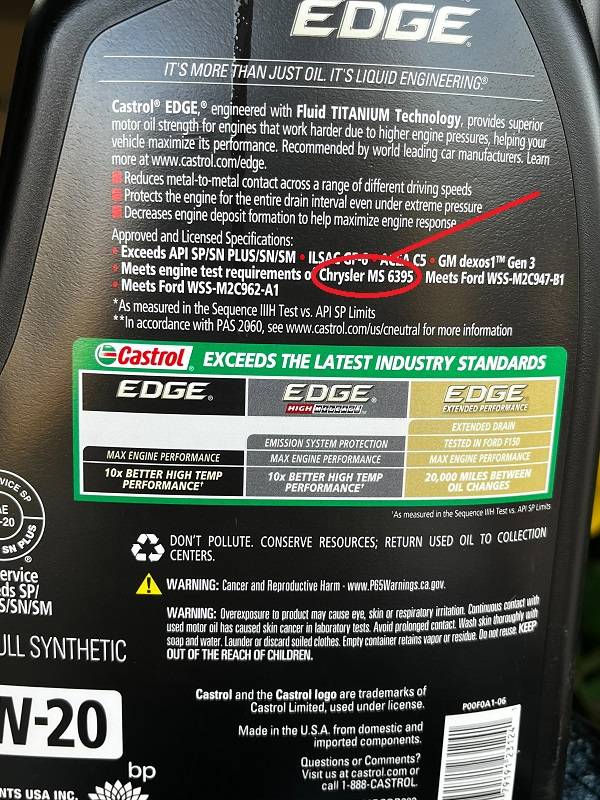

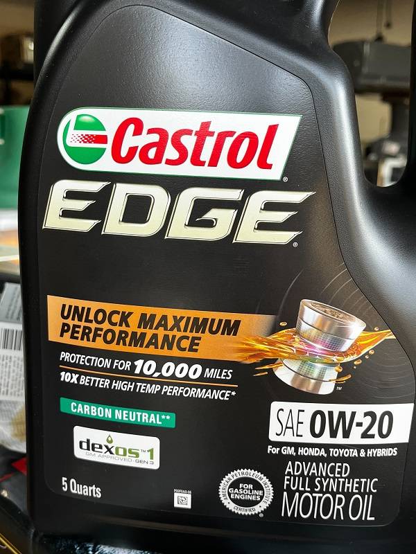

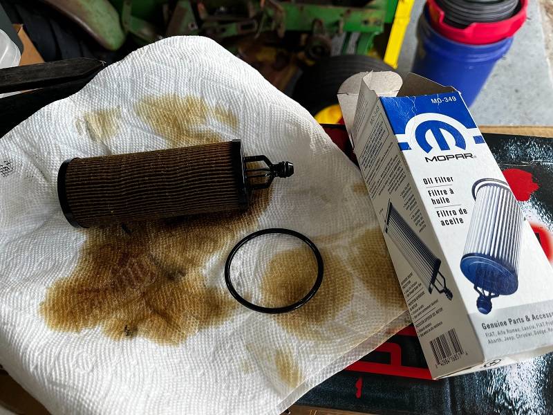

Wanted to change the oil earlier, but closed and opened my eyes and it already has 2100 miles...
Jeep Gladiator Wachuko's Mojave Build Thread IMG_9806
Used this as it meets specifications from Chrysler...
Jeep Gladiator Wachuko's Mojave Build Thread IMG_9807
Jeep Gladiator Wachuko's Mojave Build Thread IMG_9808
Next oil change is done by the dealer as part of the deal... at 5,000 miles.

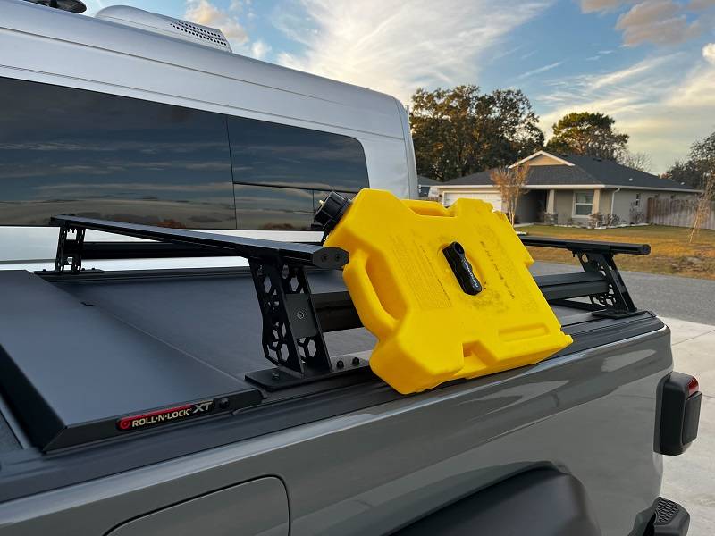

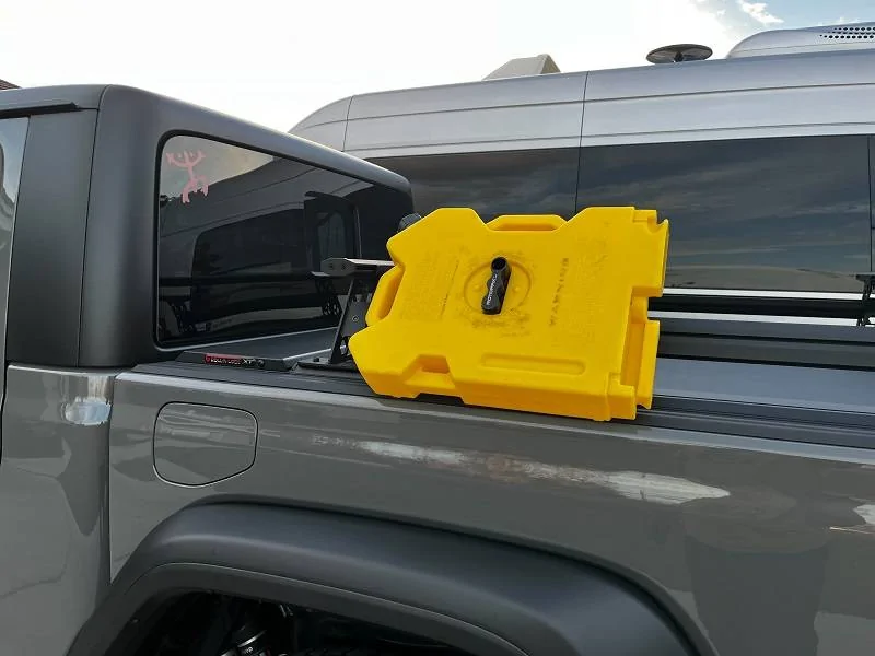

After that, I started looking at how to install the fuel RotopaX... I know, I know... my previous truck was a diesel... I will get red ones ;)
I will need to make a spacer and bracket where I can install the Rotopax mount offset... tank will hang a little on the side of the bed to clear the tent... I just need to order the quick release tent mounts from Go-Rhino to figure out how much of an offset I will need...
Jeep Gladiator Wachuko's Mojave Build Thread IMG_9811
Jeep Gladiator Wachuko's Mojave Build Thread IMG_9810

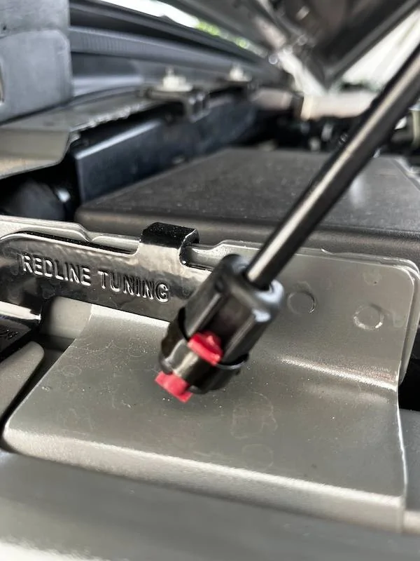

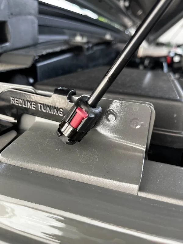

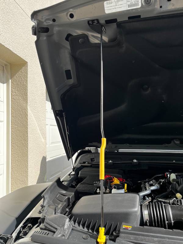

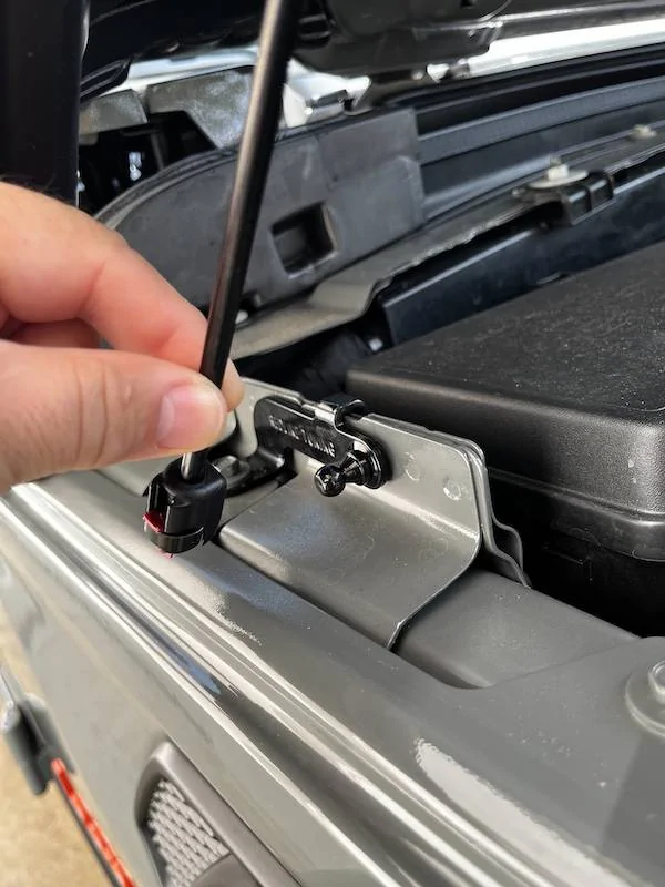

Can the hood lifts be very quickly disconnected? I open the hood to the windshield a lot for more room.
wachuko
wachuko
Nov 7, 2017
493
525
Ocala, FL
2024 Jeep Gladiator Mojave X
Short answer, yes.
But they say that a photo is worth...
Open hood... place old fashion rod in place...
Jeep Gladiator Wachuko's Mojave Build Thread IMG_9853
Look at the strut... see the redish tab? Currently in locked position...
Jeep Gladiator Wachuko's Mojave Build Thread IMG_9854
Push to slide down the tab...
Jeep Gladiator Wachuko's Mojave Build Thread IMG_9855
Pop out the strut... easy...
Jeep Gladiator Wachuko's Mojave Build Thread IMG_9856
I hope that helps answering your question.?

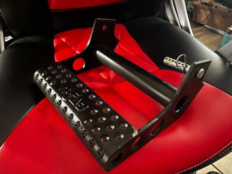

As mentioned elsewhere, I have four N-Fab steps…my initial plan was to fabricate a mount for them that would fit the stock rails…
Jeep Gladiator Wachuko's Mojave Build Thread 1DCF6C5D-7D2A-49EC-BFB7-3E42767ACE01
Instead, I have decided not to fabricate anything to adapt the N-Fab steps to the factory rock rails... I went ahead and ordered the N-Fab (RKR) rock rails.

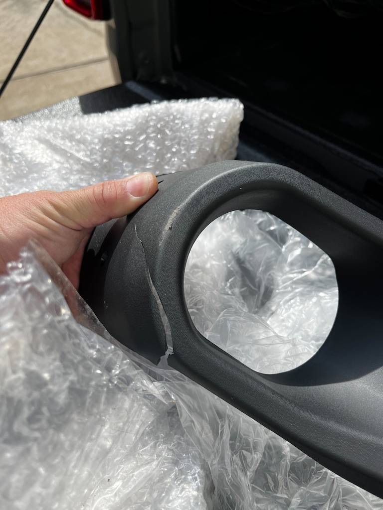

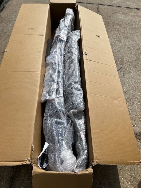

Bumper arrived... will post more photos when I get it all out of the box...
Jeep Gladiator Wachuko's Mojave Build Thread IMG_9955
First thing I checked were the plastic covers as many have received them cracked... I was not the exception :(
Jeep Gladiator Wachuko's Mojave Build Thread IMG_9958
More when I get it all out and unwrapped...
Jeep Gladiator Wachuko's Mojave Build Thread IMG_9956

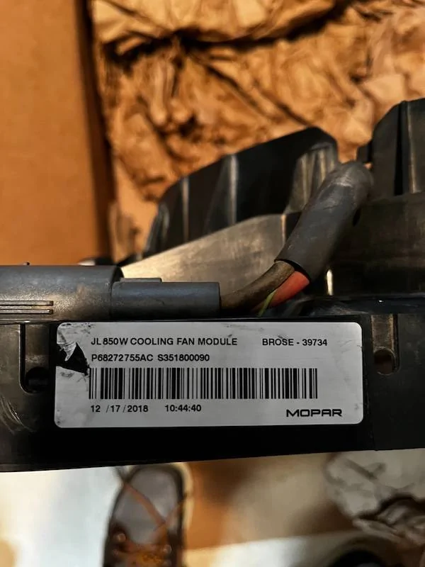

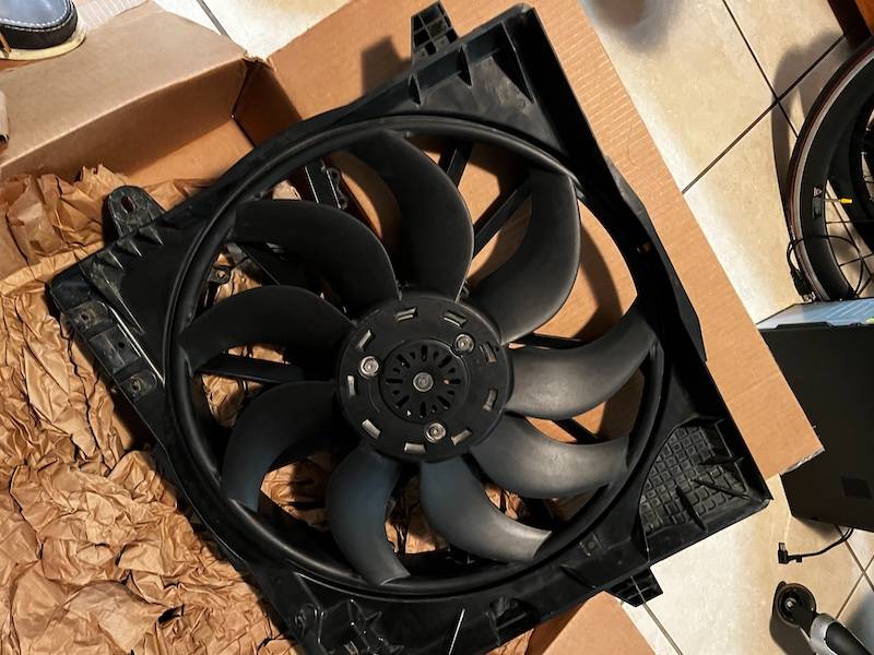

Also received a second-hand 850 watt fan...
Jeep Gladiator Wachuko's Mojave Build Thread IMG_9952
Jeep Gladiator Wachuko's Mojave Build Thread IMG_9954
