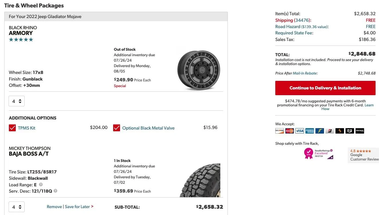

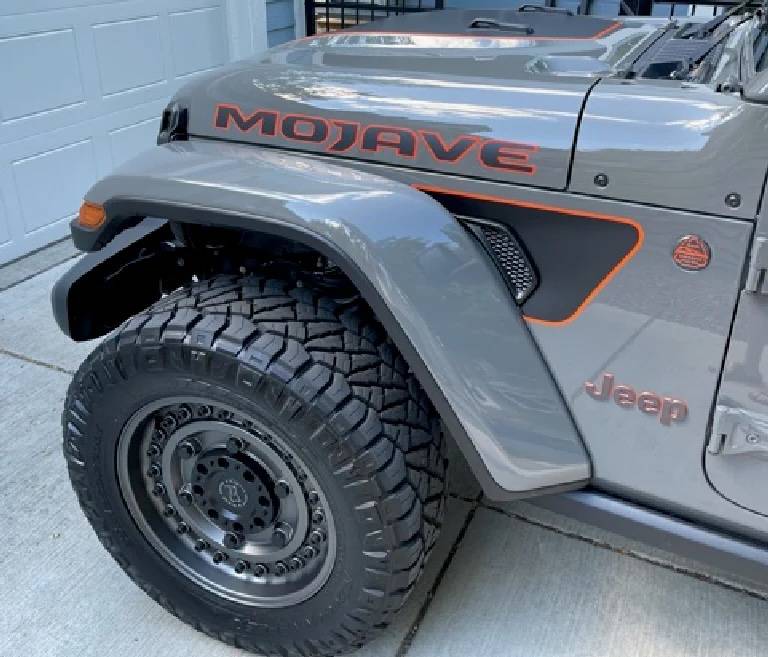

I do not know enough on this subject... but I like these wheels:
Jeep Gladiator Wachuko's Mojave Build Thread Jeep Wheels
Can't figure out the brand... When the time comes, this is what I want to go with... I want them to fit like the factory ones with some pizza cutters tires. So I will need to figure out correct off-set so I avoid any stick-out. Going with 255/85r17 Mickey Thompson Baja Boss ATs.
Those are Black Rhino Armory wheels.. but they only make them in a 17x9.5 for us.. thats a really wide wheel for a narrow tire.
Found them on TireRack... they show them available in 17x8... well, not immediately available, but soon...
Jeep Gladiator Wachuko's Mojave Build Thread Wheels and Tires
I have time, not buying anything until it is time to replace the tires.
The 17x8 +30 will definitely work. Should keep a 255 tire pretty flush with the edge of your fender.. Those E rated tires though.. I had D's and didn't enjoy them, went back to a C and my kidneys appreciated it.

Forgot to ask... these would be like stock wheels, correct? Off-set wise? I really do not want any stick out.
Thank you for the confirmation. Not sure what to do with the tires... those seem to be the only ones with the correct size for the looks I want.
They will work, and if you don't plan on lifting the mojave, the bypass zone you have in the shocks should make it tolerable.. be sure to call MT and ask them with your setup what pressure to run.. it may be more than the door placard..
Will do. Thank you!! And correct, I do not plan to lift my Mojave.

@Mightytalldude runs that exact tire. And I think MT told him to run pressures in the mid 40s, but I don't remember if his is a diesel.
I have the Gas 3.6. Call M/T give them the door tag info, the original tire size and your new M/T tire/size and they'll give you the correct pressure. I'm running 46psi per their info.
