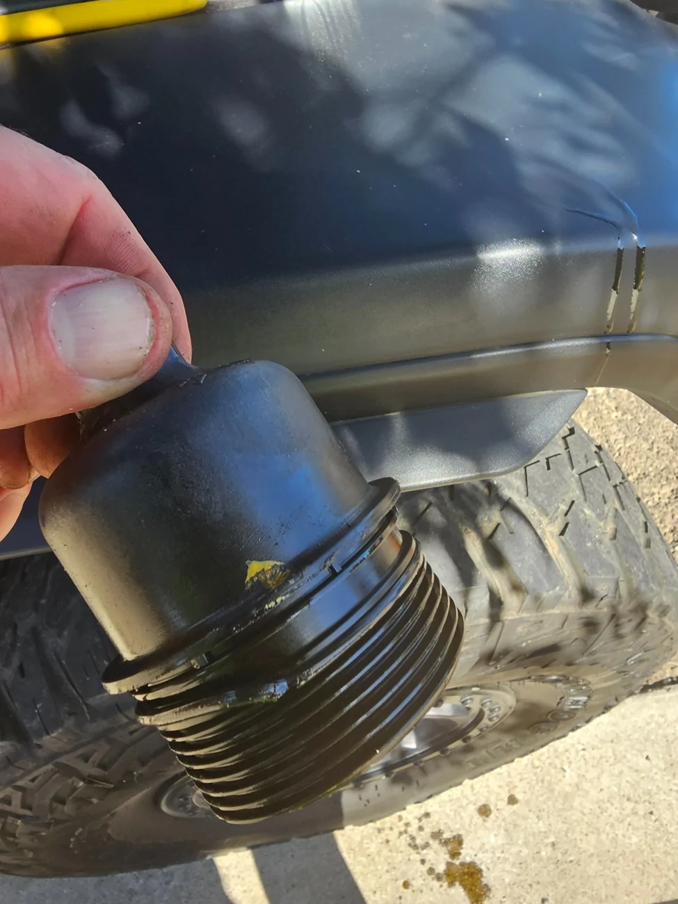

You didn't drive it after the light came on, and it still showed oil pressure when you shut it down. Odds are they screwed up the O-ring installing the filter housing cap (one of many reasons I hate this terrible design). Makes a hell of a mess, it will require a new o-ring, but there's no damage done. Good luck cleaning all the oil that's dripped all over the top and sides of the engine, down onto the skids, and everywhere else. It will smell like burnt oil for a month or better. You can see the pinched O-ring in this pic after I had a similar experience. I'd push for them to cover a full detail job.

^^ yup. worst design ever IMO.
Between the housing being plastic and it being on top of the engine I don't think you could design it worse if you tried. Give me a normal screw on replacement metal filter with built in O-ring that I can reach from underneath where I have to pull the plug from anyway.

IMO, the design is ok, but people knowing how to deal with plastic parts that seal with an o-ring, that's where the problem is
People don't understand o-rings.
The o-ring seals, not the tightness of the cap. It could be at 0 ft/lbs as long as that o-ring was in place and it would seal.
Lube the damned o-ring, keep the thing STRAIGHT, and don't over-tighten. Snug is fine, more tight does not mean a better seal because the o-ring seals it
If people could think of that thing in the lines of a hydraulic line plugged into the back of a tractor - thousands of PSI against that o-ring, and it seals without any "torque" on the connector.
Or how about your quick-connect air hoses?
Sorry, it's the dummies that deal with the filter housing that are the bigger issue, not the housing itself.

I get all of that, but what's wrong with a regular replaceable filter like we used for 50+ years? At least then the oring is built in and can't be installed wrong or pushed out of place when being installed. Over torquing still happened, but it almost never caused a leak and worst case I could hammer a screw driver through the damn thing in order to get the leverage to get it off because the entire thing was going in the trash anyway. And if it's on the bottom the oil change is done from 1 spot aside from pouring the new oil in.

I always liked the idea oil a metal can on the lower end and for extra caution I would put a filter mag on it, which would help with piece of mind in this scenario, ut it is what it is I guess. Just spoke to him again for an update, they topped up the oil after about 2L or so it was on the dipstick but they are doing another oil change on it again. He said to be up front the oil filter housimg was not on correctly or toght enough but will be cleaning it all up and checking everything over again to make sure there is no other issues before letting me have it back and if not ready by end of day a vehicle os waiting for me already just in case. I'm obviously not happy but am being pretty good about it and givong them the benefit of the doubt to make it right. Time will tell and that little 'what if' in the back of my head will be there for good though now. I'll be touching base again by 430 if I havent heard anything either way. Really wasting a day with somthing so annoying and frustrating and trying to be reasonable is not ideal but I don't know if things will/would work out any bettergping in screaming and yelling so trying hard to have patience
