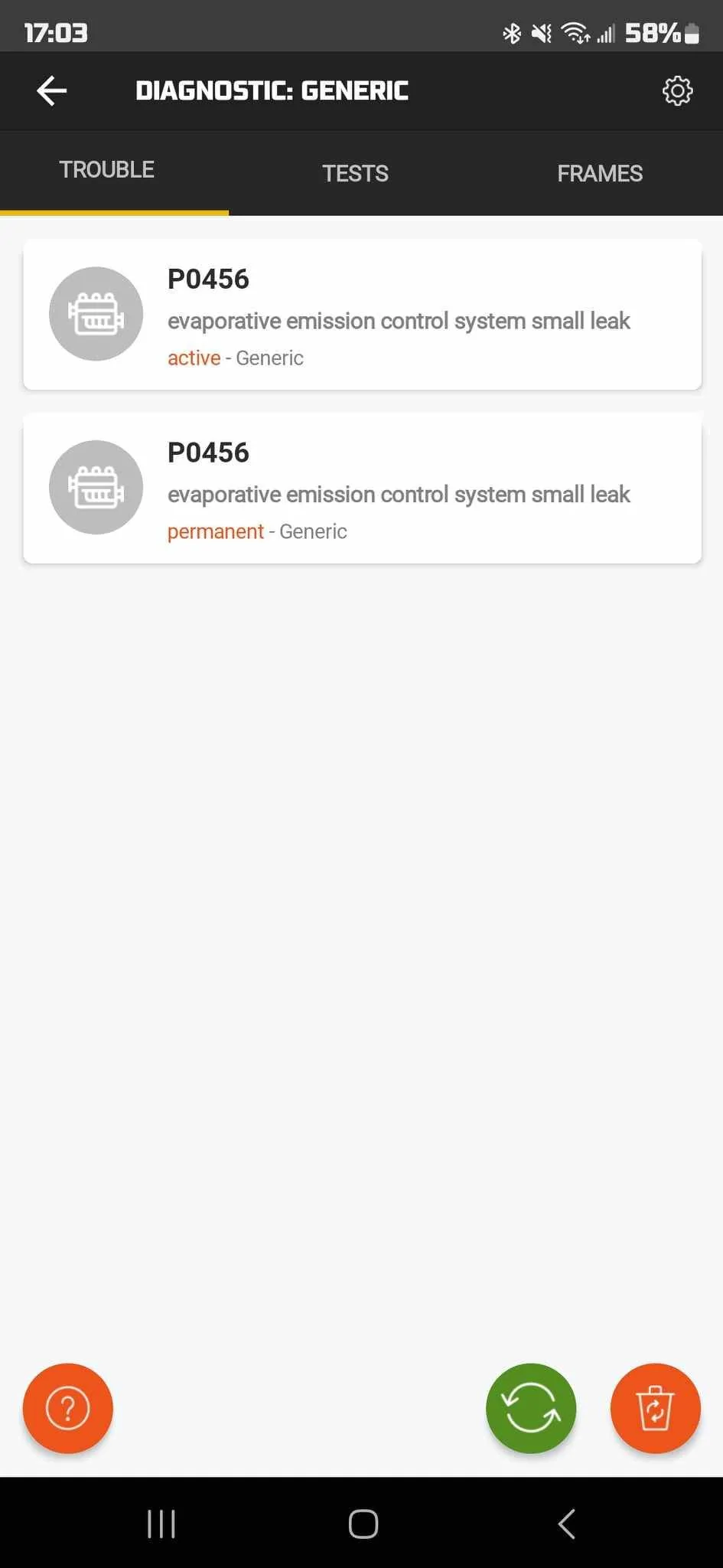

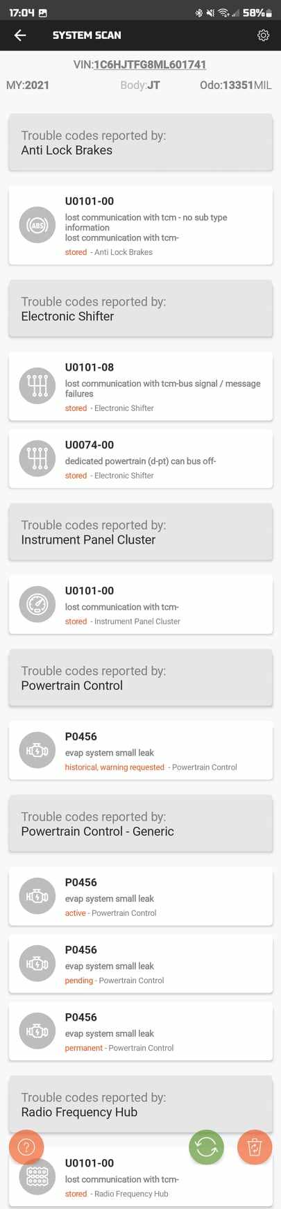

Hey experts! So, here's the series of events. My aux battery light came on a few weeks ago. I knew about the dreaded day because I'm on a few Jeep forums, and there's at least a post every single day bout the "avengers" light. Per the advice of multiple users, I followed directions to bypass the Aux battery. Everything was working well, until about a week later, after work I came out to a dead truck. Stock battery was a little over 3 years old, and with the Aux bat going out, I figured it as on it's way out.
So, I changed out the main battery, and all was well. I've kept the aux battery bypassed. Truck has been operating as usual, until yesterday, I started up the truck in the morning and immediately got a solid check engine light.
I went to an auto zone after work to get the code read. They also checked my new battery and alternator, and said they were both "perfect". Truck wasn't acting abnormal or anything.
I then came home and hooked the truck up to Jscan to see if the codes match and if the advanced scan showed anything else, and it did. So that's why I'm here. Do you have any advice on how to proceed? I can't stand the stealerships. They charge you hundreds of dollars just to pull your truck in the bay, they NEVER have loaners, but keep your truck for weeks...I just hate them truthfully so I'm trying to avoid them. I'm out of the 3 year warranty anyway. Any advice will be much appreciated :)

The P0456 DTC indicates a small EVAP leak detected. The battery doesn't cause this DTC, it results from the evaporative emissions system self test. On some 3.6 Pentastar engines, the purge solenoid hose cracks near the connector, which causes a leak resulting in the P0456 DTC.
The "U____" DTCs are communication loss DTCs that generally do not result in a MIL (check engine) light. They could result from a connection problem, voltage (battery/charging system) issues, problems in modules, wiring modifications.

Is this something that will force me into the dealer? I'm outside of the 3 year warranty. Do you think a Jeep shop could fix something like that?
If you don't see an obvious leak point on the EVAP system, you will need special equipment to diagnose it. Cold weather always brings out these issues with the EVAP system, seals harden and leak, hoses crack, etc.

Like Charles236 said, you likely have 2 issues. I would be more concerned with the Evap faults. Gas cap, purge valve like was mentioned are good guesses. You can go to any ma and pay shop if the have a smoker, to find the leak. It is not a Jeep specific issue. You wrote the codes down so go ahead and clear them. The perm code will go away when the issue is fixed. You may also see the pending code still there. The U codes and any other stored codes should clear. Messing around with your battery connections could have induced the U codes.
