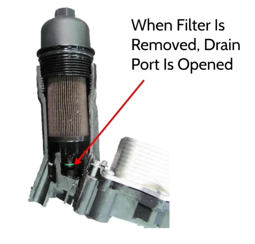

Loosen filter, unscrew cap and let it sit and drip down to the pan, reach under and drain the pan.
This way there's nothing in the filter housing to be messy, and it's down in the pan to drain out with the rest of the dirty oil. Oil at the filter housing area may be dirtier than other oil because of dirty oil shedding off the filter paper - I want it down and gone. So the filter comes loose first, and drains into the pan.
I have a feeling that some do the pan, close that up, then get up and swap the filter, not realizing that once they loosen and raise that filter, dirty oil goes down into the pan which is now closed.
So me - Loosen filter, unscrew it completely but let it sit and drain up there, then do the pan and check other stuff while that's draining, then close the pan, go from there.
I don't just "crack it loose", I unscrew it and just let it rest there on the top thread, fully disengaged, fully unscrewed, but resting in the housing to drain.
Agreed. I just do it slightly differently, in that I crack the filter after a decent amount of oil is drained out, which decreases my drippings at the filter. But I still do it while the drain is still open at the pan. I don’t close the pan until the very last step. After the new filter is in. Right before filling new oil.
40,514
54,044
Draining oil at the pan doesn't drain oil from the filter. Oil is held at the filter until it's loosened and that valve allowed to open. There's no connection between draining the pan and having less oil in the filter.
That I understand. And thanks for the picture. It now makes perfect sense why we don’t need Baxter filters to keep oil in the filter housing. They’re already designed to, unless you loosen it. I still think I’m getting that old filter oil out if I’m leaving the pan open while refitting, and cleaning the filter housing. I’m meticulous, so the housing is open for at least 5-10 minutes while I pull the filter, put the new o ring on, wipe it clean, oil the o rings, wipe it clean again, and finally reinstall it.
