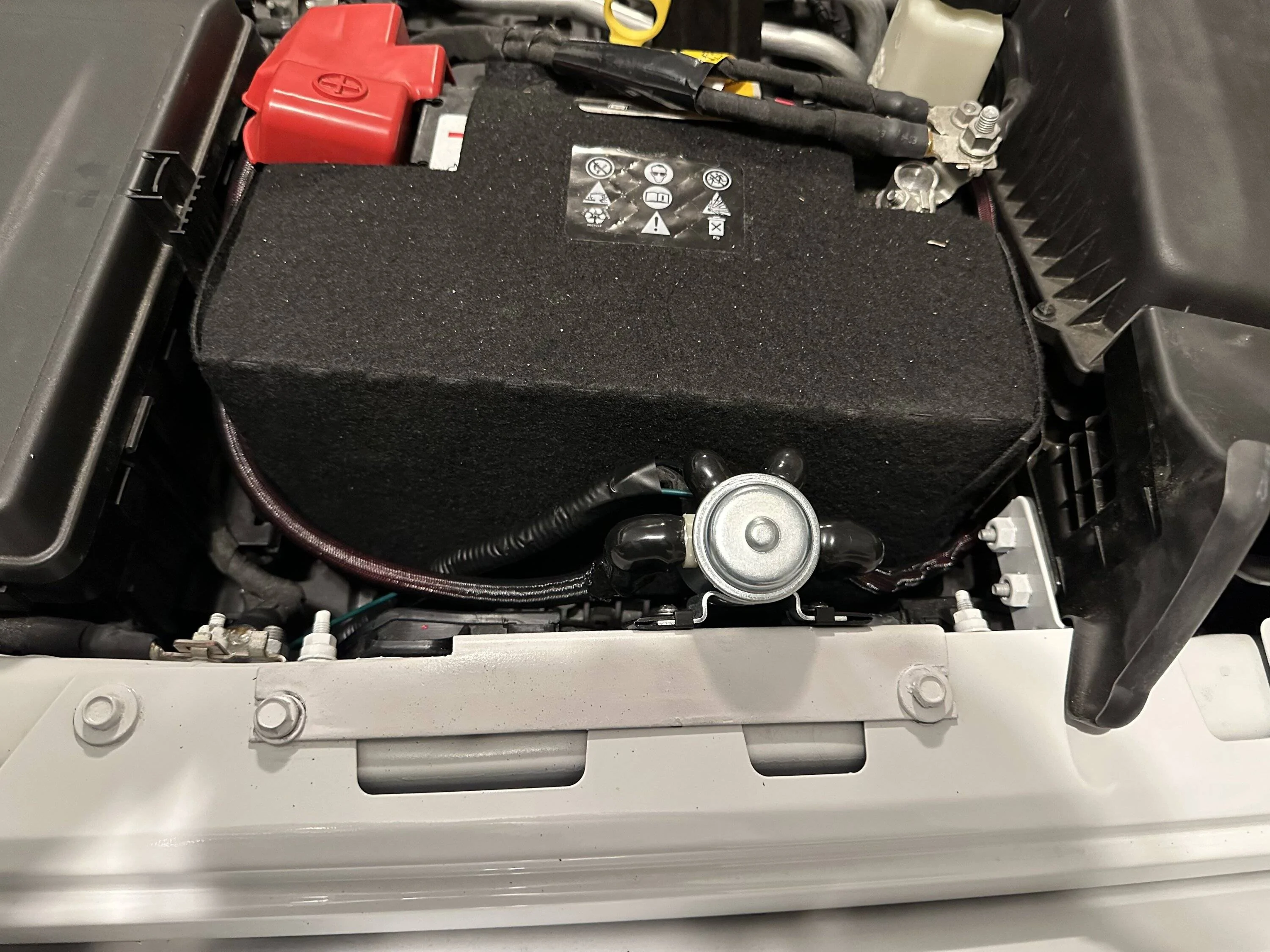

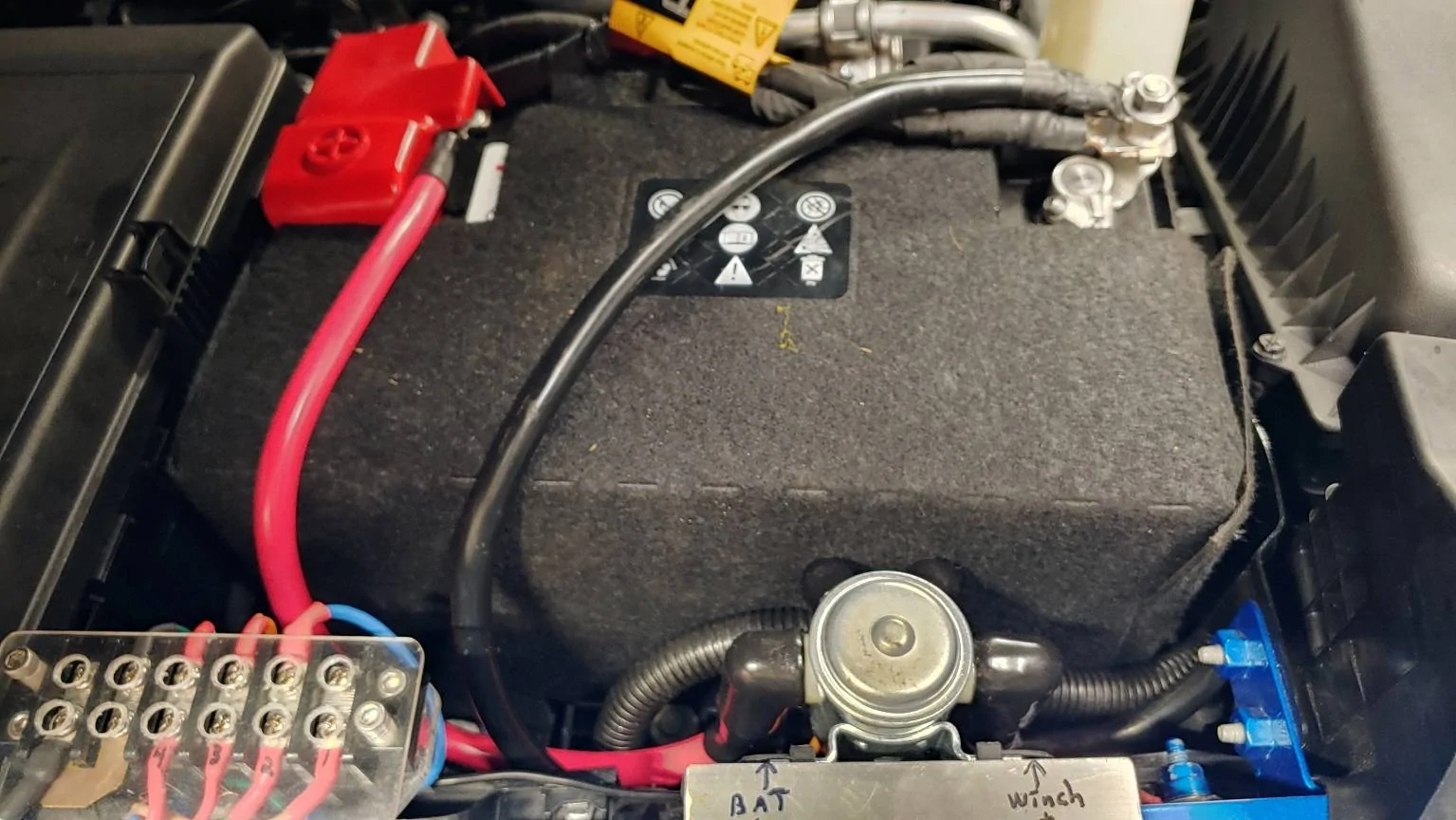

Used the warm power interrupt kit and fabri-cobbled my own bracket to mount the solenoid. Used aux switches so didn't have to run a switch to the cab. Finally wrapped all hot wires in a teflon loom. Was a little bit of work to wire it correctly but happy with how it turned out.

Nice and neat and the wrap will add another layer of protection.

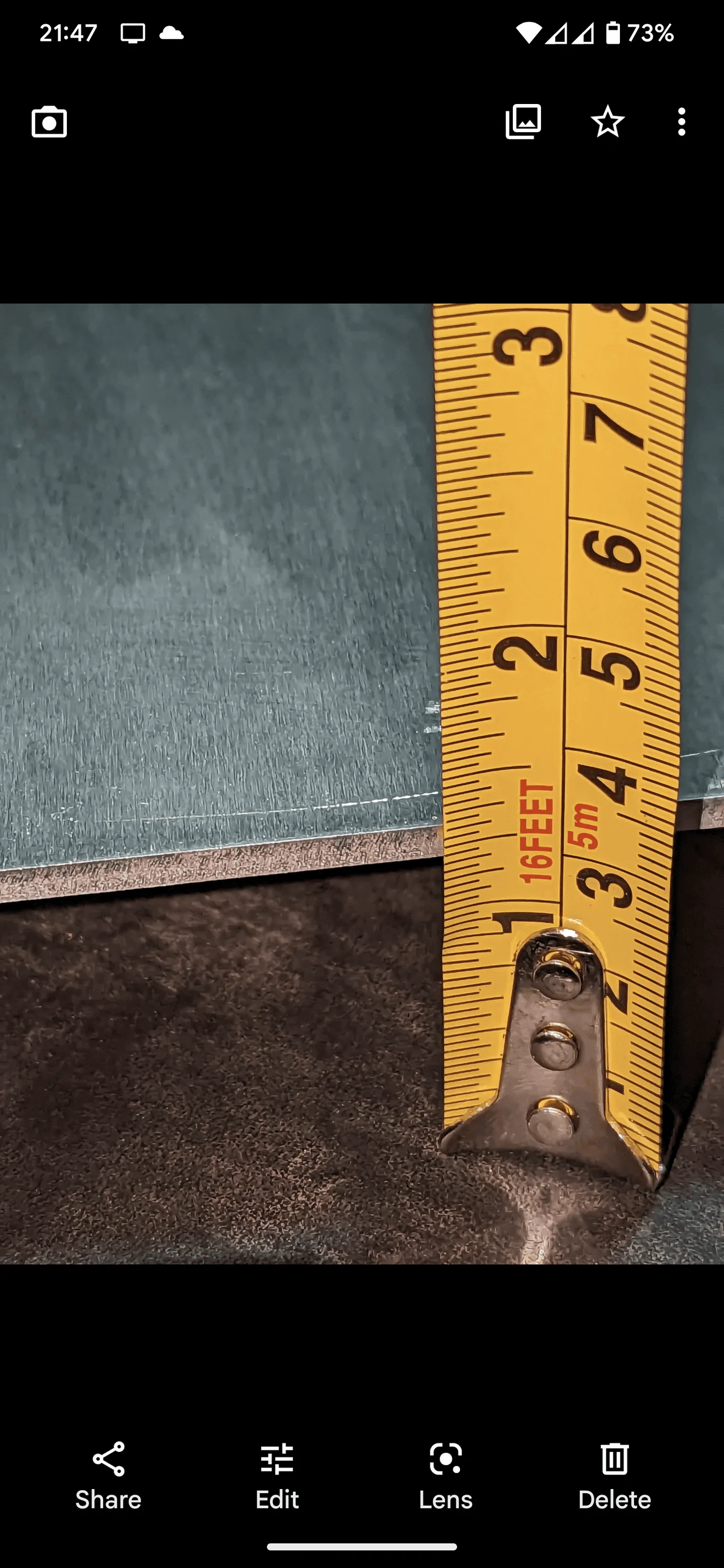

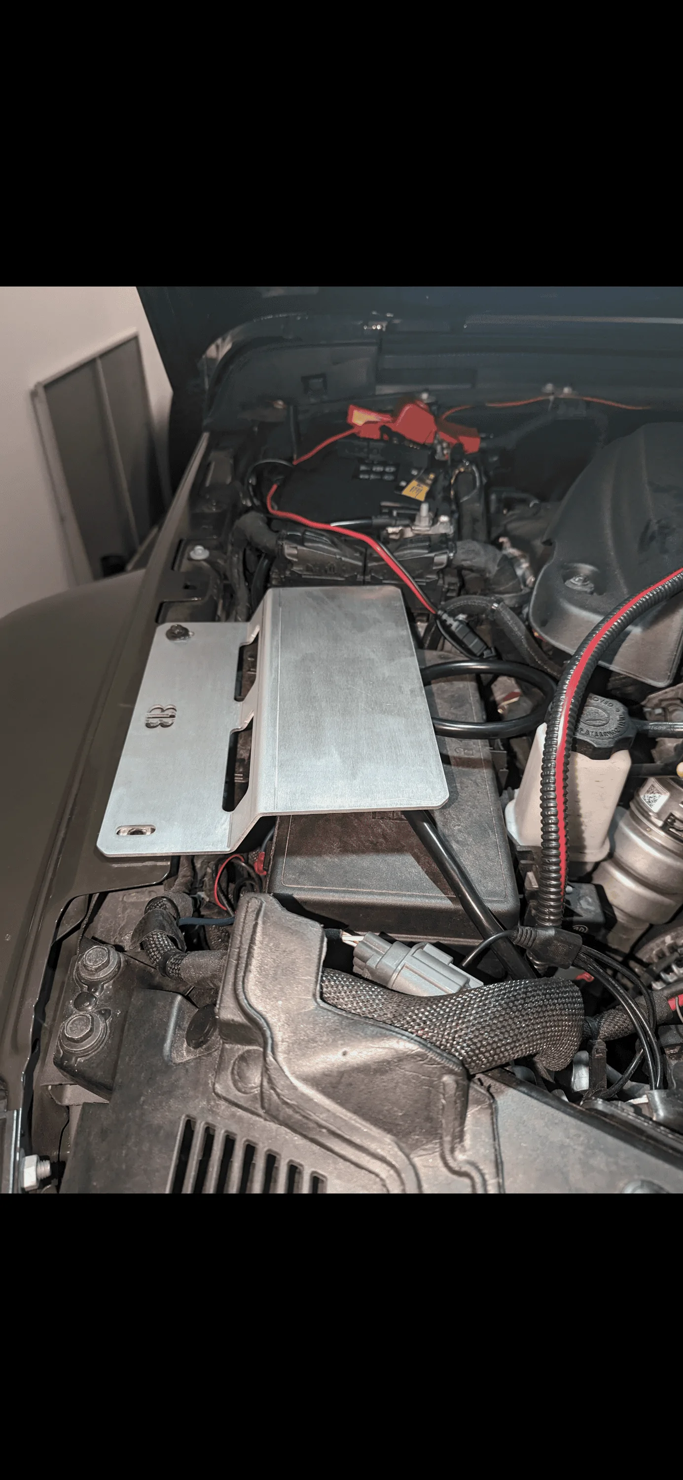

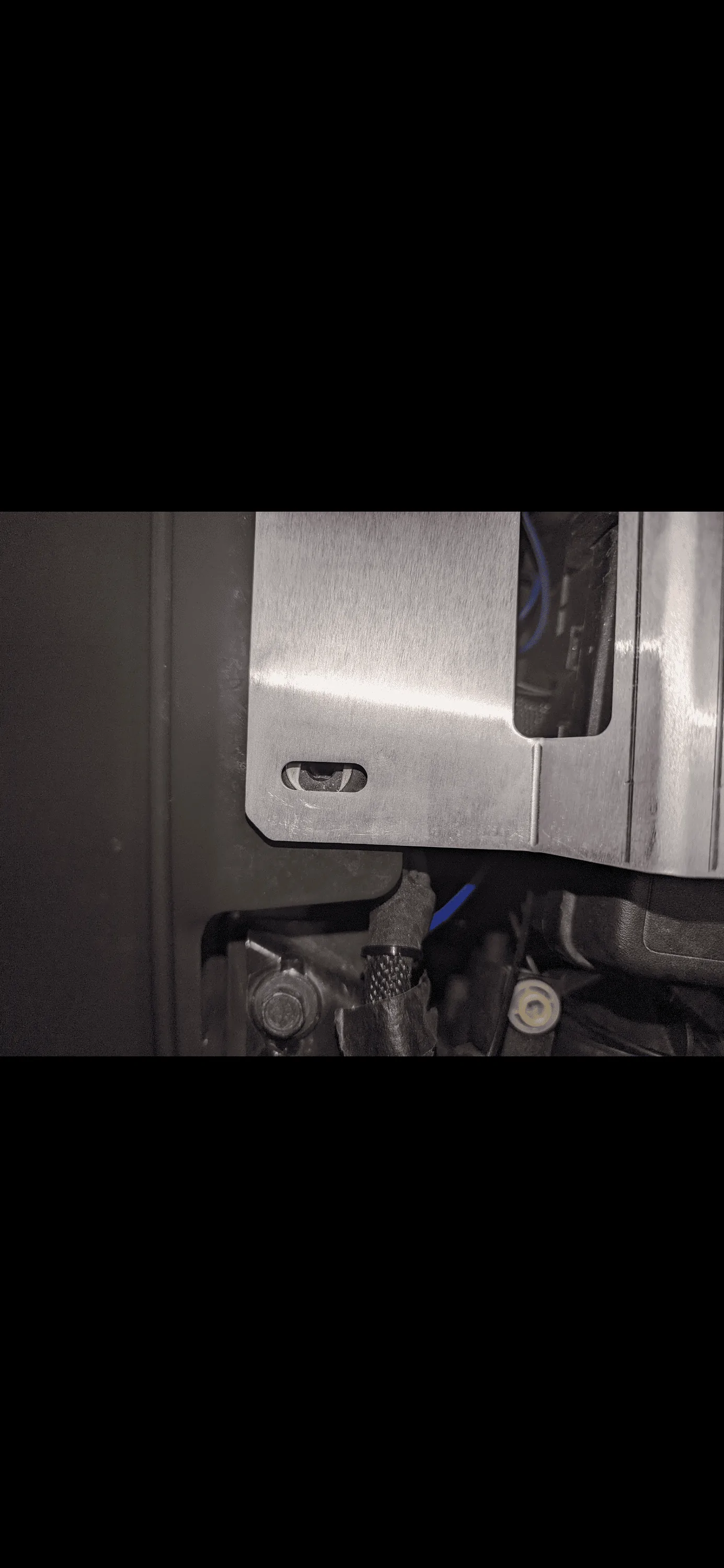

Thanks to 22EcoDs for testing the Under hood electrical plate! He has confirmed that using the electrical plate of the diesel fuse box is possible. The hole pattern is slightly shorter so with the current batch of plates I have in stock you will need to enlarge one of the holes slightly to make the plate fit. I will adjust for that in the next batch I have produced. See attached photos of the fitment test.
Jeep Gladiator Warn power interrupt kit - switch question Screenshot_20230215-214729
Jeep Gladiator Warn power interrupt kit - switch question Screenshot_20230215-214741
Jeep Gladiator Warn power interrupt kit - switch question Screenshot_20230215-214754
Looks great man. Trying to figure out similar clean mounting solution
