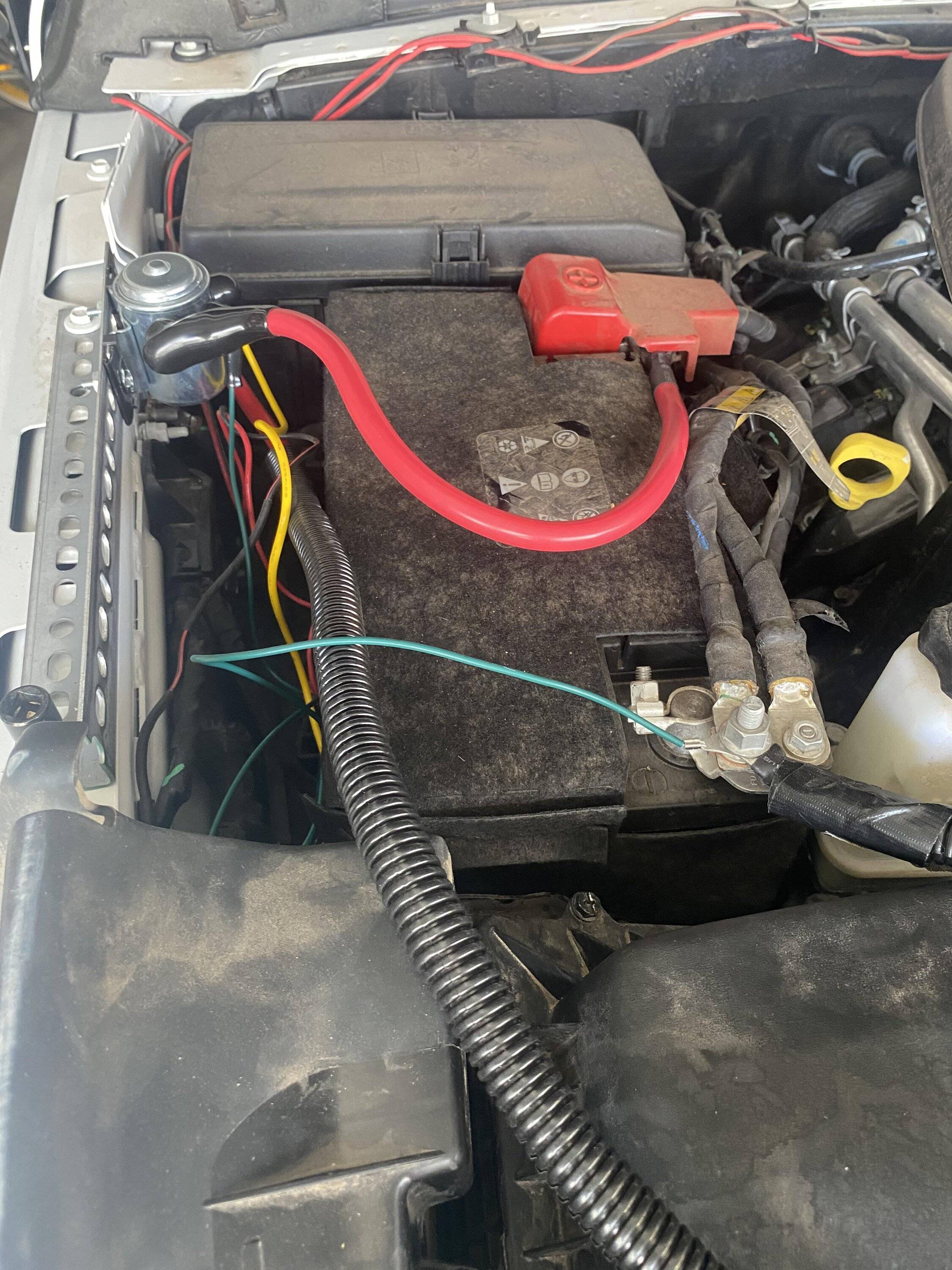

I see no issues having the interrupt switch right next to solenoid until you wire up your in cab aux.
The use case is to power the winch when you need it, and stop it in case of an emergency (I.e. the solenoid on the actual winch gets stuck or frozen in the on position). Whenever you want to use the winch just pop open the hood and turn it on with the temp warn switch, and be ready to kill it if needed. Here’s my interrupt solenoid mounted next to battery. I have the interrupt solenoid wired to aux 2. I got that bracket at Home Depot for a few bucks.

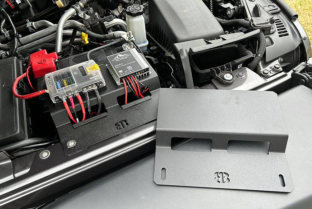

I have so much aluminum and steel stock on hand and often run batches of customer parts through powder coating I prefer my own custom-made stuff to fit how and where, and I can change whenever needed.
I found a blue powder that's pretty close to the color of my truck and plan on powder coating my solenoid bracket blue after I mode it a bit to make it more sleek.
I'm torn on leaving the plow isolation circuit bracket I made polished aluminum like I made it, or color it blue powder.......can't see much of it anyway with all of the wires there.
But this one is going to get tweaked and made blue to match the truck -

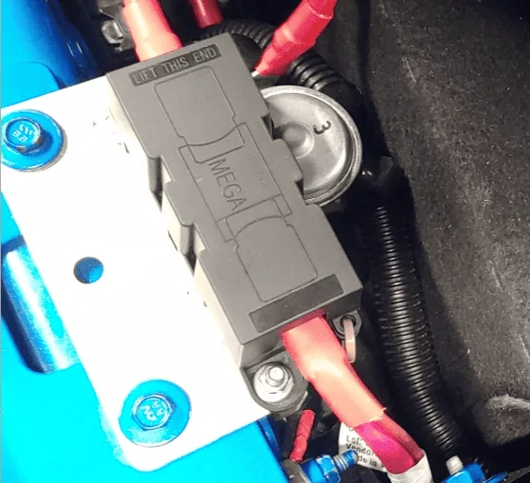

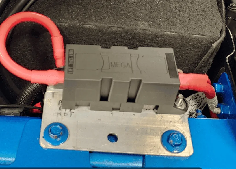

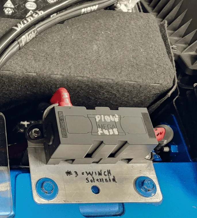

Really like the addition of the Mega fuse block! What amp fuse are you using?

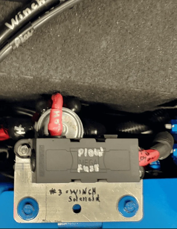

That's the snow plow fuse - 200 amp.
I have since re-routed the cable to the fuse.

Thanks for the response. At first look I thought the fuse was in line with your winch circuit. I have thought a fuse in the winch circuit would be a good idea. Not sure what amperage the winch draws.

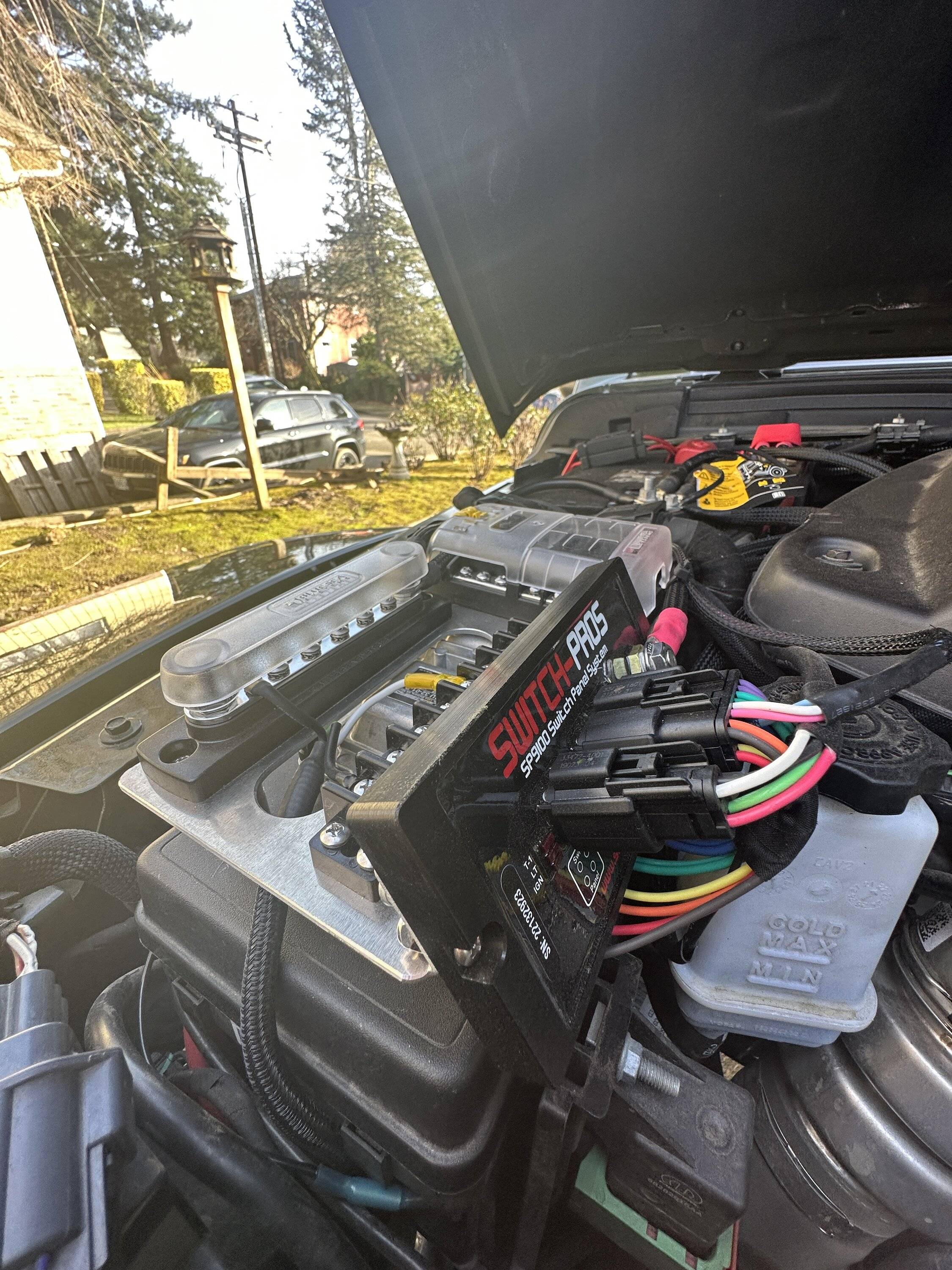

i used the Powertrays universal over my diesel fuse box, it works perfectly for us diesel guys.
Depends on the winch. Some at full power pull well over 400.
I run a cable from the battery positive to one side of the winch solenoid.
From that same terminal, I go with a short cable up to that plow fuse.
That way I'm using one cable to power both winch and plow since they will never be operated at the same time (not physically possible anyway)
Then of course from the output of the solenoid - to the winch.
Both the plow and winch have negative cables running up to the battery. It would be nice if I could tie the winch negative to the plow negative and have one single ground cable going up to the battery. May consider that some day but it would mean a junction out there "somewhere" so again, maybe not.
