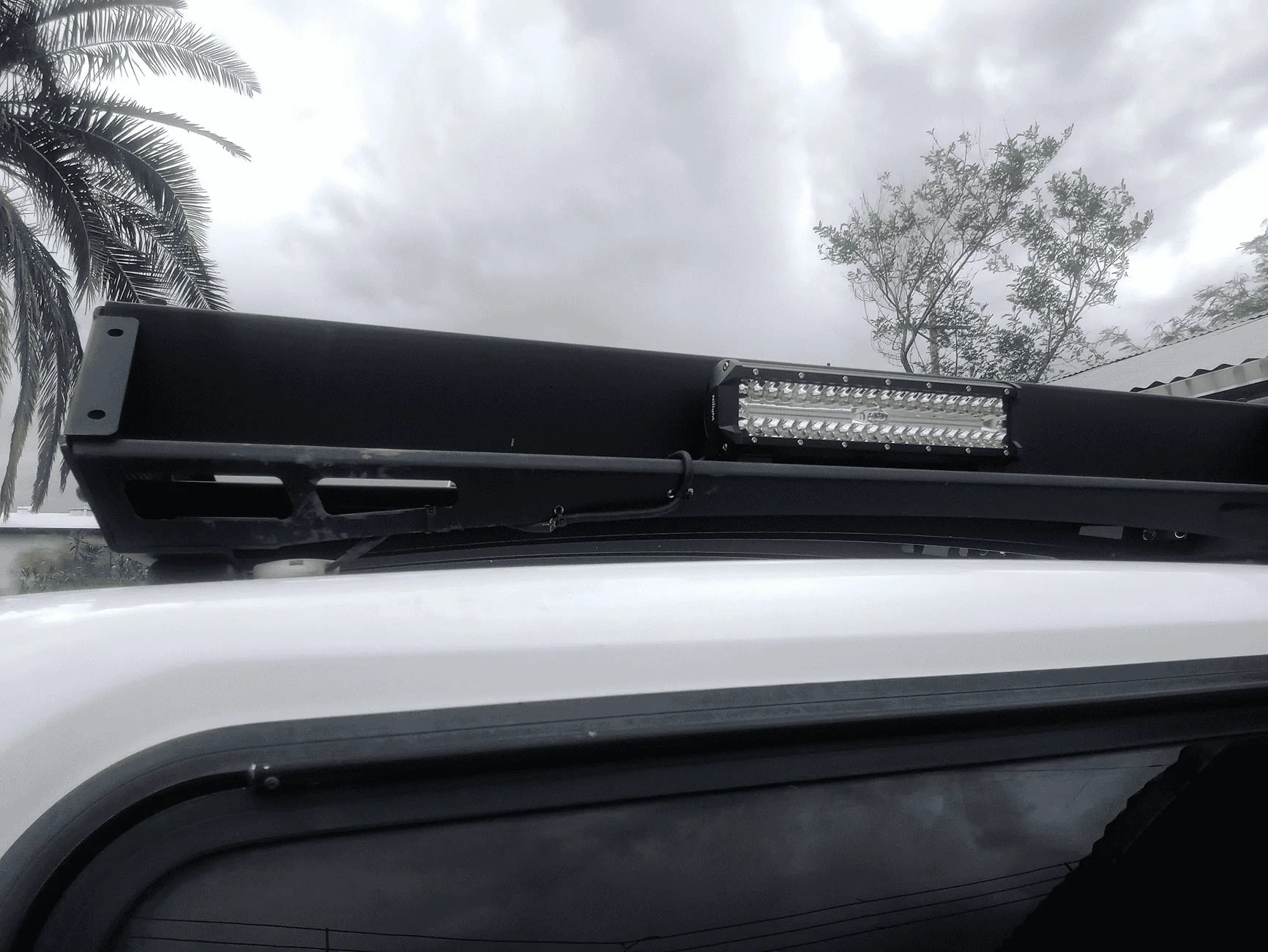

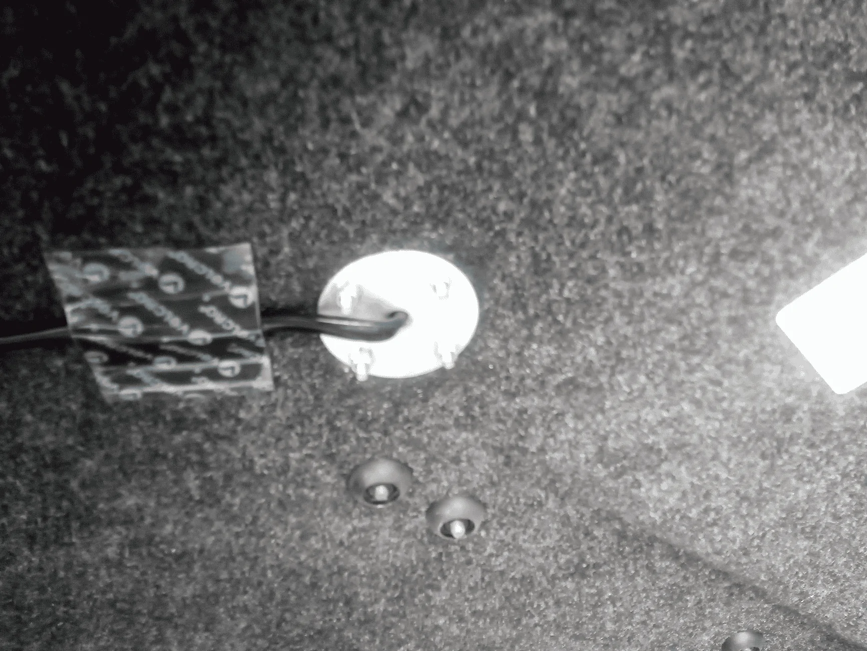

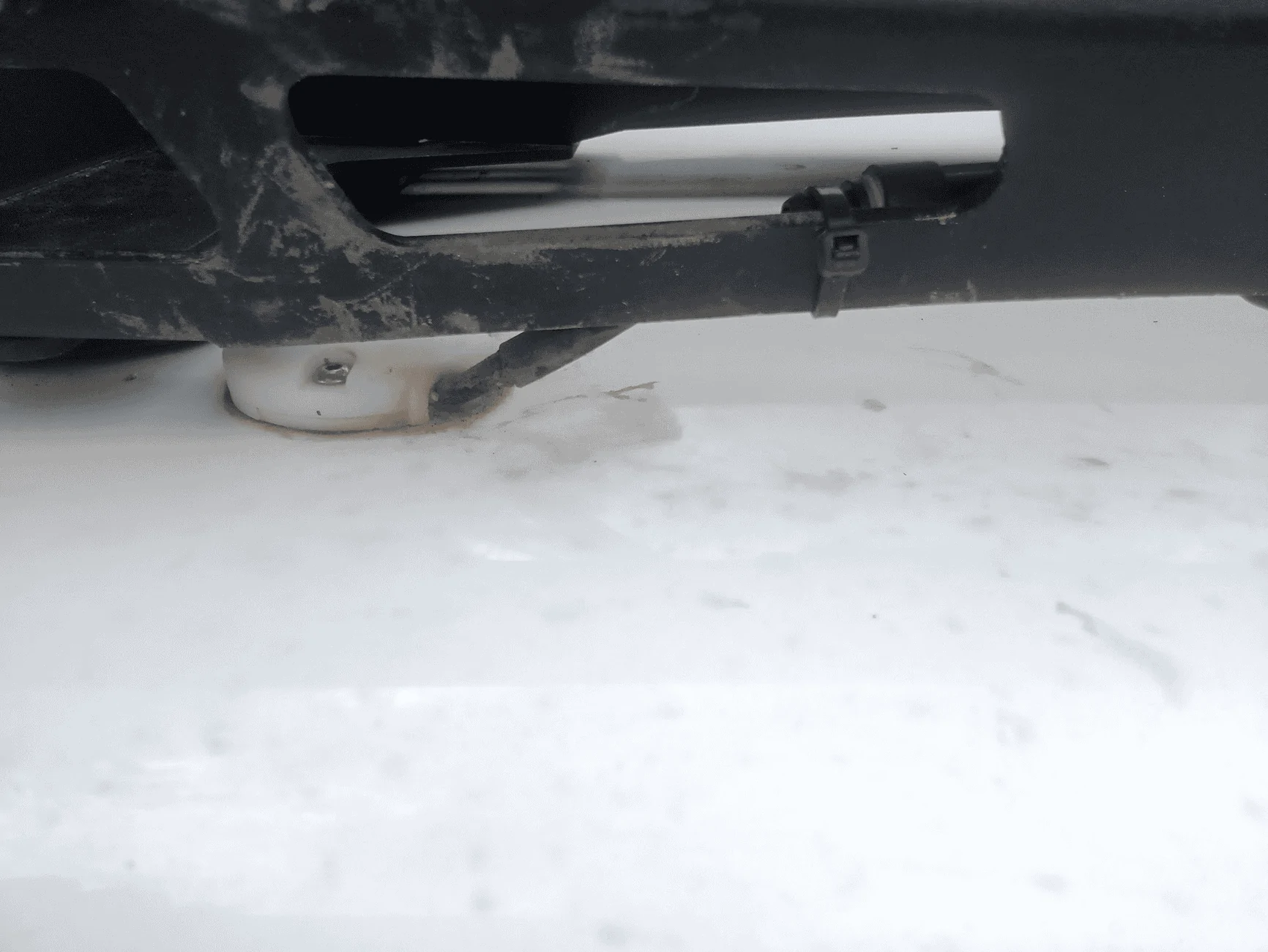

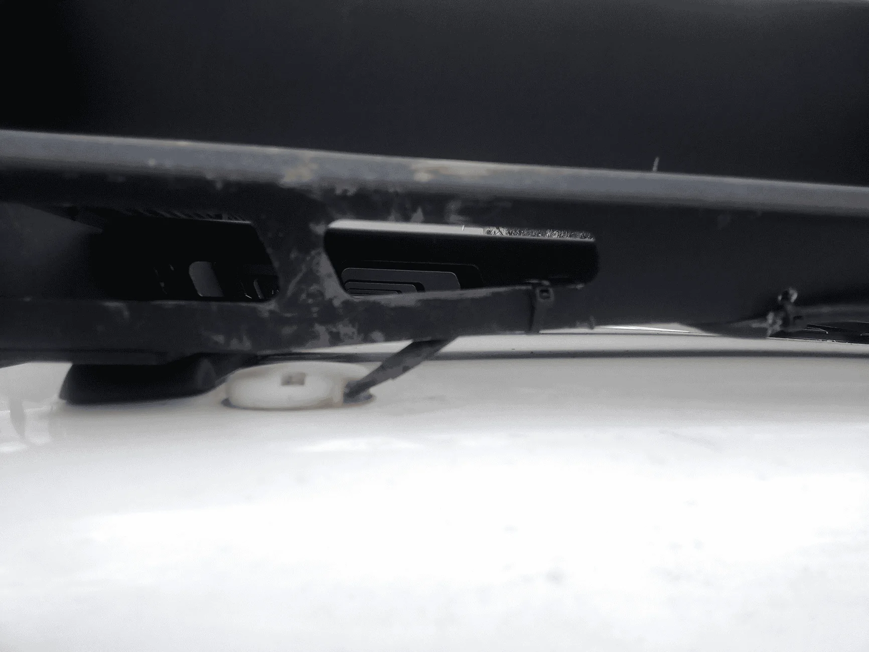

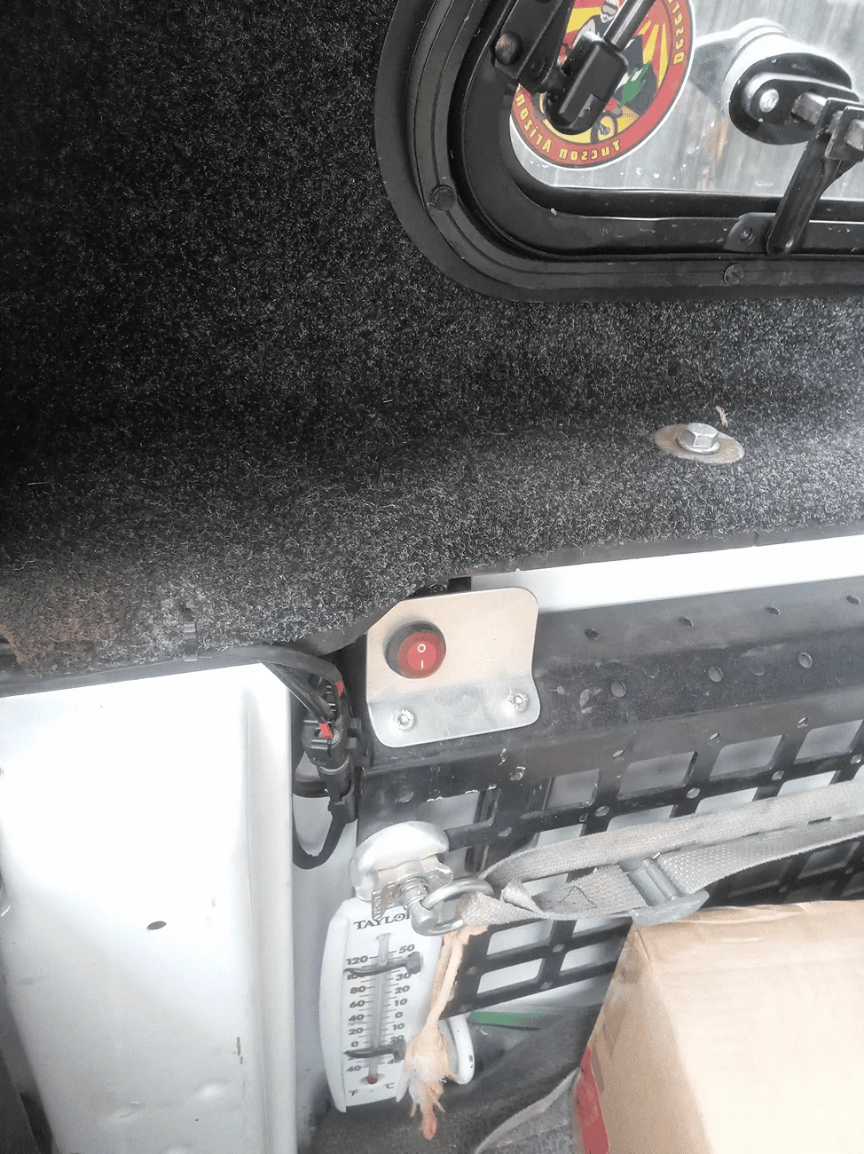

here are some follow up pictures if anyone cares.
Jeep Gladiator Water Proof Cable Gland for Topper? 1724265240554-bn
Jeep Gladiator Water Proof Cable Gland for Topper? 1724265289250-lm
Jeep Gladiator Water Proof Cable Gland for Topper? 1724265305855-2d
Jeep Gladiator Water Proof Cable Gland for Topper? 1724265326465-ps
Jeep Gladiator Water Proof Cable Gland for Topper? 1724265687294-bl
Just looking at the photos, man just a little silicone attracts all the dust. When it's not so hot i need to get out there with some cleaner, it's not as sloppy as the pictures make it.
