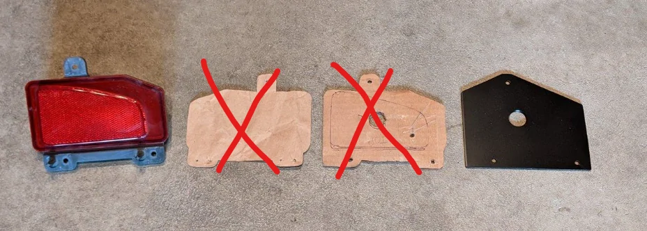

Awesome ideas here! Any chance you'd be willing to share the dimensions of the custom plate you made to delete the reflector? I want to to 3d print a temporary solution to test out my plumbing.
Might just pull one off of your JT and go from it mirror for other side.
Sorry not active on here since the JTR is gone, but as noted, just remove the OEM reflector and trace the outline of it on a piece of cardboard... that is how I did it in post #1.
There's no need to get fancy with outlining the mounting tabs like I did. Just keep it super simple and make one plate, drill the (3) mounting screw holes, set it in place to determine your (1) large spigot hole, drill and done. There's plenty of space behind the bumper to accommodate the entire plate and not have to replicate the OEM shape.
