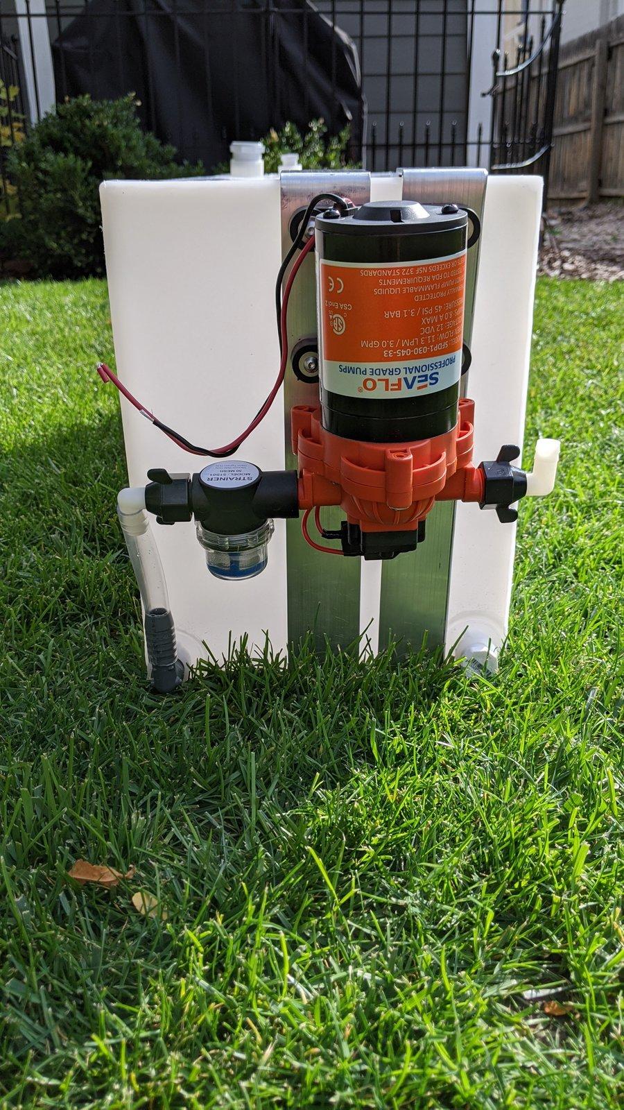

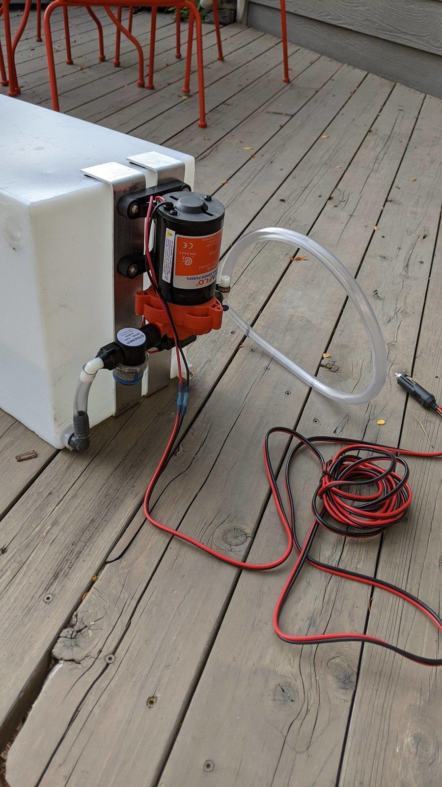

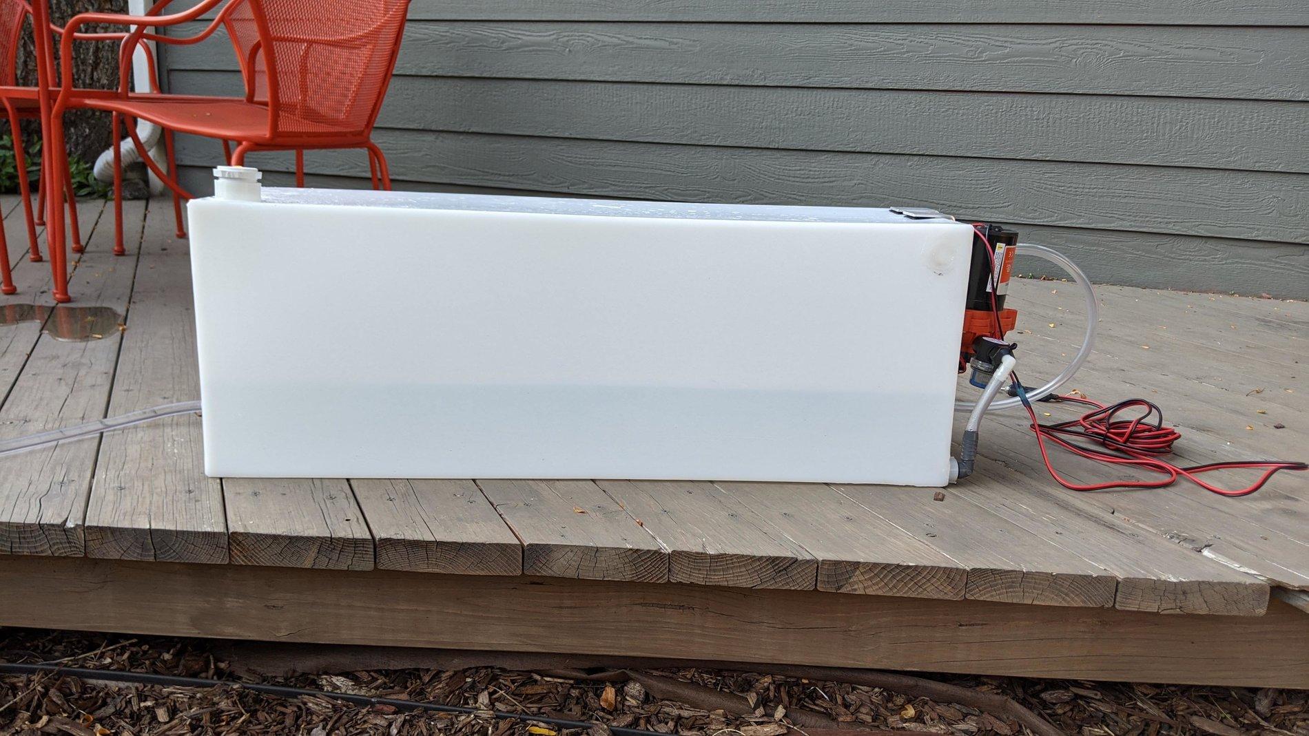

I'm looking at building a similar water system and I wonder how this has been working out for you. Specifically, any durability concerns with the tank... chafing, bulging, leaks, etc.? And also, do you experience any noticeable effects from water sloshing side to side while off-roading in tippy or dynamic situations?
Thank you for a great write-up.

none what so ever. The drawer system that buts up against the plastic tank is lined with carpet so that eliminates any rubbing issue.
