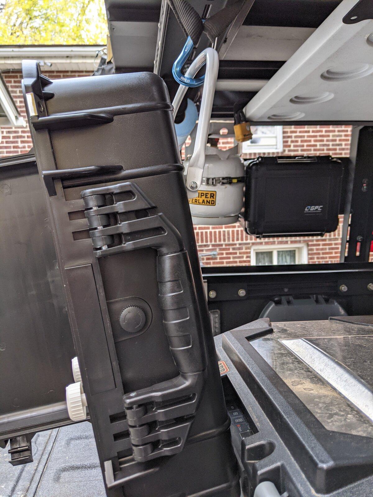

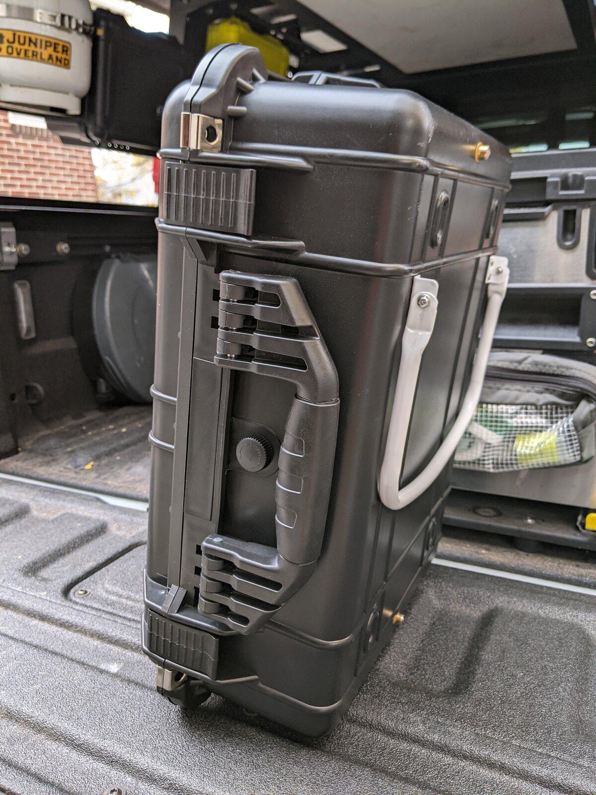

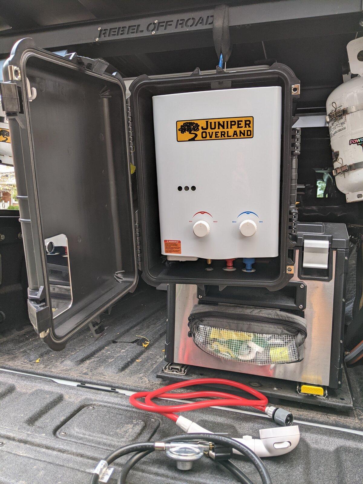

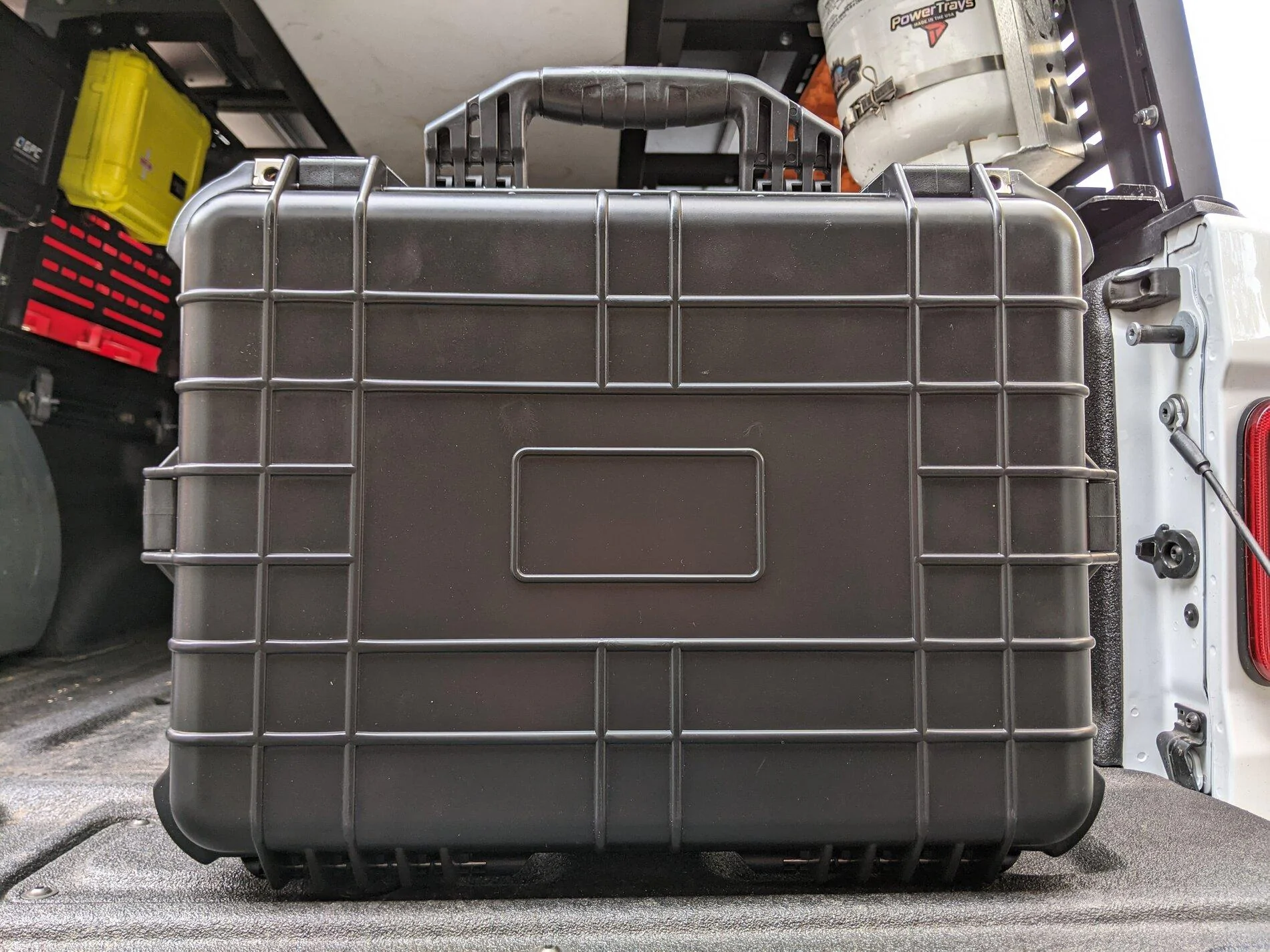

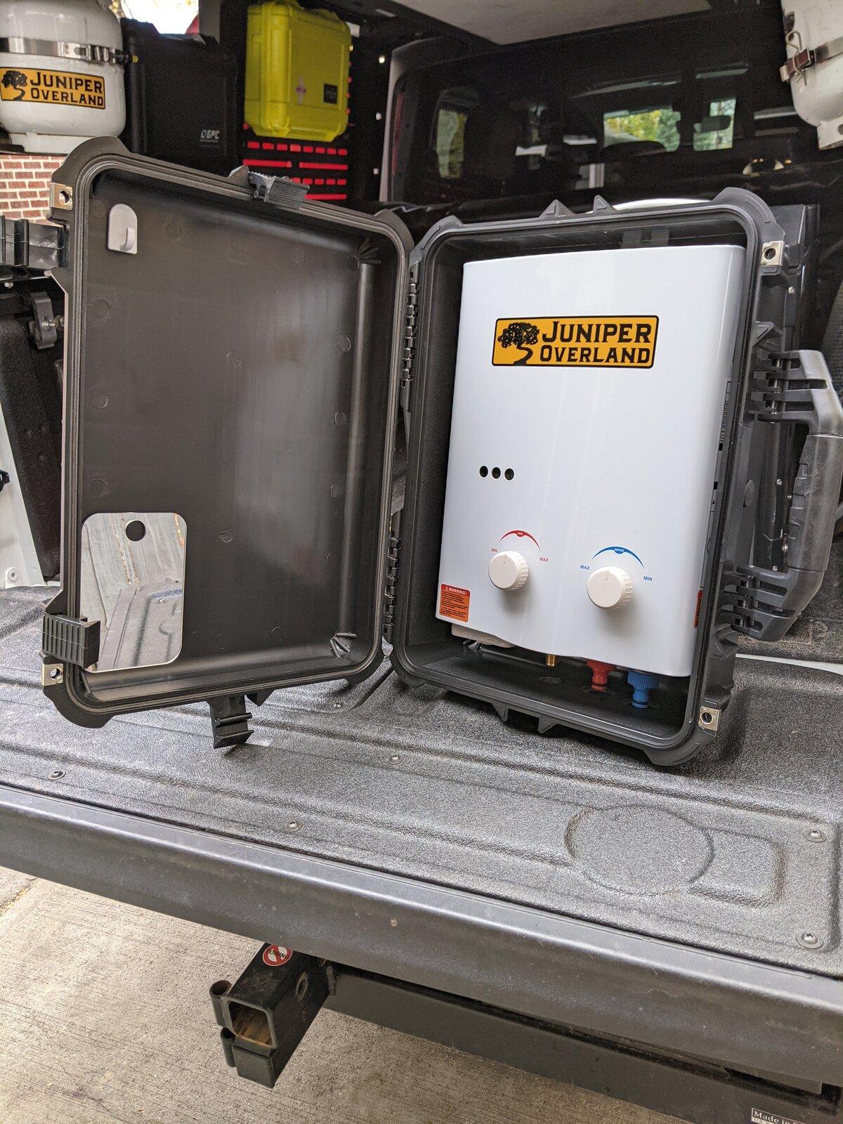

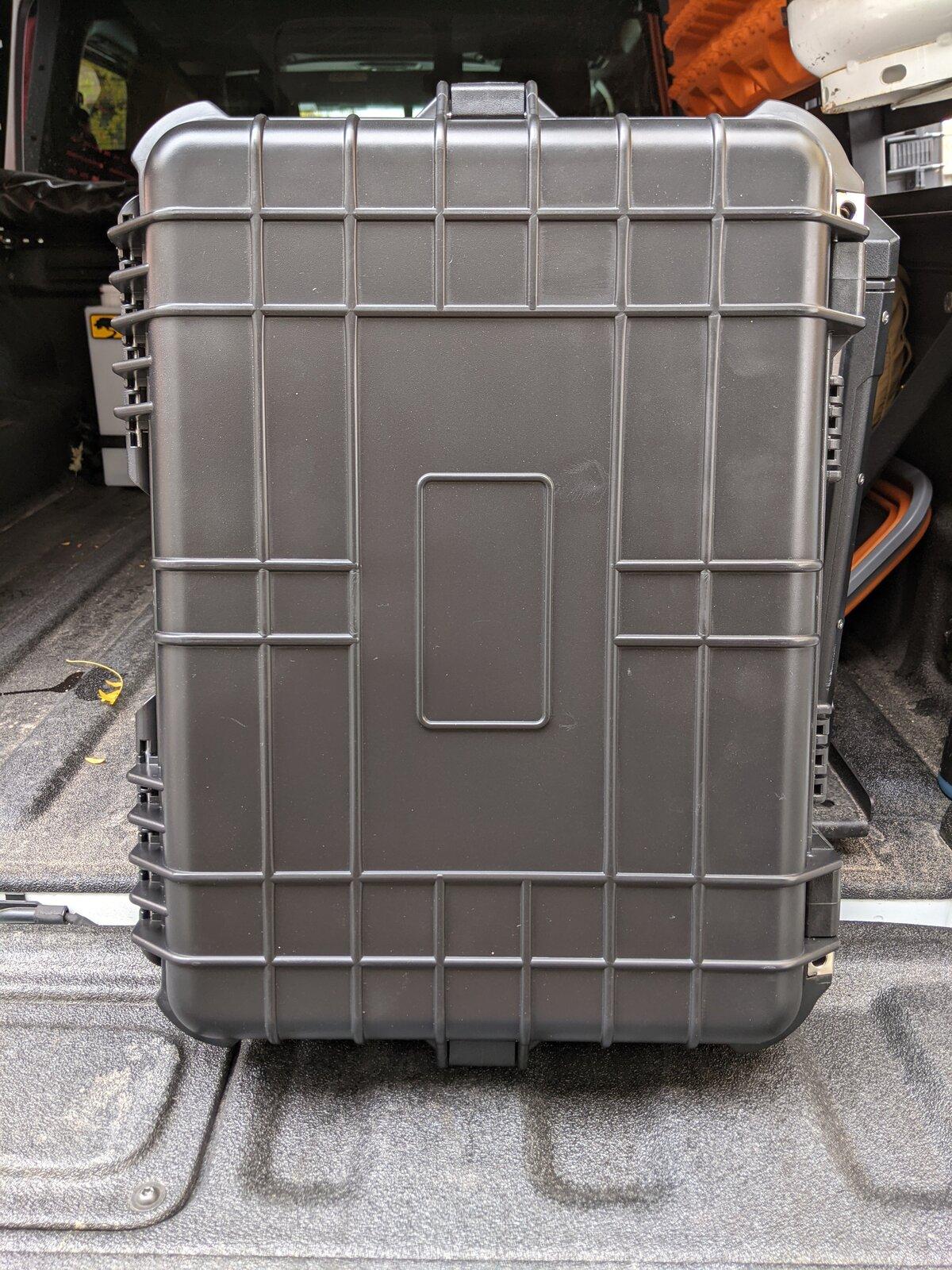

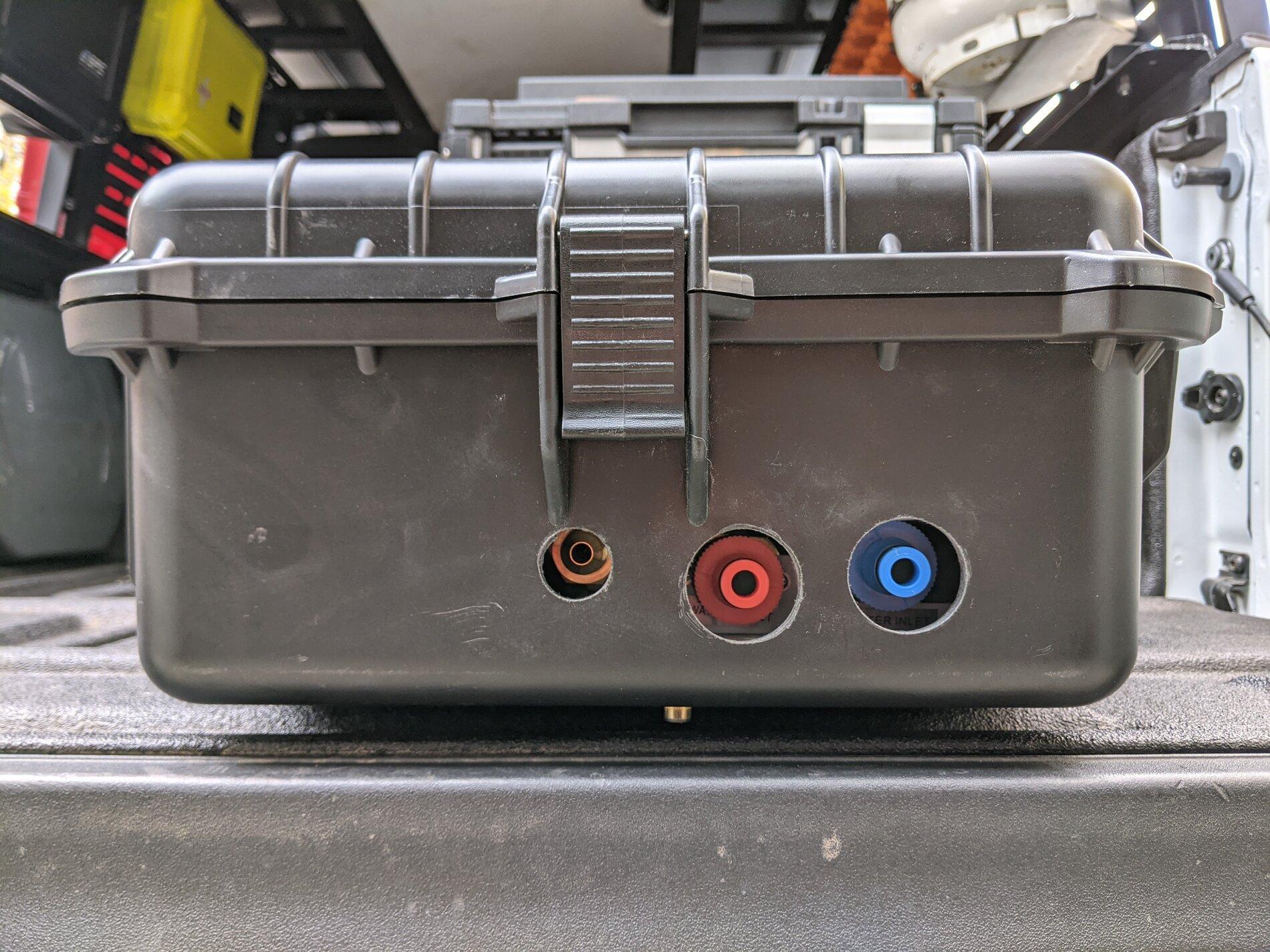

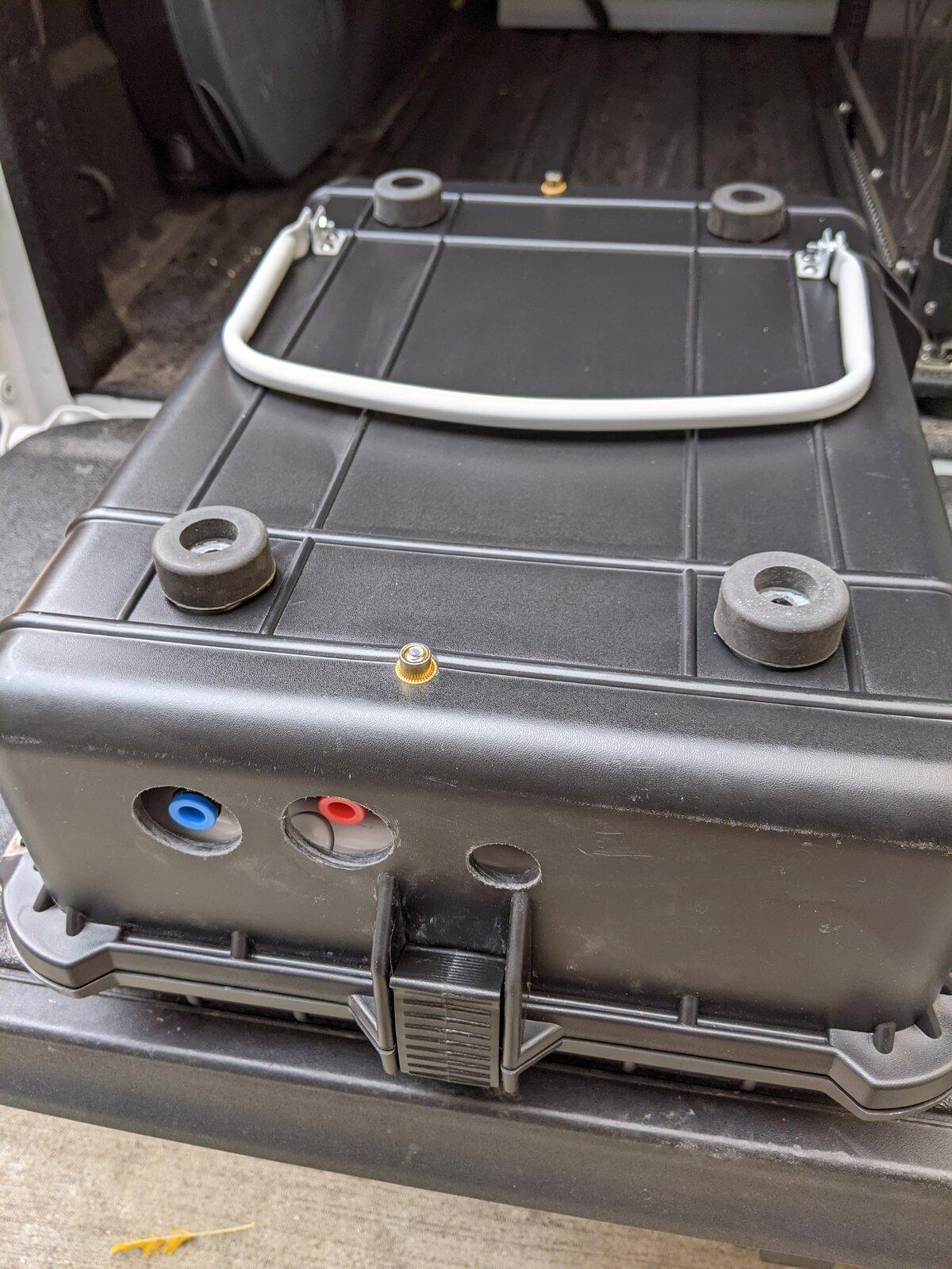

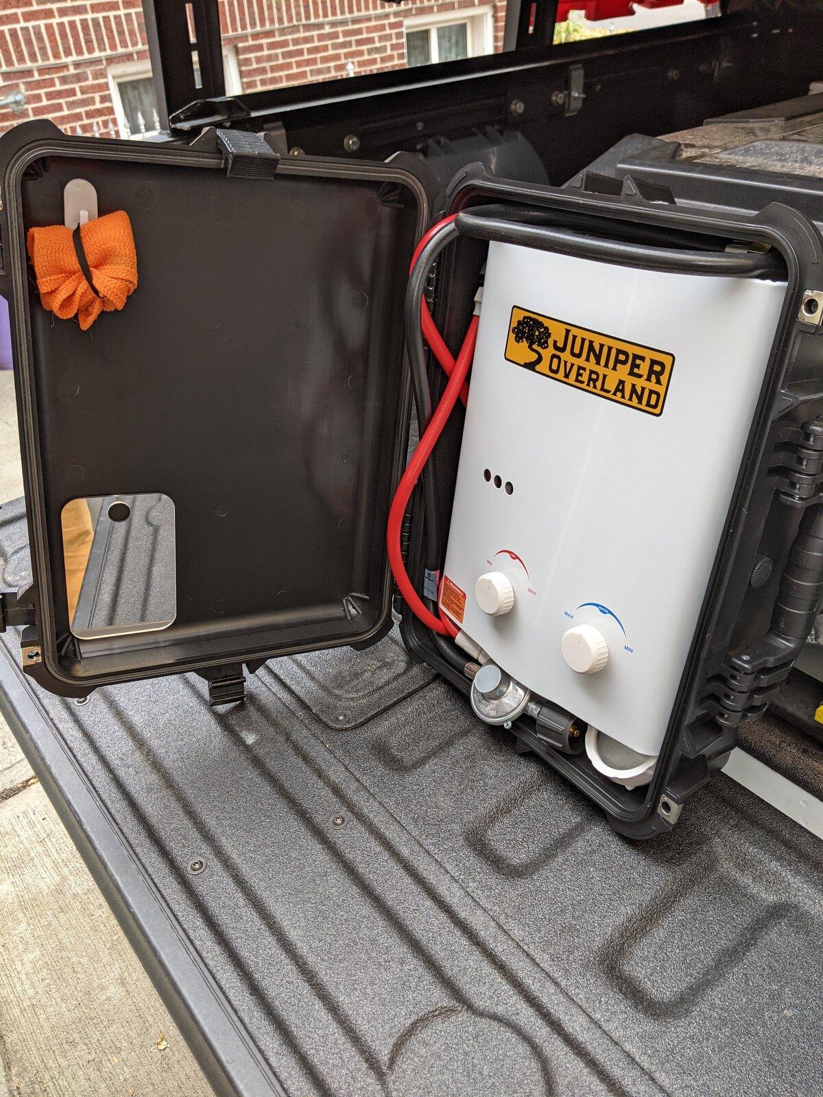

Hey everyone,
I always get a lot of interest in my hot shower at expos so I figured I'd put together a brand new, fully complete kit for sale. Don't know if anyone will actually buy one or if they just like the idea :) Anyway, I made up (1) complete box and figured I'd offer it up here.
Some of the highlights of this "new" design include...
1) More compact size case that still nests both the shower wand and propane hose
2) Quick disconnect water input and output fittings
3) Mirror and wash cloth hook
4) Side carry handle and rear handle for hanging shower box if not mounting
5) Vibration dampening rubber feet included for hard mounting to camper or truck bed rack
You just need a propane source and water hookup for endless hot water on your next adventure!
I'll post it on the Members Sale section but figured most of the people in this thread would be interested more than the general masses.

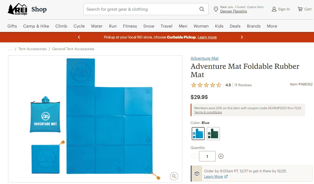

Darkhorse13, what is the Adventure Mat you have in your picture in one of the early posts on this thread? I assume its something to stand on when you are getting a shower.
thanks
Van
My friend turned me onto this company over 3 years ago and they are great! So compact and durable. We just leave it in the shower kit. I actually need to buy another to leave in the RTT for the base of the ladder.

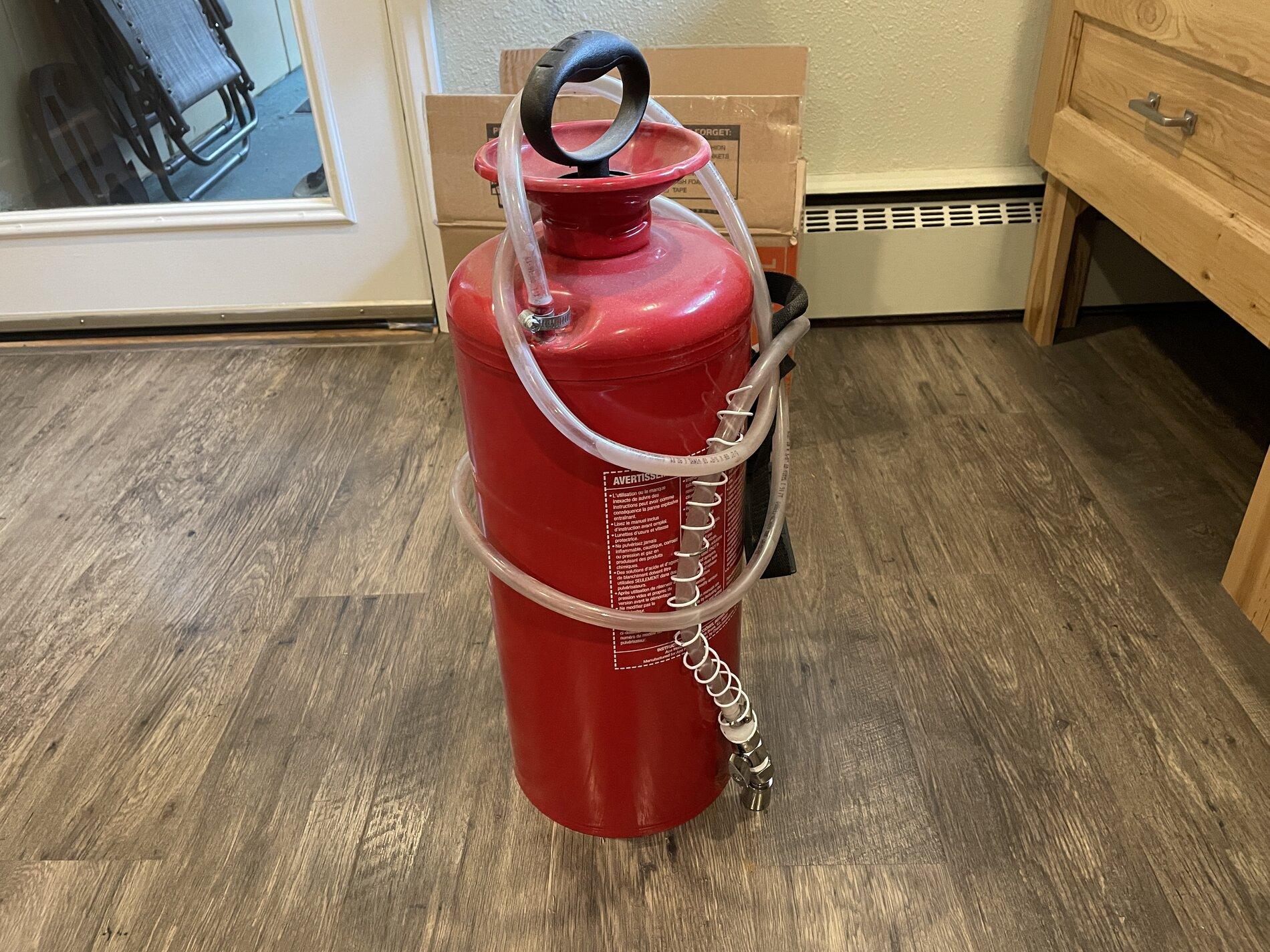

Back in 2013, we experienced a 500 year flood in the canyons above Denver/Boulder. No gas for hot water, but we had electricity for the well pump and electric stove. I got a metal bodied garden sprayer from ACE, put some PEX tubing and a shower head on the end of it. Heat water up however you like (stove, fire, sun, engine, etc.), fill it up with whatever hot/cold mixture suits you, pump it up, and you're good to go. Plenty for me to get a full shower with water to spare. My wife has enough to shower, including washing her hair. Not as slick as some of the above options, but I can't imagine I have more than maybe $20 in it...
Jeep Gladiator Shower / Hot Water on-board system IMG_3065.JPG
My wife dug the camp shower out this weekend for washing windows, and then this thread came to the top of the feed. I'm going to revise my cost estimate up because it's a bigger/nicer sprayer than I remember. I also need to add a wire coat hanger and a band clamp to the build list. The hose is not PEX either (not sure why I thought it was come to think of it); just flexible vinyl tubing. The coat hanger makes it so you can hang and reliably aim the shower head. The sprayer has/came with a strap that makes it easier to hang and carry around when it's filled with hot water (the body isn't insulated). Still way cheaper and more versatile than a lot of the "camp shower" options for sale out there. Also, easily and inexpensively rebuildable (good luck finding parts for a lot of those units when they break down a few years from now).

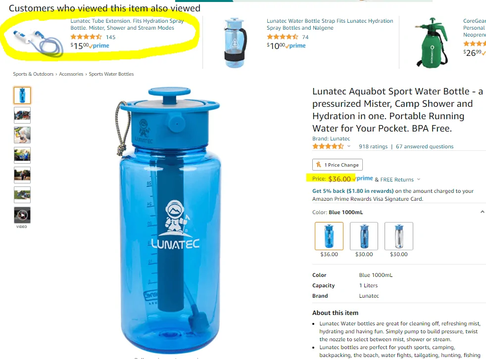

In my opinion, the Lunatec Aquabot is the most versatile and cost effective solution on the market. It's a high pressure sprayer, water bottle and shower mister (wand/hose sold separately) all in one. More compact than anything out there and it only takes a 50/50 mix of cold water + Jetboil hot water to have a lovely hot shower. Yes, you can get a full body rinse off (not including a headful of hair) with just this bottle.
Jeep Gladiator Shower / Hot Water on-board system 1637175072246
