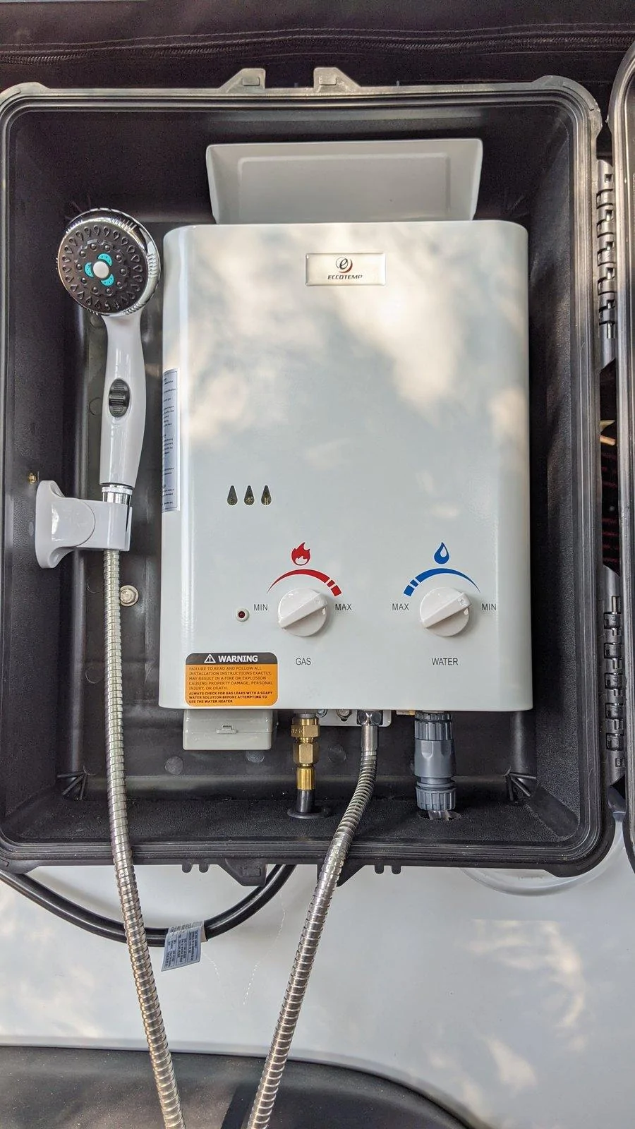

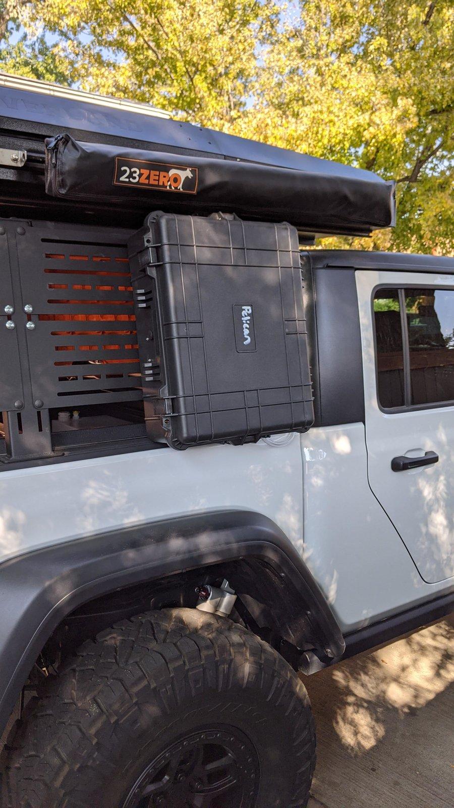

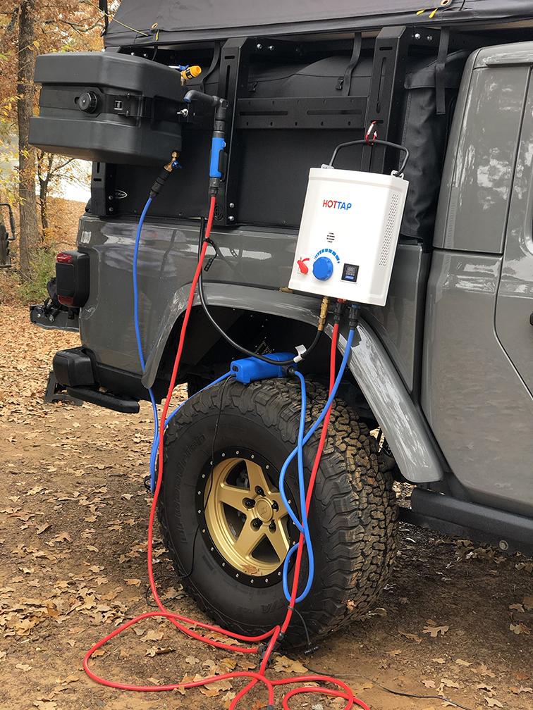

I'll admit it, my wife and I love a good camp shower after a long day of MTB'ing. The Rebel Off-Road rack keeps shining with it's endless mounting configurations so I decided to add an EccoTemp hot water shower under the 23 Zero cube. All it takes is a propane source and a 12v water pump to enjoy a rinse before bed.
I went with a SEAFLO 3.0 GPM 45psi 12V pump from Amazon with 1/2" OD barb and some tubing to match from Home Depot. I also added a quick disconnect at the shower end to remove the tubing when taking out the tank in the bed for winter. Just hook up the shower to the 10lb propane tank, squeeze the trigger and you're clean!
Treat yourself to a hot shower on the next adventure or keep your hands from freezing while doing dishes in the morning... or both.

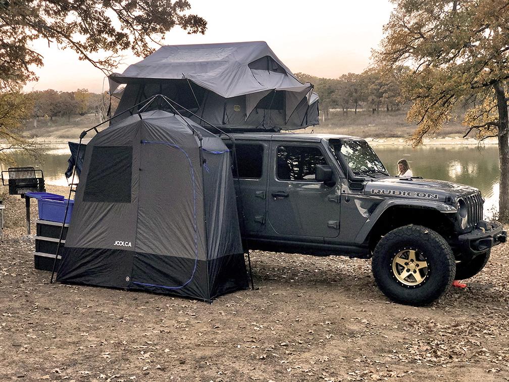

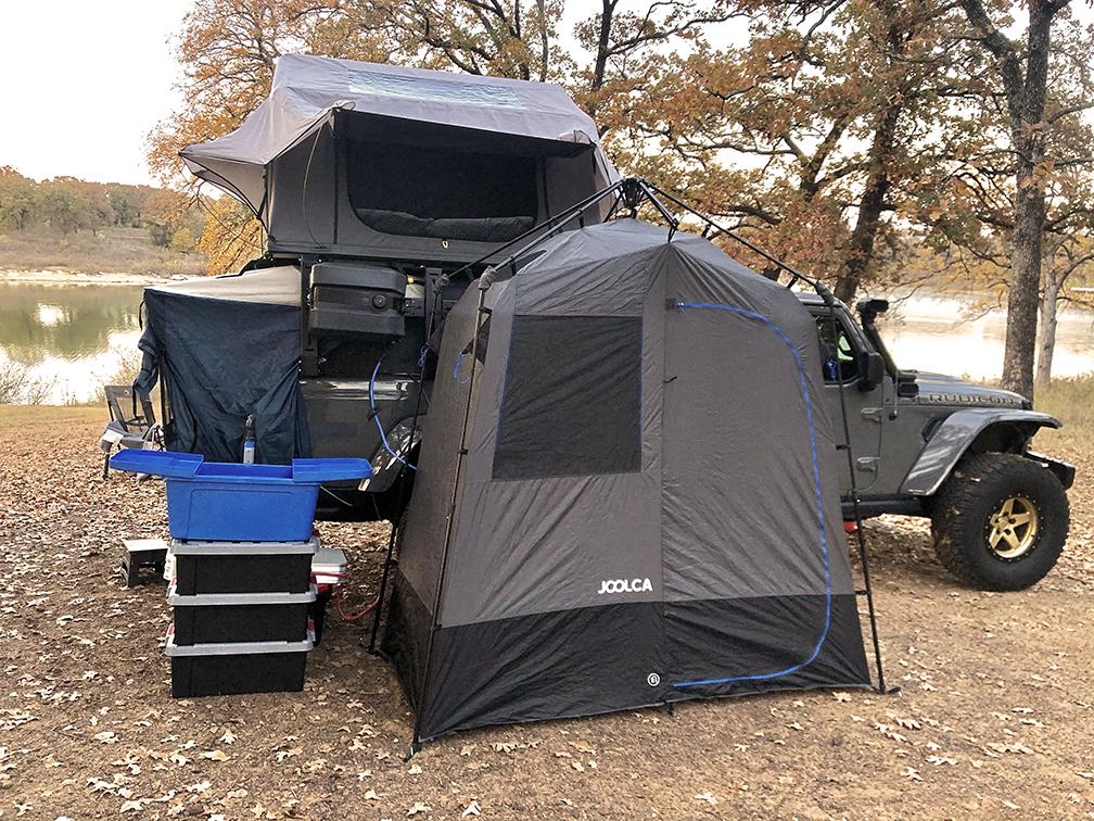

Finally got to fully set up my shower/sink set up and use it this past weekend.
Jeep Gladiator Shower / Hot Water on-board system shower2
dual ensuite, makes it really nice to shower and change clothes/doubles as a closet or toilet area.
Jeep Gladiator Shower / Hot Water on-board system shower1
Sink set up.
Jeep Gladiator Shower / Hot Water on-board system shower3
closer look at the water tank and heater set up.

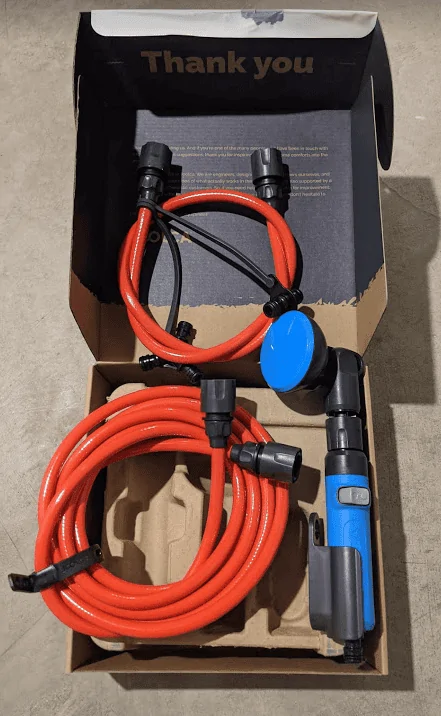

FWIW, my wife and I used the Lunatec Aquabot (with tube extension) for quite some time and loved it too. We did about 1/2 cold water and 1/2 Jetboil water for a nice HOT shower. This will easily clean off a dirty body and even a short hair cut kinda head if you conserve it. Just another option :)
Jeep Gladiator Shower / Hot Water on-board system 1615844780891
Jeep Gladiator Shower / Hot Water on-board system 1615844959393
Jeep Gladiator Shower / Hot Water on-board system 1615844814829
Love these too... good lather and very sanitary/easy to dry

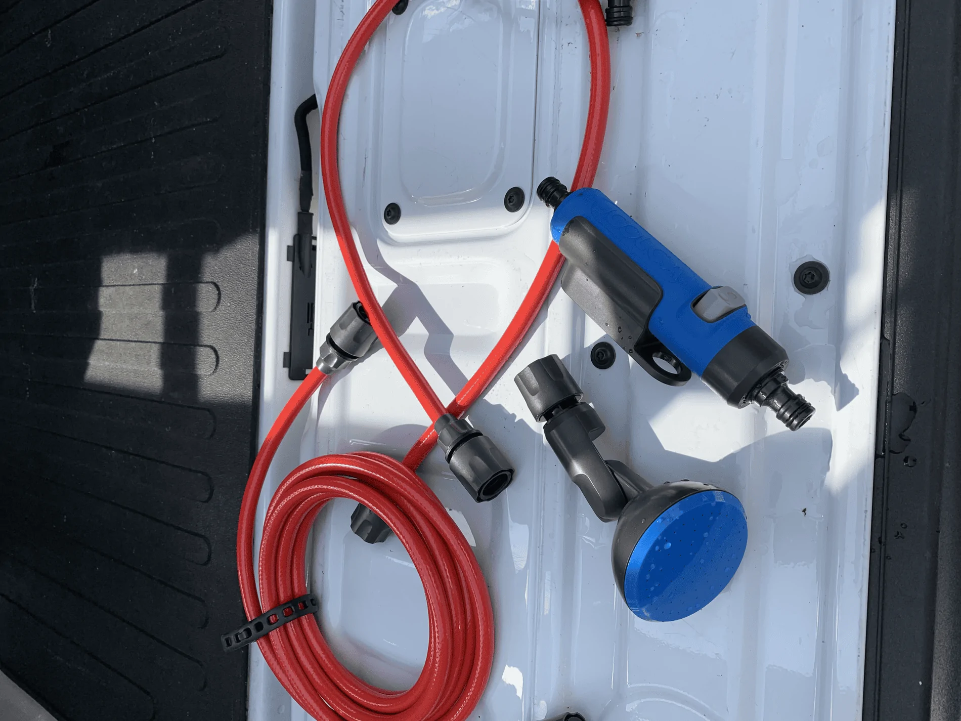

Also, the wand that comes with the Eccotemp shower is garbage and already broke. I ordered the Joolca En Suite Plumbing kit and this wand if far superior

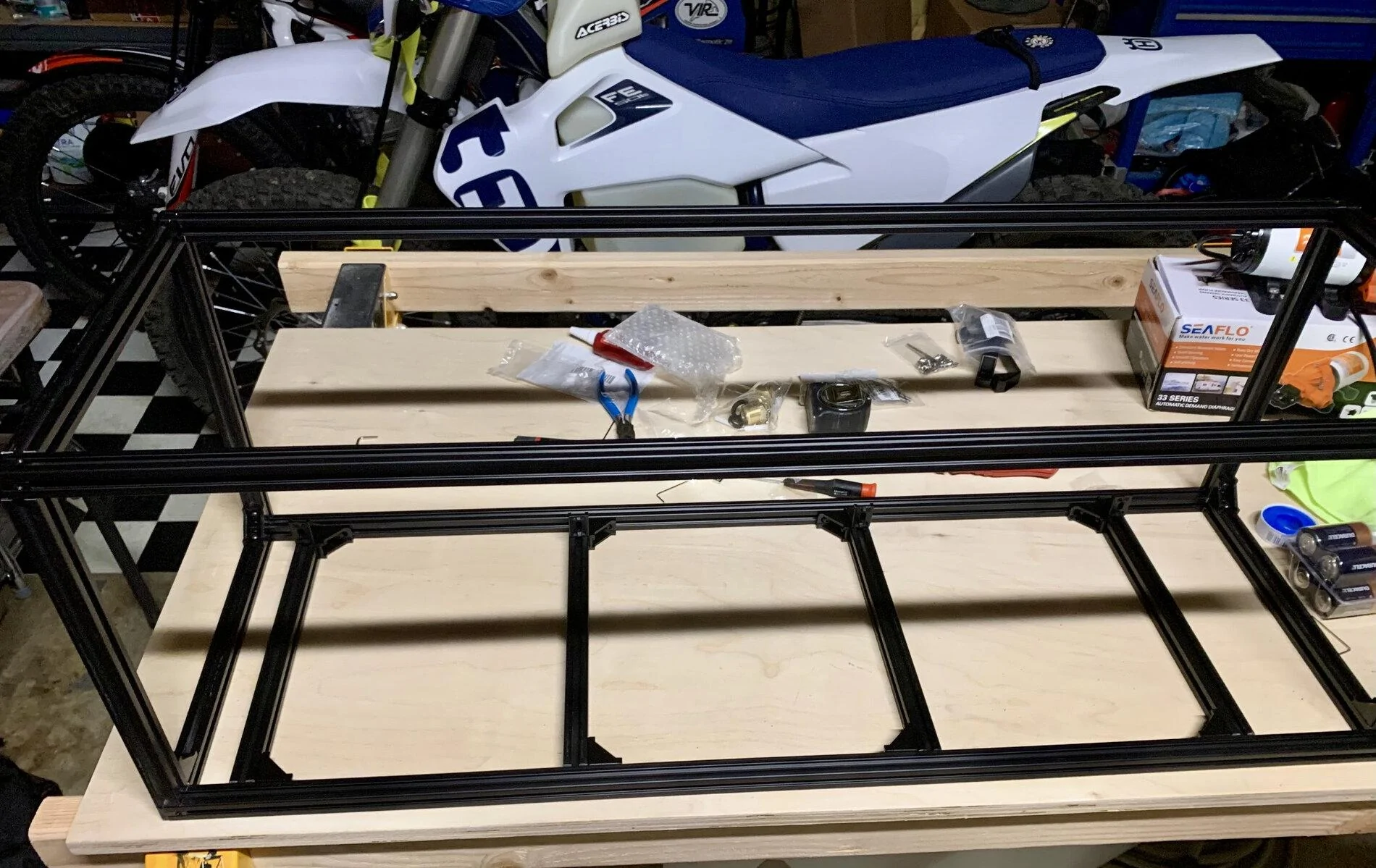

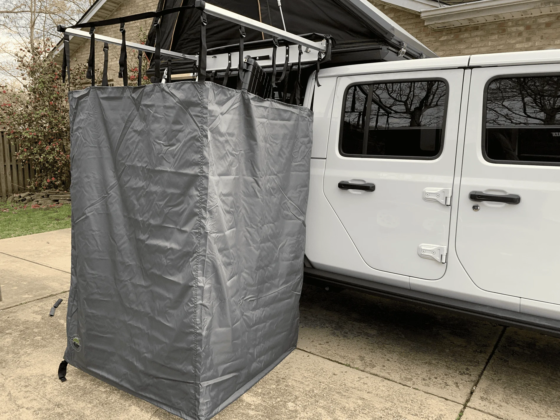

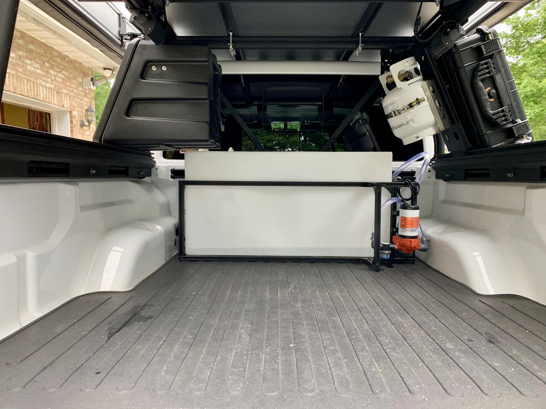

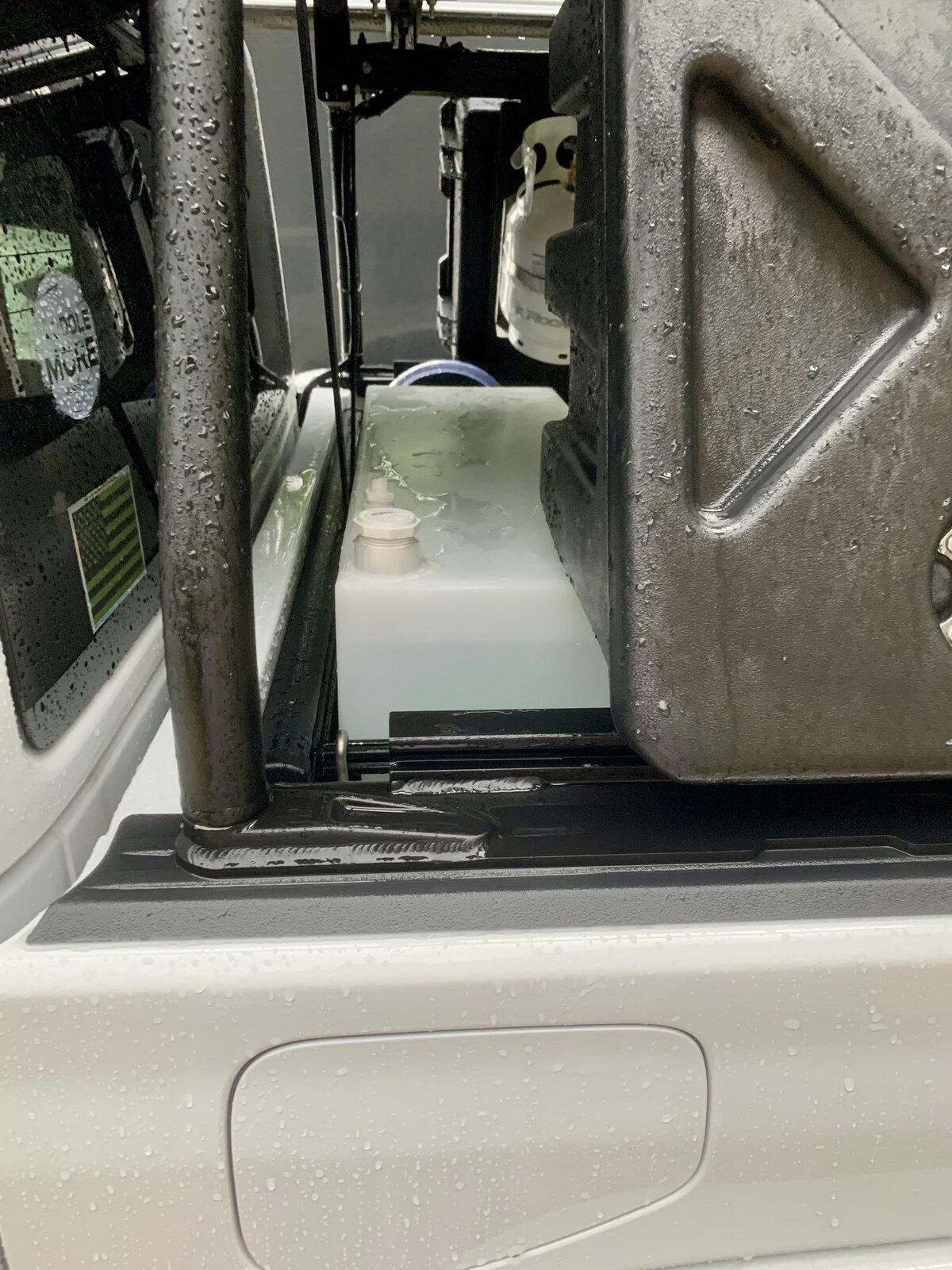

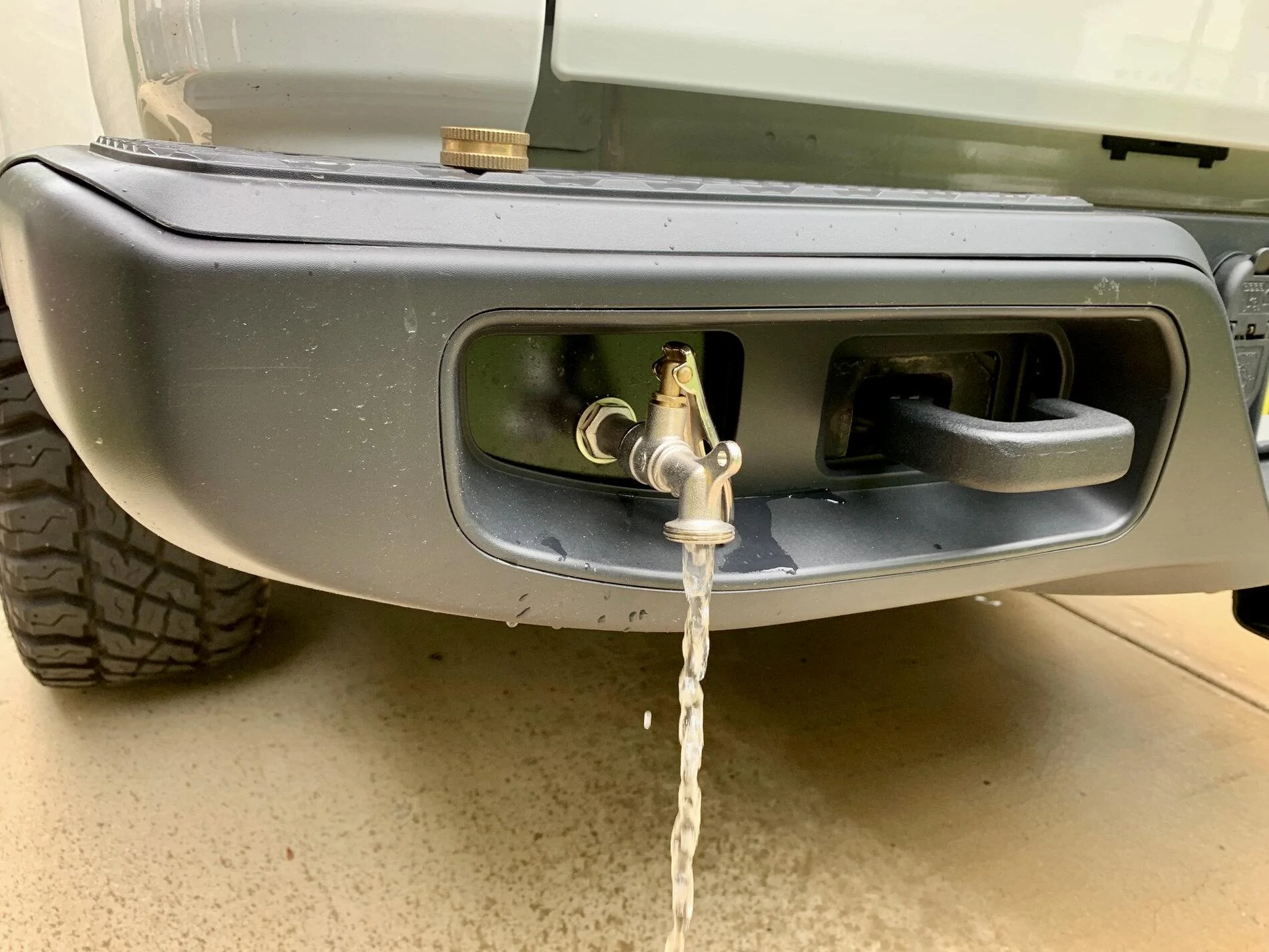

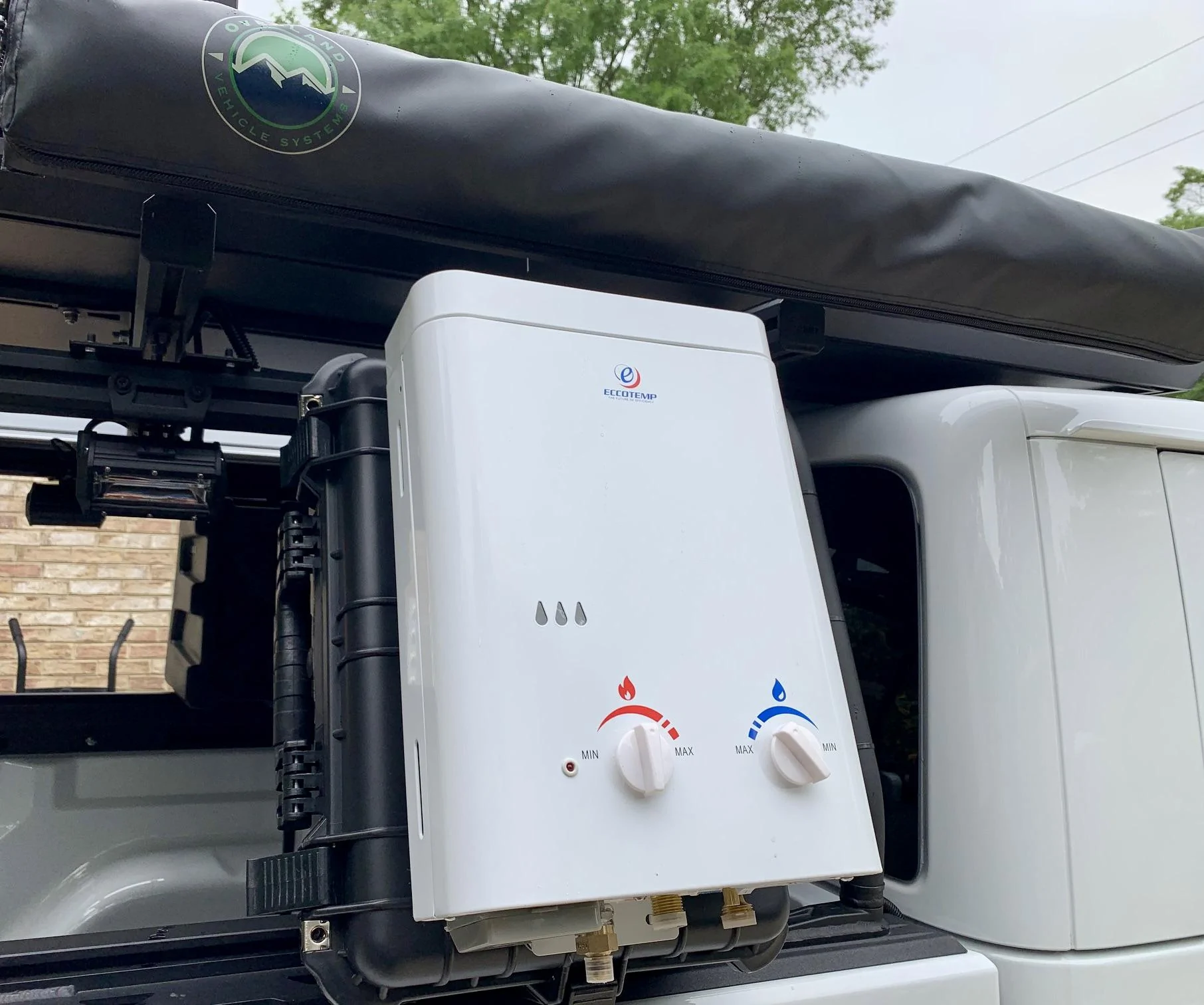

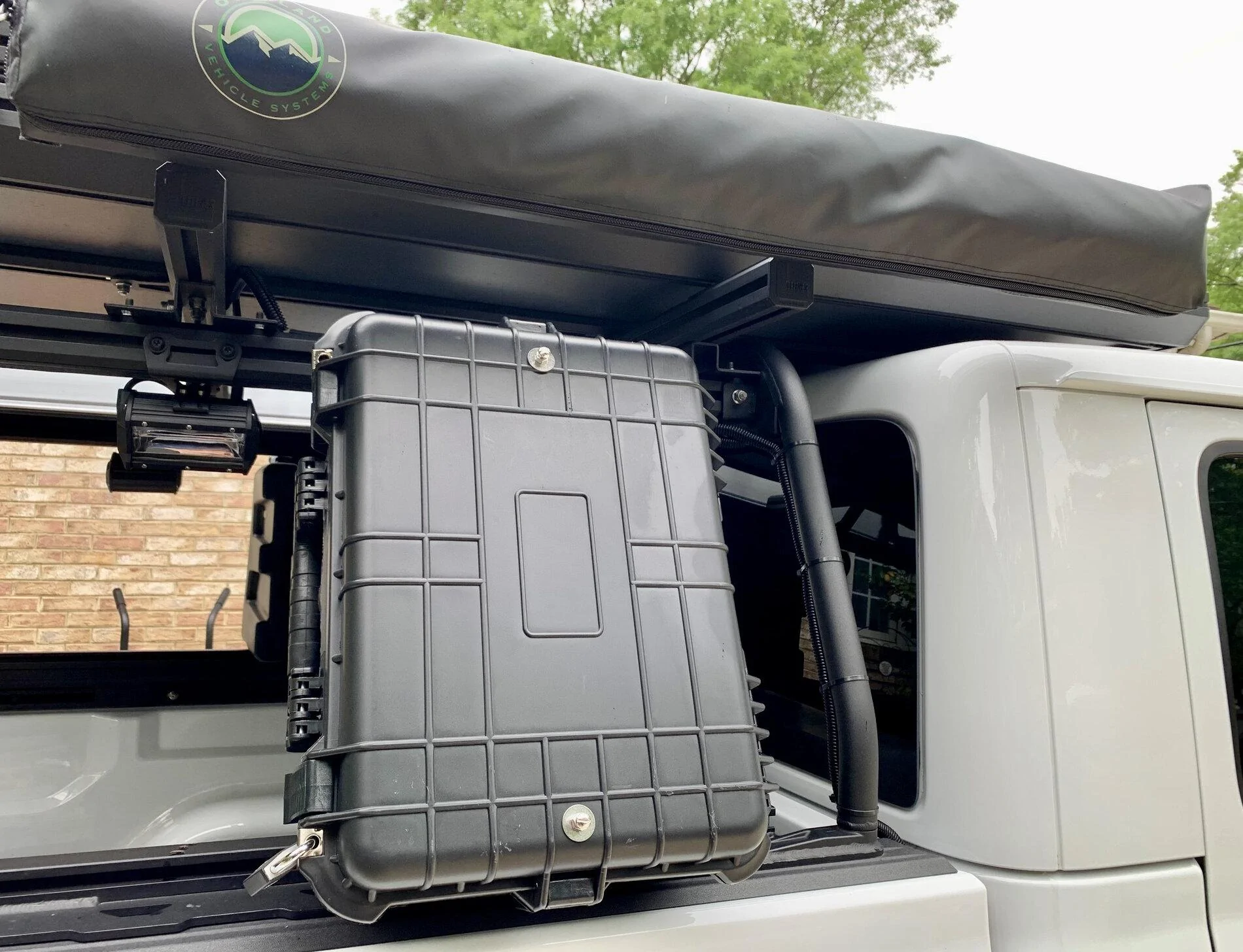

@darkhorse13 thanks again for answering my pms and posting this diy. Finally have ours put together, and very happy with the setup. Didn't bother to fool around with the Eccotemp shower head and right away ordered the Joolca as you posted. An OVS shower room to match our 270 degree awning. Just a few things I did differently, we wanted the option to carry a little more water in case we do some cleaning at our rural property. Ordered the 32 gallon tank, basically same size as the 20 gallon you posted but 5" taller. In doing that I knew I had to build some sort of frame for support so I had ordered some 20/20 T track to play with. The harbor freight 4800 case was exact fit for the Eccotemp, so instead of hacking it up to vent and holes for provisions in the bottom for attachments, just decided to put a couple of stainless bolts on the outside and hang the eccotemp off it, to make it work
Jeep Gladiator Shower / Hot Water on-board system tempImageisPDgh
Jeep Gladiator Shower / Hot Water on-board system 100CCD22-8C06-4046-9C97-DC44946CFC74_1_201_a
Jeep Gladiator Shower / Hot Water on-board system tempImageYjBrfF
Jeep Gladiator Shower / Hot Water on-board system 050146B8-F9DD-427F-8055-E1D99DCAC613_1_201_a
Jeep Gladiator Shower / Hot Water on-board system 7604EB6B-9D24-4466-94A8-128859E07489_1_201_a
Jeep Gladiator Shower / Hot Water on-board system 160CFF33-48BA-46EE-8948-4F2248CF7DAC_1_201_a
Jeep Gladiator Shower / Hot Water on-board system 9A360C81-C0F3-40A2-AA6A-5CD4940F5DFD_1_201_a
. Other than that we followed your plan to the T. Thanks again, a few pics attached.

PHENOMENAL!!! Looks better than mine and love the water tank framing. Congrats and hope you enjoy it. You'll love the water spigot :)
I was thinking of pressurizing the spigot when I run the power washer at our rural place. Then again the other hose is pressurized, I could probably just find a quick disconnect for that. The frame worked out well, loosen a turnbuckle on each side and the whole unit slides out as you intended.
