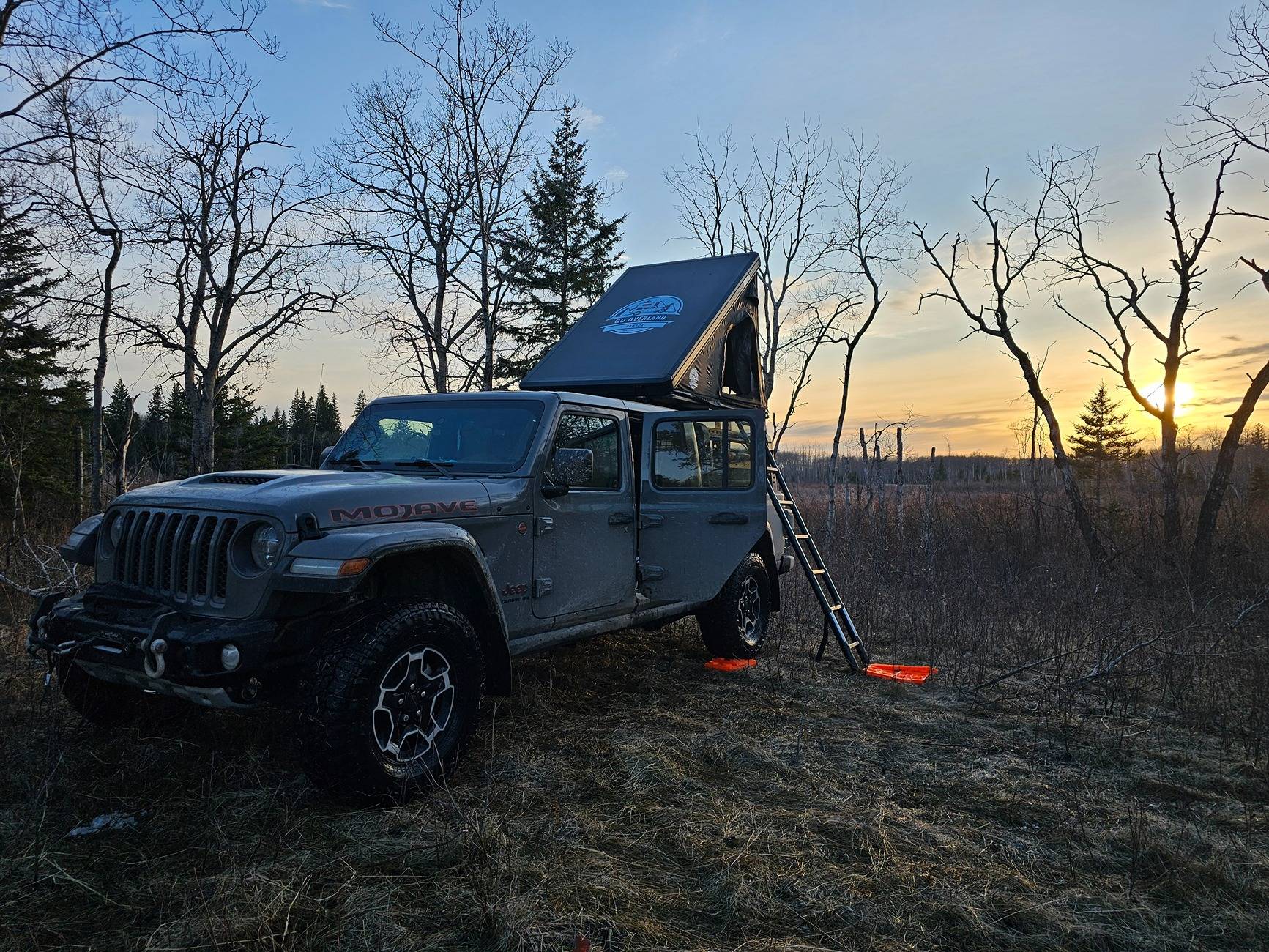

As the title says, went through some puddles over the weekend, I drive a 22 mojave with factory suspension, and I definitely had water lapping at the rock sliders, but I don't believe it exceeded the tires.
From what I can find, fording depth is reported to be 31 inches and some change for mojaves, and considering the tires are 33s (true size around 32s) I assume I should be fine? I wound up changing the rear diff oil after the trip as it was more or less due anyways, techs said front diff fluid looked fine, but I'm mostly concerned about the transfer case and transmission as I'm not sure what the story is about their breathers.
Debating on replacing T-case fluid, but I'm only at 22,000km and that feels like a waste if not needed. And ideally I'd rather not even touch the transmission yet, but I figured I'd reach out for some advice nonetheless. Any simple ways I can check trans/t-case for water without fully servicing them?
Photo of my camp setup attached just to show rig off a lil

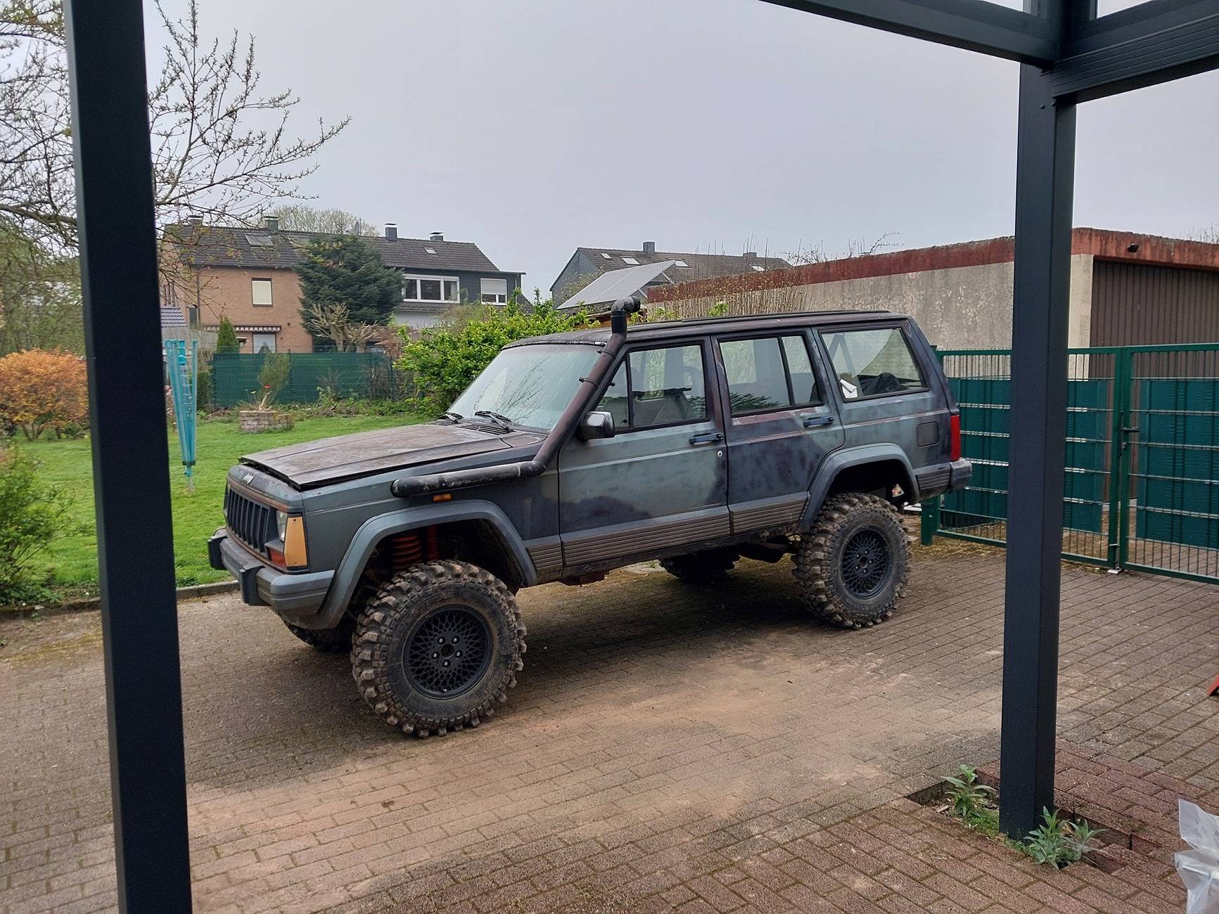

I wouldn’t do this, unless I was prepared to clean my radiator, trans cooler, alternator, pulley assemblies, brake slides, along with checking diff fluids. That said, I’ve been through a short water crossing that touched my lower door hinges, at around 3mph.
I have used the specified wading depth a few times. This was 7-8K miles ago and the truck showed no abnormalities since then.
Of course I cleaned it as good as possible after the "mud games" and for the next i bought another car ... ;)
