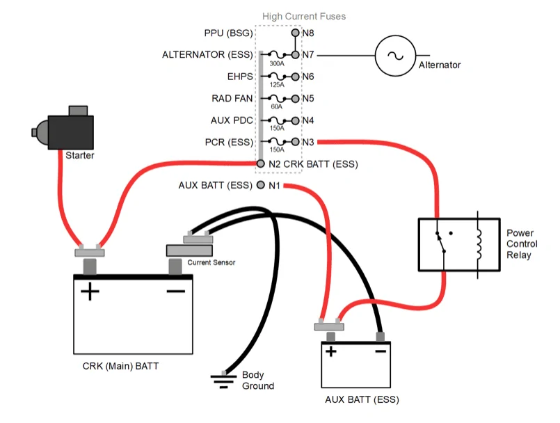

Soooo, update to the warning light.....after first dealer "forgot" about it, they never looked at it when in...took to 2nd dealer today.....verdict:
Door Switch. Apparently a faulty door switch that they have to order and replace as it is "drawing" on the battery thus the warning light...(weird since it is the ESS light illuminated)
There are two batteries. A motorcycle like battery for ESS and the main battery. When the ESS battery is "low voltage" you get the light. Also, depending on the temperature outside, hot or cold, the ESS will not "ready" and therefore won't engage.
If folks aren't daily driving the ESS battery can drain and cause lights and ESS not "ready" warnings. Some JL folks keep a battery tender on the "little" battery to avoid it and most dealers just replace it.
