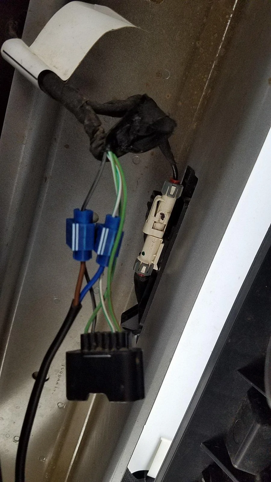

Well I wasn't able to determine if black was in fact a ground, but it seems to work. white with green stripe from the tailgate 4 pin plug is positive for brake, no signal for turn signals.
Now my topper has a 4th brake light.

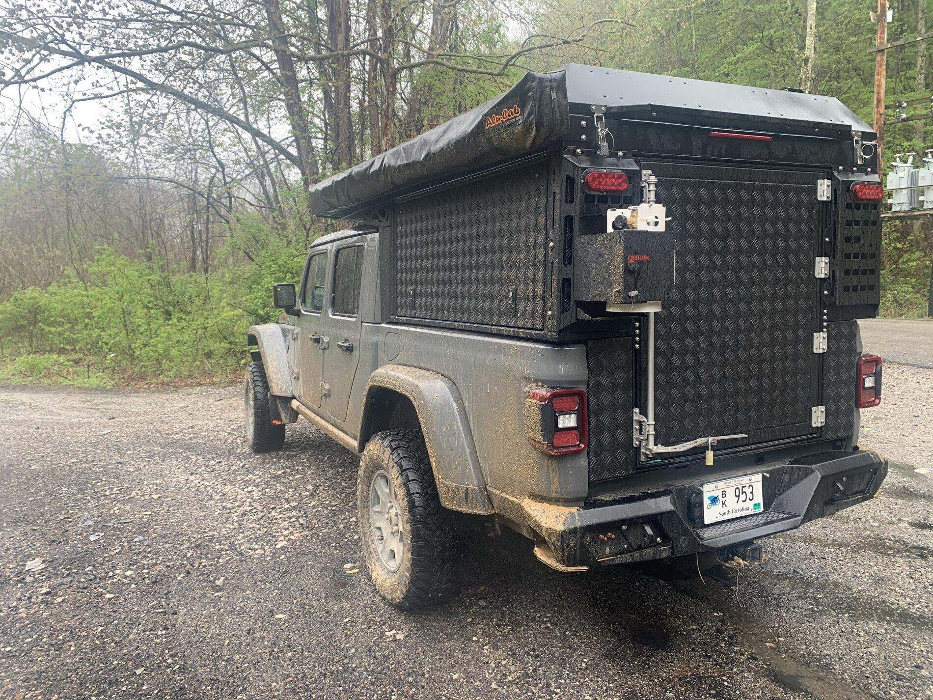

Just finished successfully wiring the brake light on my canopy camper and your photo was the one solid answer after a ridiculously long search. Thank you! Why doesn't Alu-Cab include a simple wiring diagram?

Awesome! Glad I could help. No idea why Alu-Cab doesn't have a wiring diagram. I still haven't hooked up the LED lights that came with my Alu-Cab.....I should probably do that this spring.

@garzilla ......well my Alucab brake light isn't working at all. now I gotta figure out why, shorted wire, broken led strip, blown fuse?
Thank you so much, this is just what I was looking for.

Are all 3 of your brake lights that you wired according to my photo still working?
I've finally got some time tomorrow to figure out what is wrong with mine. Just making sure my fix that worked for you guys is still working.
