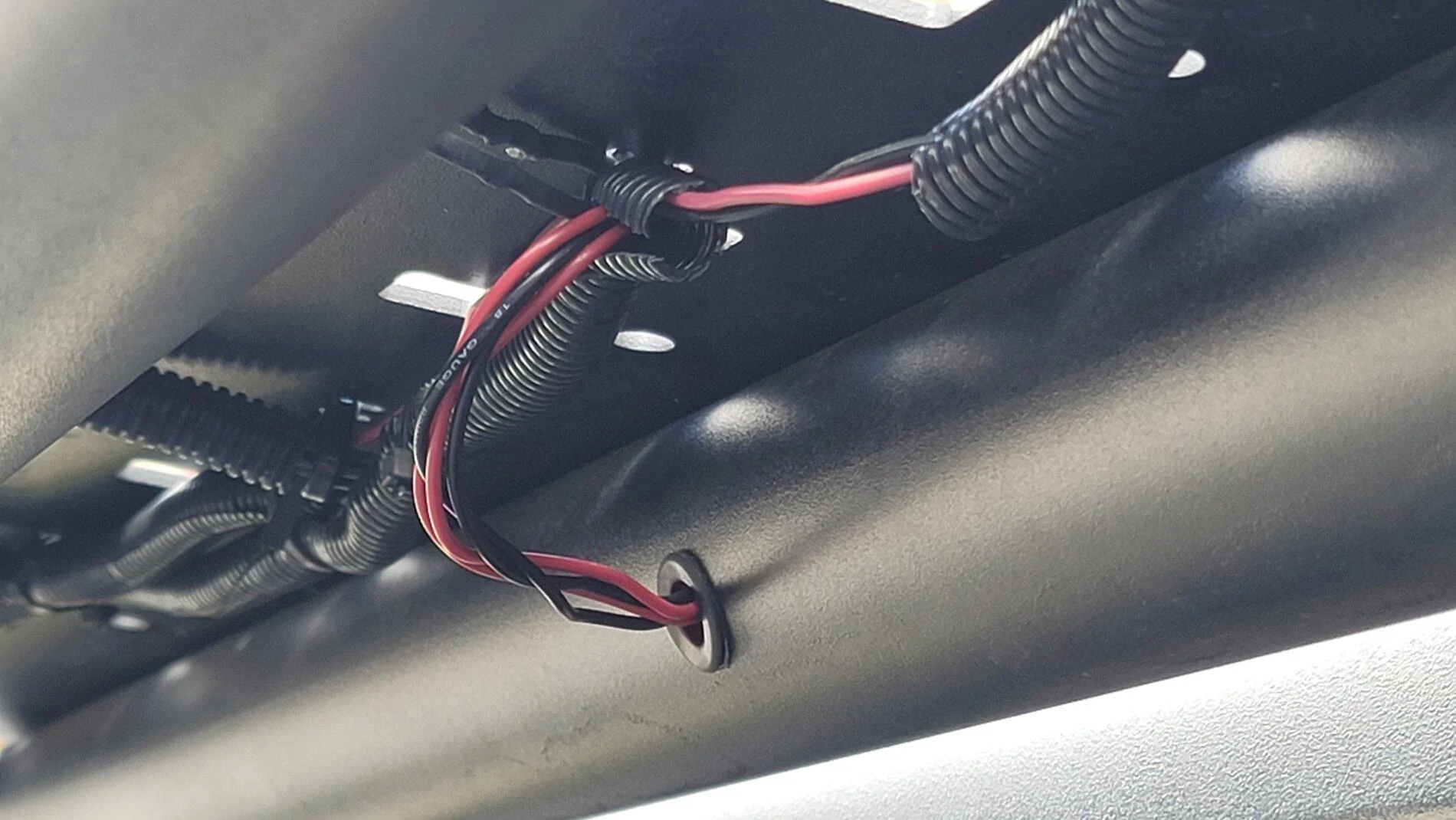

FINALLY GOT MINE WIRED UP!
Tapped the third brake light under the bed for the middle lights and the bed light for the cargo. With the tazer, I can turn the bed lights on for 30 min by pressing unlock 3 times.
Jeep Gladiator What are these 4 wires that go to the tailgate brakelight? 20211019_211102
I got brave and drilled holes into the sport bar to get a clean install. Used rubber grommets to protect the edges. Going to silicone them in and seal the holes too to keep water out.

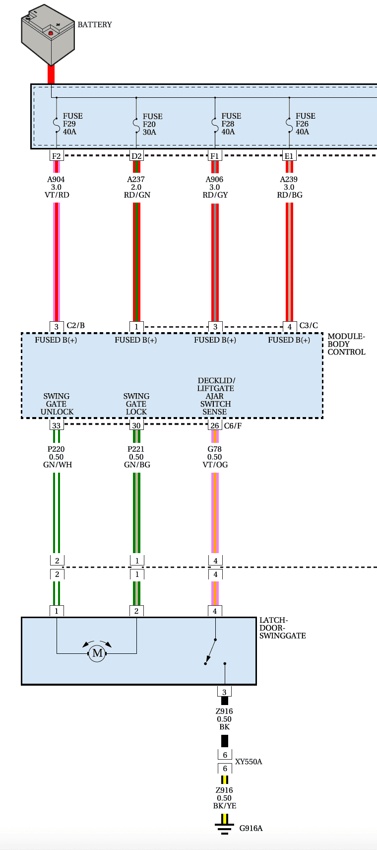

I wanted to touch the locking mechanism of the tailgate for other reasons, from your picture and electrical diagram (please correct me if I'm wrong), but it looks like the two left would be the tailgate lock mechanism. Attaching a diagram for an older JL model as a source for the theory I have, but I'm 99% sure they're wired the same.
i have no idea about the locking mechanism, sorry i'm no help.
